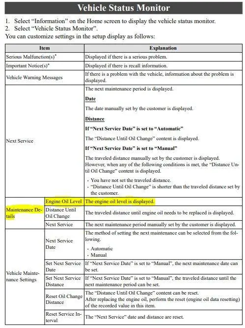

You can also set your own oil change interval to whatever you want in the Infotainment menu. The Mazda Connect Manual details the procedure (page 2-6).
Interestingly enough, the new infotainment apparently has an option that allows you to check the engine oil level without popping the hood.
that would be interesting and nice addon if they finally exposed this in the infotainment.
I wonder how that works, given that we need to check the oil level after shutting off the engine and waiting five minutes.
I wonder if the Infortainment system compensates for engine RPM somehow.
It seems like RPM could influence the reading.
No idea how it works. But if it were a feature on my car, I would treat the reading as an approximation, and rely on the dipstick reading for a more accurate representation.
Maybe the reading in the infotainment somehow accounts for the varying oil level in the pan in different states of operation (at idle, moderate RPM, engine off in ACC mode, etc.).
