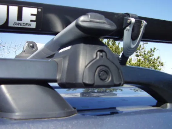

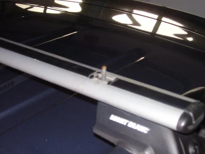

The Mont Blanc rack system is rated at 220lbs. The way it mounts, as you see in the photo, the weight is transfered nearly directly down into the foot of each rail and into the safety cage on each side.

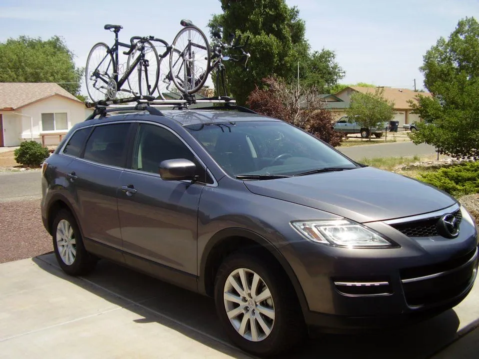

Since we are set up to carry 2 kayaks AND 2 bikes at the same time on the roof, I got up on the rack and put all of my weight in the center of one crossbar at a time. I weigh 200lbs, and they barely dipped, let alone showed any signs of movement at the rails. VERY solid. I wouldn't dare do that with the factory crossbars.

They lock as you can see in my last photo. The lock cylinder is in the center of the wishbone.
If you use the Mont Blancs, you can mount the box with T Bolts in the top channel and have a much cleaner installation than the standard U bolts.

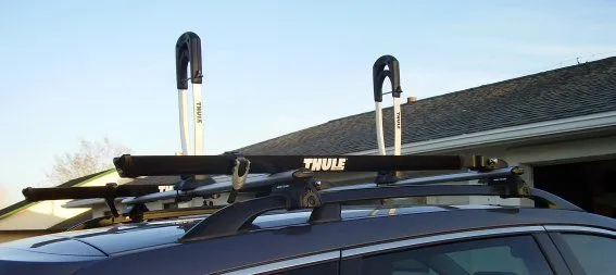

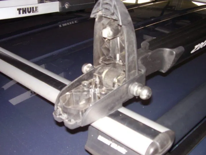

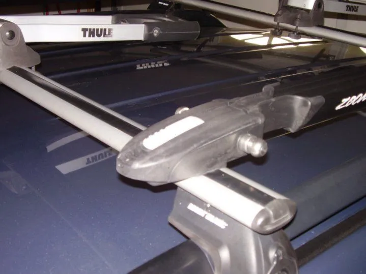

I installed the Mont Blanc Crossbars and they look great. I would like to install my Big Mouth bike carriers but would like any feedback on adapters to use on the crossbars. Anyone have any suggestions?
i used the Xadapt9 for my Pelotons. The Big mouth uses the Xadapt2.

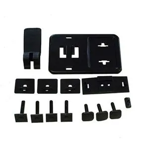

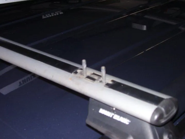

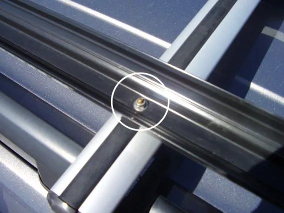

Instead of the cam lock side mount, for the rear I used a single T bolt in the channel through a hole I drilled, and a Nylock nut. Just be sure the tire won't sit on the nut.
Xadapt9.....................Xadapt2............T Bolt

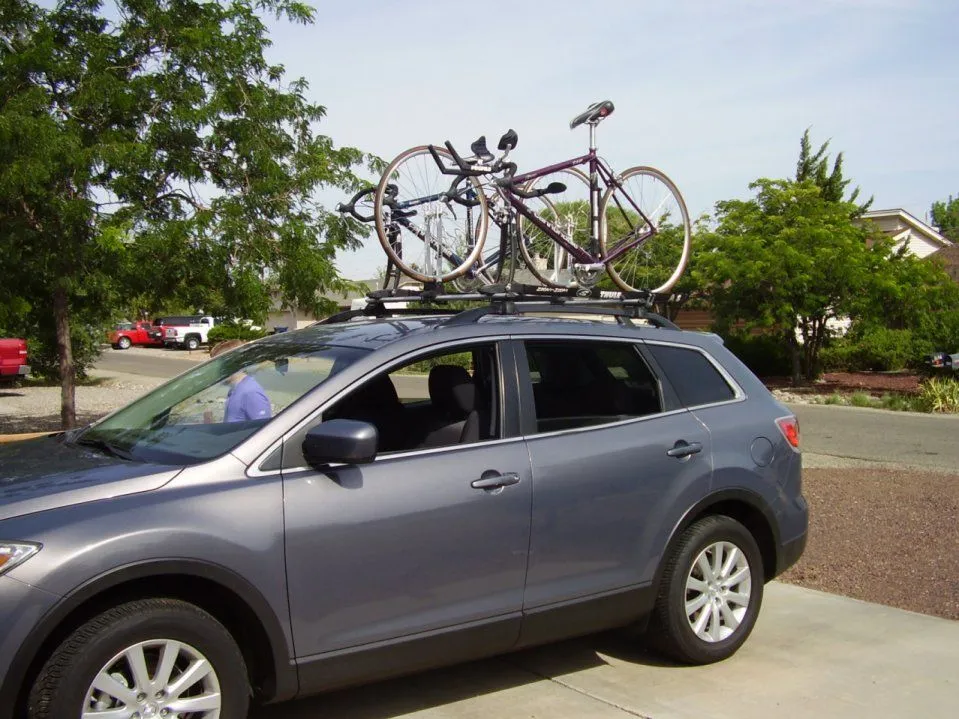

More detail on how I mounted mine. Sorry for the fuzz, but my camera has a lousy focusing system.

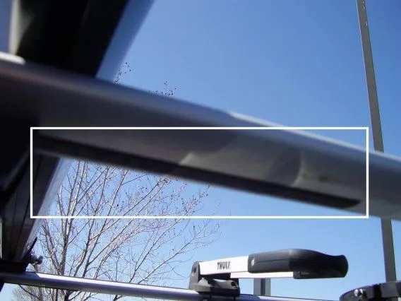

Mine whistled until I put the filler strips in the open slots underneath. Did you install those?
Now all I hear is the attachments, but they don't whistle. Just regular wind noise.
