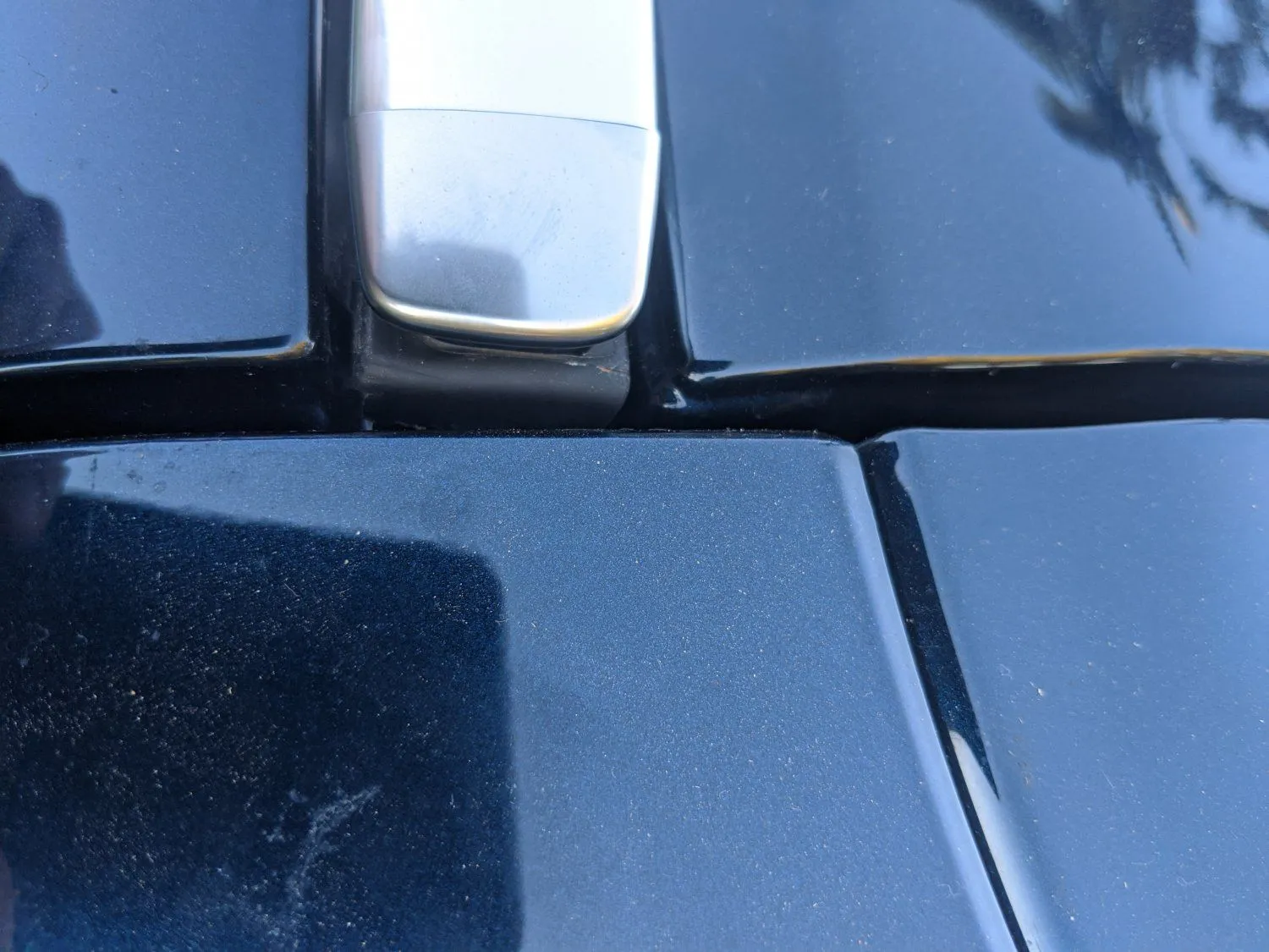

OEM roof rails improperly installed by dealer
I wouldn't worry unless the dealer tech is completely incompetent. They're really easy to install.
Dealer tech? You're joking, right? with 6 bolts on each side you think their lot jockey, um, I mean 'tech', cares if he strips thread a couple. Yes, it's an easy install, but it's also easy to cross thread them
I'm having them installed two days from now at Mazda. Sure hope they do it right.
Make a copy of the picture, show it to them, and tell the dealer you would like it to lay flat. Afterall, it is you CX5 and you are paying them to install.

If anyone cares I finally fixed this myself this evening. Someone mentioned in this thread that the heads use a T-25 torx but they actually require a T-30 torx. I only needed to loosen the back 2 screws to get enough space to slip the rubber back under how it should have been to begin with.
