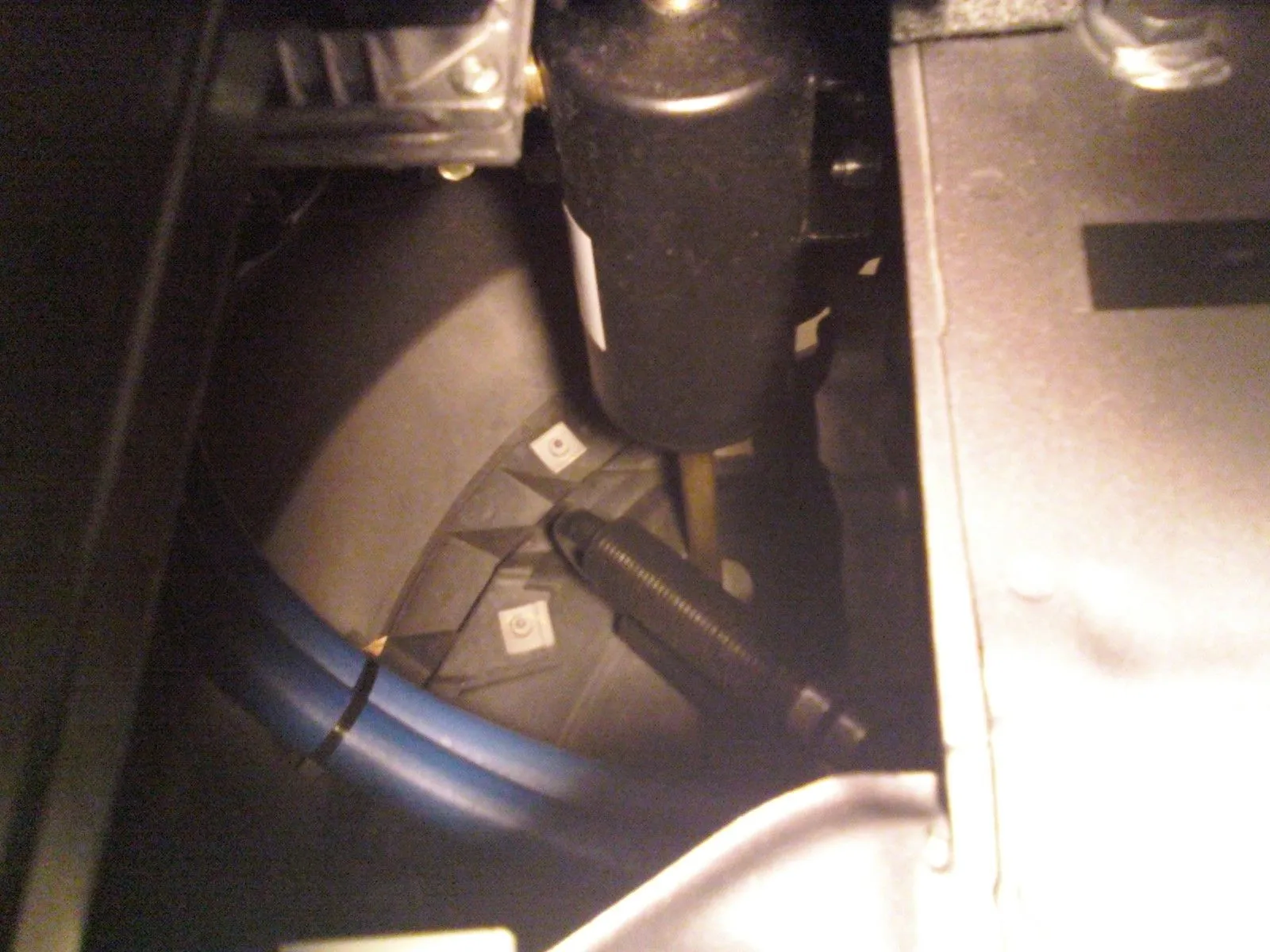

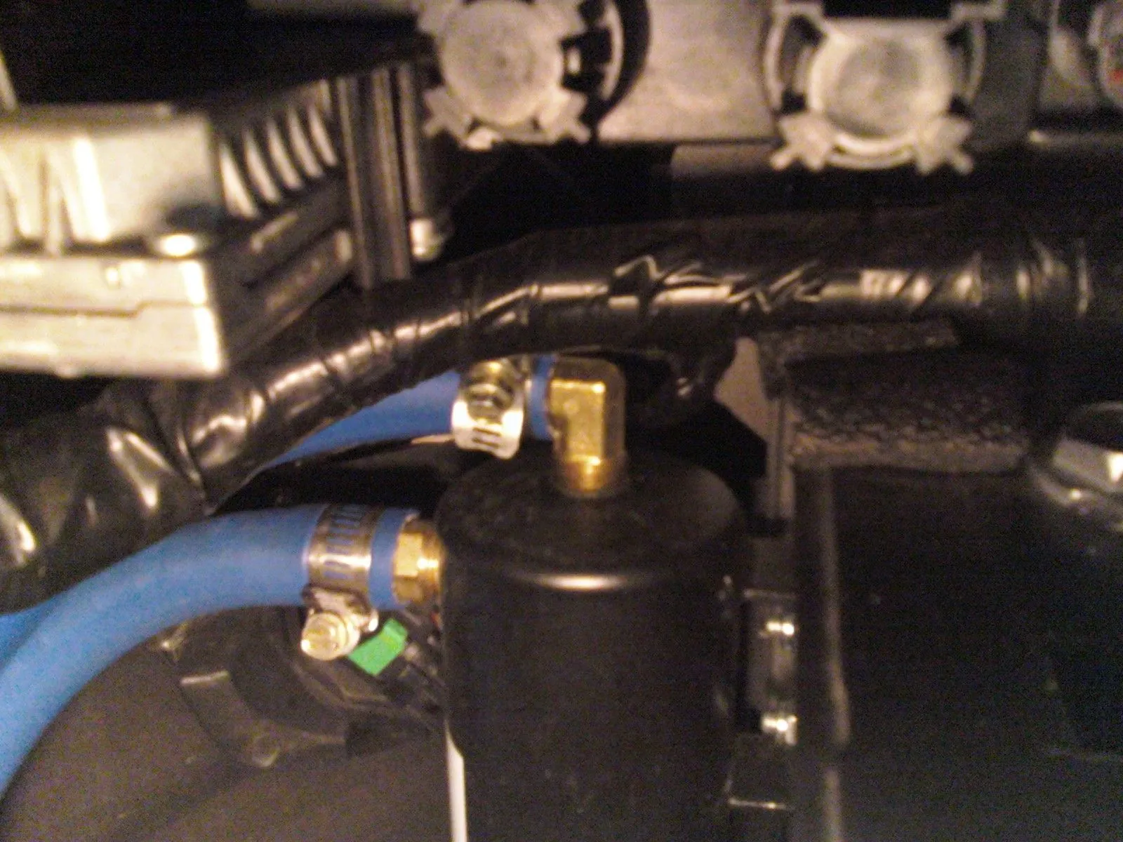

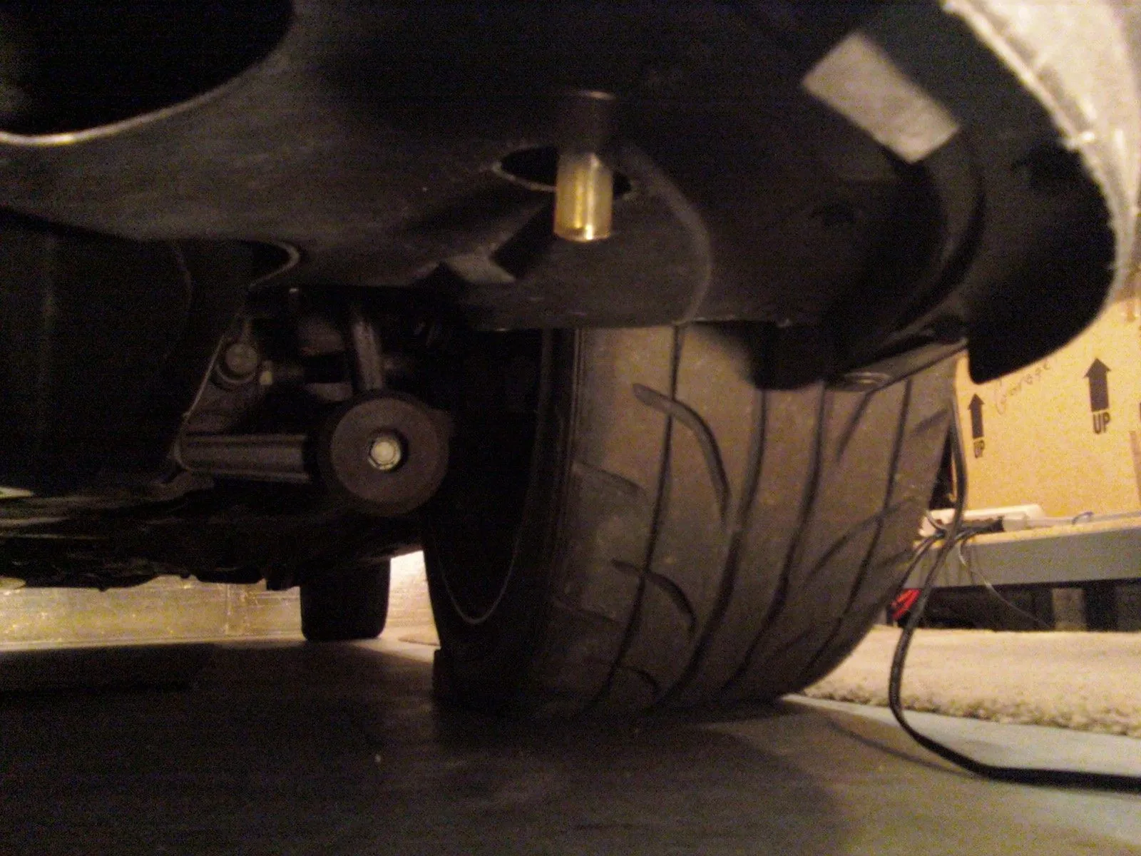

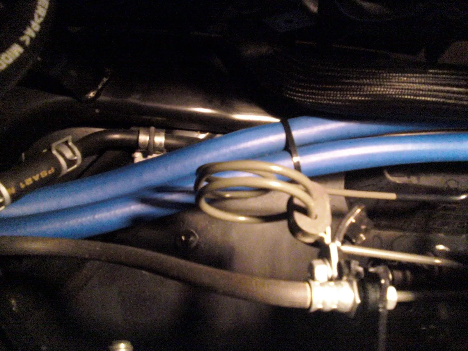

Here's a few shots of mine installed. I used a wire-wound hose support under the IM to make sure the hose doesn't kink from the fairly tight bend radius coming off the IM nipple... You can get them at Advance or NAPA for 5/8" hose.
