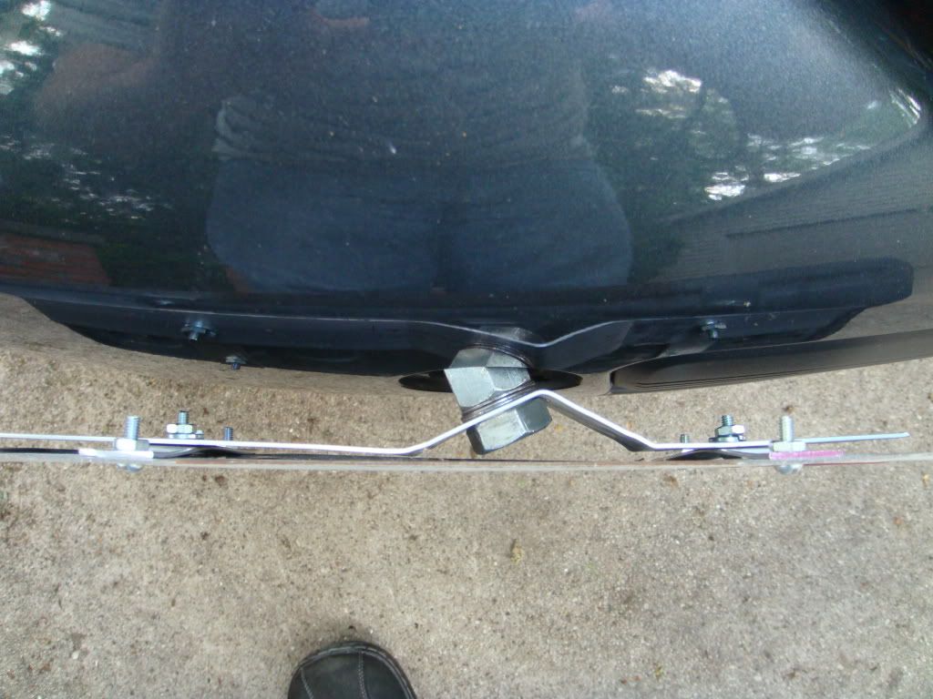

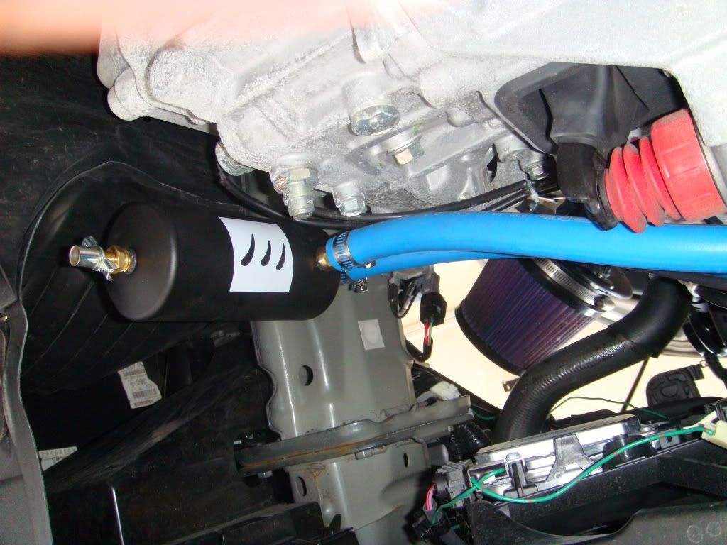

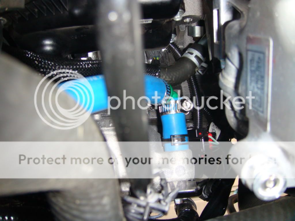

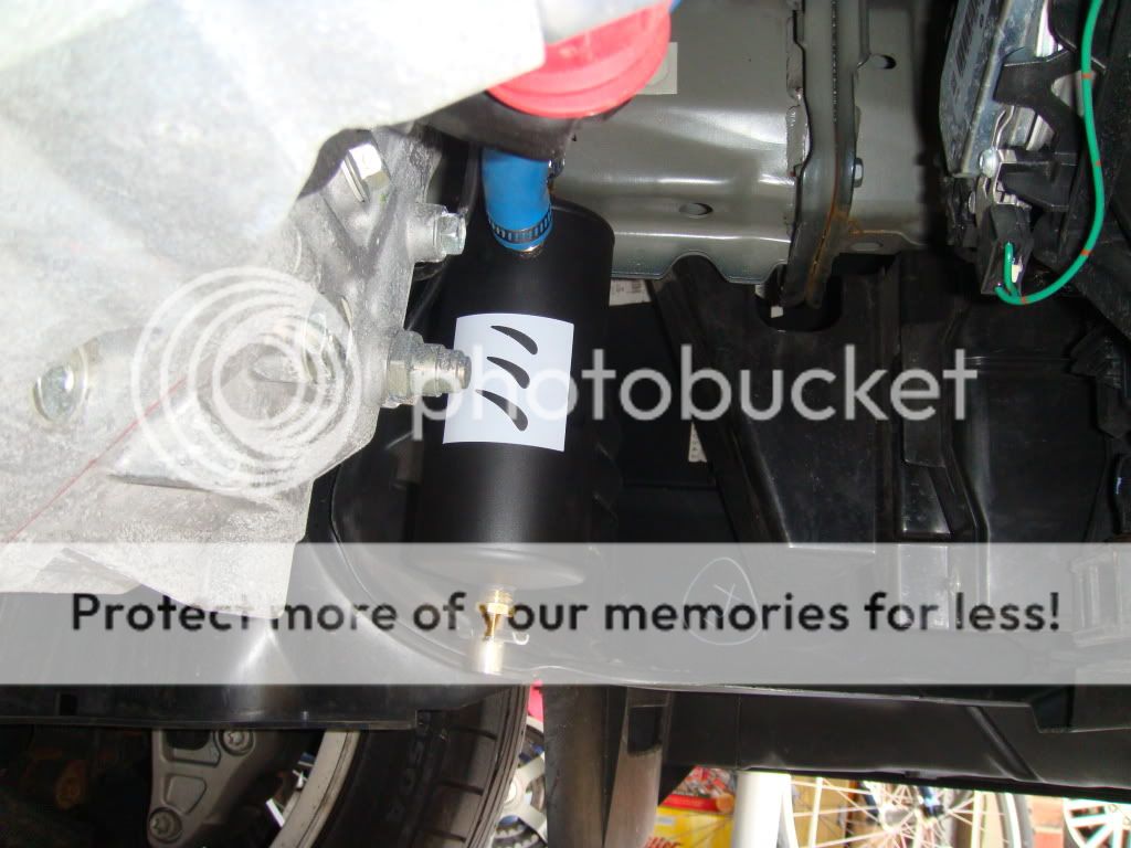

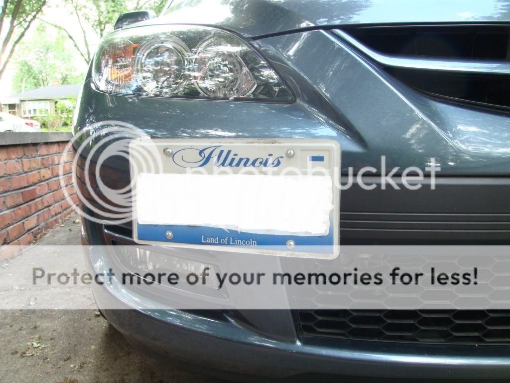

Thought I would share some pics of what I have been up to the last two days with Damond. I'm real happy with both installs. We have a small tube coming off of the drain valve on the OCC and out a hole we made in the splash shield. I can drain the OCC by reaching down next to my intake, so I do not need to get under the car at all when it's time to drain it. Matt got a little carried away with the license plate mount compared to what I had planned but it turned out good. Only cost me about 15 bucks for all the license plate hardware.
OCC
License Plate
looks pretty good man! how long did the install for the occ take?
Much longer then it should have because we were kinda messing around the whole time and took a trip to the store. Actual work time was probably about 3 hours maybe a little more. Most of the time was spent measuring and we tested 2 different locations.
It looks good! And you can put the OCC over there if you have a SRI, There's not much room if you have CAI.
We tested the other side as well to get measurements. For me this seemed like a better fit but we have measurements and a how to for the other side also if a CAI is present.
Now that you have the license plate holder out of the way, it looks like you're set to fill that void in the bumper with a big ol' FMIC.
