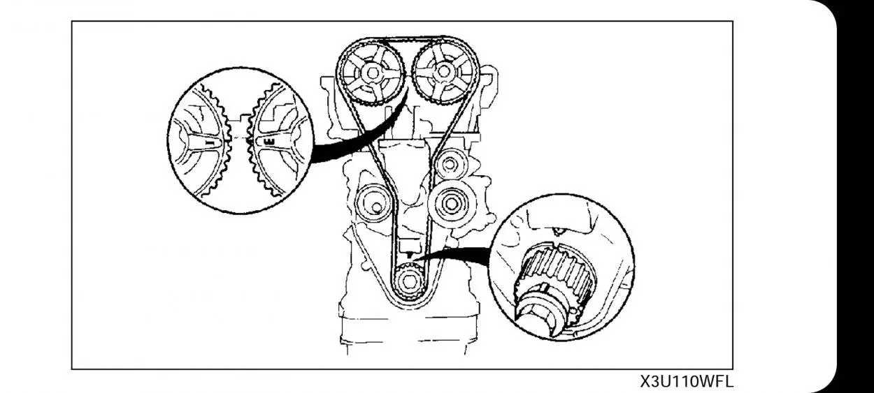

I'd guess that checking your timing is a good idea, (although it's a lot of work). Check the timing marks on the plastic cover and make sure they are in alignment with the notch on the crankshaft gear.

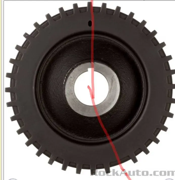

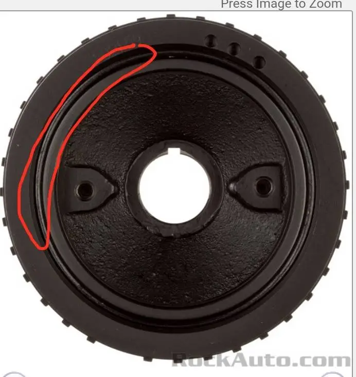

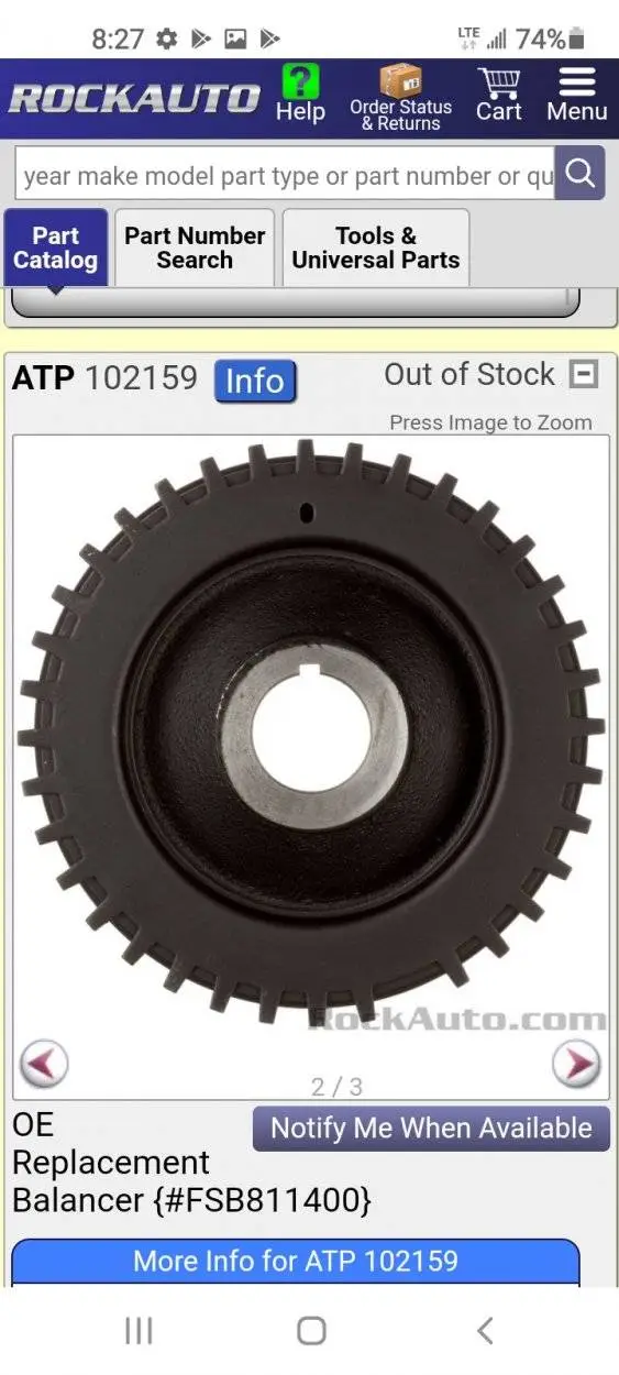

Your harmonic balancer may have slipped. The toothed ring is rubber mounted to the crank pulley and they have been known to separate and slip. Then your car won't run.
The part that I tried to circle is rubber. It can slip and throw off the allingment of the toothed ring. I'm not sure what affect that would have on the spark.
It may be out of time, or it may get shut down?

Check the orientation of the missing tooth, relative to the keyway notch.
And check the regular timing as well...
I think it’s probably a tooth or two out of time somehow, even though the marks were in line and the belt slipped right on, then was still in line with the timing marks after the tensioner got tightened. I’ll figure it out after I dig the car out, some of the ceiling in the garage came down on it and there’s a mower and Camry in the way still lol I really thought this would’ve been a quick project, but here we are, 7 months later and still not a step farther lol.
