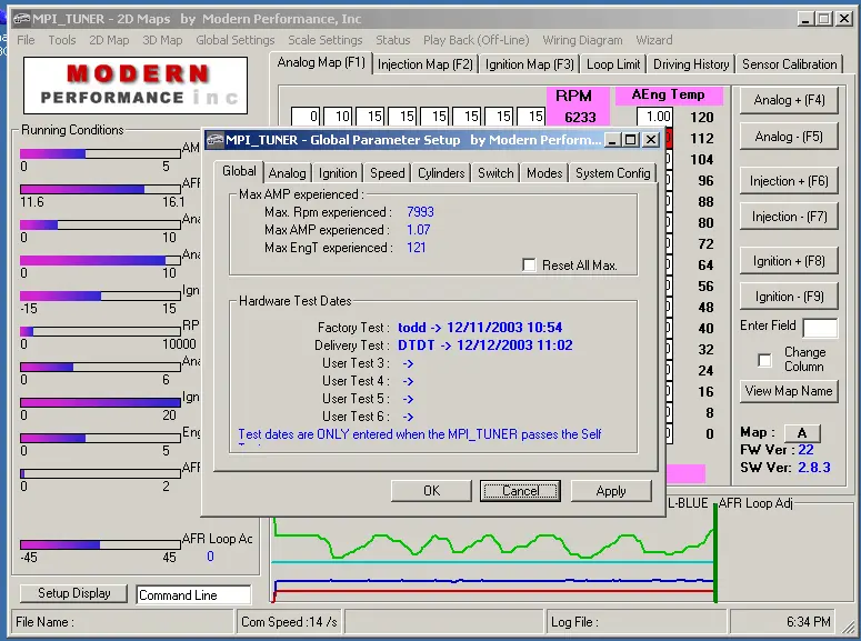

I igdrasil : 12psi Protege5 Oct 4, 2004 #63 ITS THE EXTRA INJECTORS... I tried what you did....today and the rpm gauge went thru 8000rpms check the picture...max rpm experienced. Attachments 8krpms.webp 47.2 KB · Views: 74
B Bigg Tim Member : MazdaSpeed 6 Oct 4, 2004 #64 So the rev limiter is fuel based like Nick said then.
K Kooldino MOTM Winner Jan '09 Authorized Vendor Contributor : MP3 Oct 5, 2004 #65 Great. Ok, so short of redefining my rev range, how do I limit my revs?
