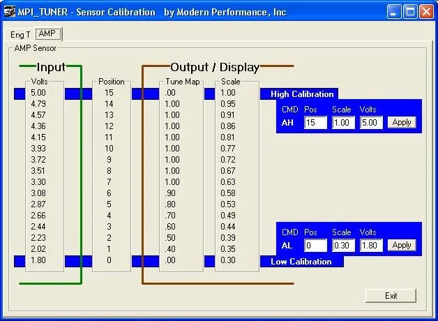

Ok, I figured out my random studdering problem. After driving around for awhile with my laptop plugged in and running, it finally did the studdering thing again after a week or not doing it.
Here's an email I sent to Perfect Power describing what happened:
I'm having an issue with either my MPI tuner or my MAP sensor (which I
believe is from Perfect Power). I am running 15psi on my car right now,
on what I believe is a 1.5 bar MAP sensor. Attached is an image of my
Sensor Calibration for the AMP scale, which is using my MAP sensor as an
input. I never exceed the box labeled ".77" with the amount of boost I
run. Obviously the amount of boost I run directly affects the duty cycle of
the additional stand alone injectors that ONLY the MPI Tuner version of the
SMT-6 knows about.
99.9% of the time, I have no issues, and the AMP scale works as it should.
It stays in the bottom most cell (1.80 Volts, Position 0, Tune Map = .00,
Scale = .30) anytime I'm off of boost, and the moment I cross the boost
threshold, it steadily climbs all to way to Position 10 (3.93 volts, .77
scale) which is 14-15psi on my car.
However, on occasion while crusing OFF OF BOOST (ie, in position 0, 1.80
Volts) and a very low RPM and throttle position, it will start spraying fuel
through the injectors due to the fact that the red indicator on the AMP
column is now suddenly in position 15 (5.00 volts), which, until I set it to
"0.00" tonight, was at "1.00". And it would stick there for about a minute
until it would go back to a proper AMP column cell. Since changing its
value from 1.00 to 0.00, it has corrected the problem during cruising, but
now, on occasion, under boost it will also "stick" there for some reason and
add no fuel at all under boost.
So in short, I'm not sure whether I have a faulty MAP sensor, or whether
there is a software glitch. Either way, I wanted to bring this to your
attention.
