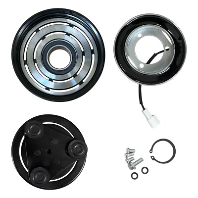

My air conditioning stopped working last summer and now that it's getting warmer, I'm trying to fix it on the cheap.
Here's where I'm at
From my research, I've found the following threads which seem related.
Replacing A/C Compressor, please double check my process - maybe a little past what I'm looking to do right now, but helpful
I've also found that eBay has non-OEM clutch kits for around $100. I would tend to not trust these but curious if anyone has thoughts?
Anybody have experience with this?
Here's where I'm at
- The compressor seems to not be kicking on even with the AC light on.
- I have the Harnessed Performance AC light flicker harness so this is not *that* issue
- I have not checked the refrigerant level but I suspect the problem is not a leak. The AC worked great, I parked the car for a weekend, came back to no AC.
- I used to hear a click from the compressor when AC was engaged (assume this was the clutch kicking in). I no longer hear this click.
RYC New AC Compressor Clutch FH479-CL Fits Mazda Protege 2.0L 2001 2002 2003 | eBay
Premium Quality Best Offers Fast and Free Shipping Discounted Prices! ABOUT R & Y A/C COMPRESSORS Since 1989, R & Y A/C Compressors has been providing quality automotive air conditioning parts and services. We are family owned and operated. We specialize in automotive air conditioning and...
www.ebay.com
