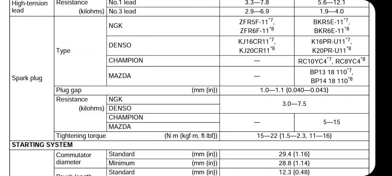

P pcb The Diagram Dude : 2002 MP5 Mar 28, 2021 #3 Here's what the service manual says... 11-16 foot pounds. Different plugs may have different squash washers but they should all be close to what theblooms said. The instructions will be on the package too. Upvote 0
