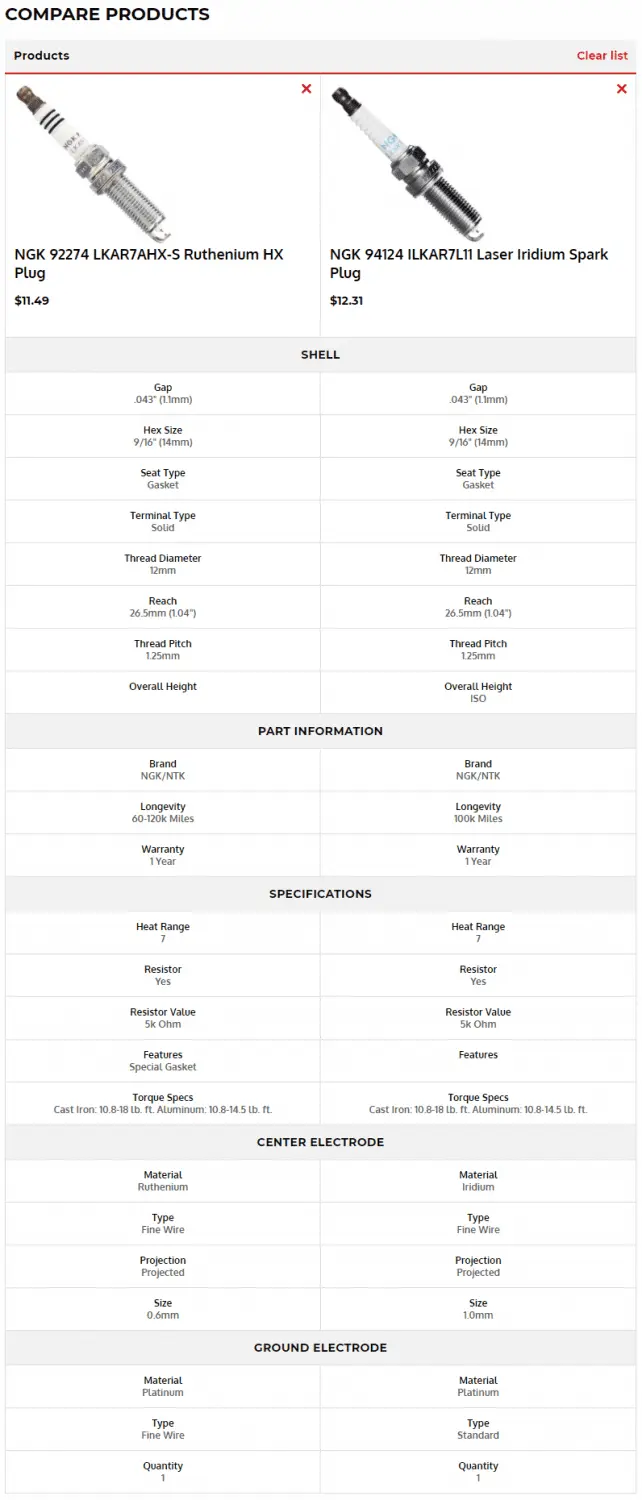

I was wondering if anyone has tried out the Ruthenium plugs on Rock Auto? It's supposedly better than iridium and platinum. If anyone has them installed, would you mind comparing them to OEM?
https://www.rockauto.com/en/moreinfo.php?pk=9779940&cc=3312788&jsn=1290&jsn=1290&jsn=1290
Ruthenium HX
NGK Spark Plugs is introducing the latest technology in high ignitability spark plugs to the automotive aftermarket: NGK Ruthenium HX. Today's efficient engine designs create more power while using less fuel and this has shortened the life of traditional Iridium and Platinum spark plugs. In response, NGK's patented Ruthenium technology is used for maximum durability and performance in newer engines where efficiency is demanded.
Features & Benefits:
  • DFE (double fine electrode) and PSPE (projected square platinum electrode) tip designs. DFE maximizes ignitability while reducing emissions for low heat engines, and PSPE provides the best ignitability and service life for high heat (typically turbo and supercharged) engines.
  • Superior oxidation resistance and enhanced blistering/anti-peeling to provide the most optimal durability at high temperatures in various driving conditions.
  • Advanced high-ignitability technology that provides more complete fuel burn than other precious metal spark plugs, resulting in quicker throttle response, smoother idle, and better cold starts.

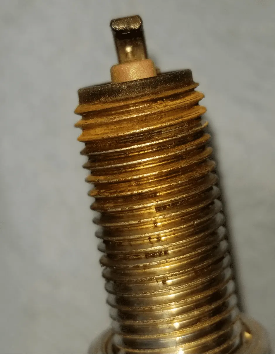

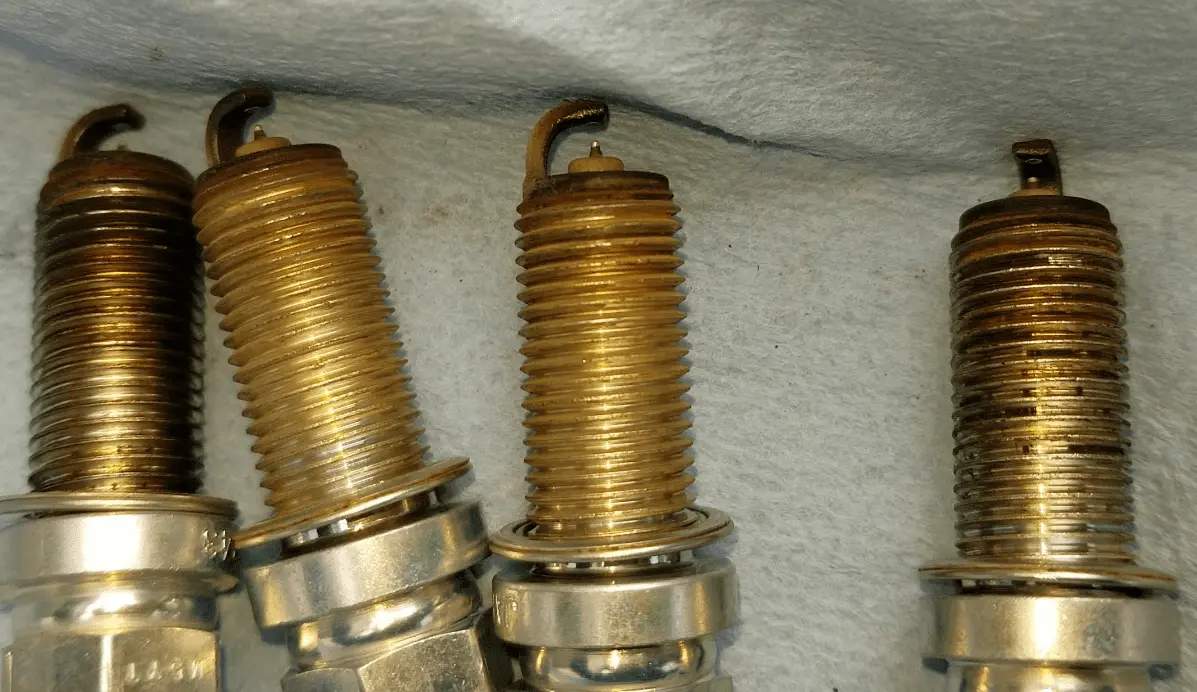

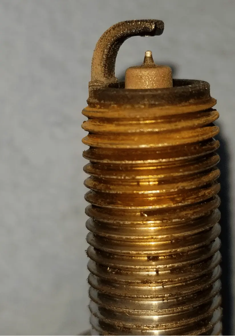

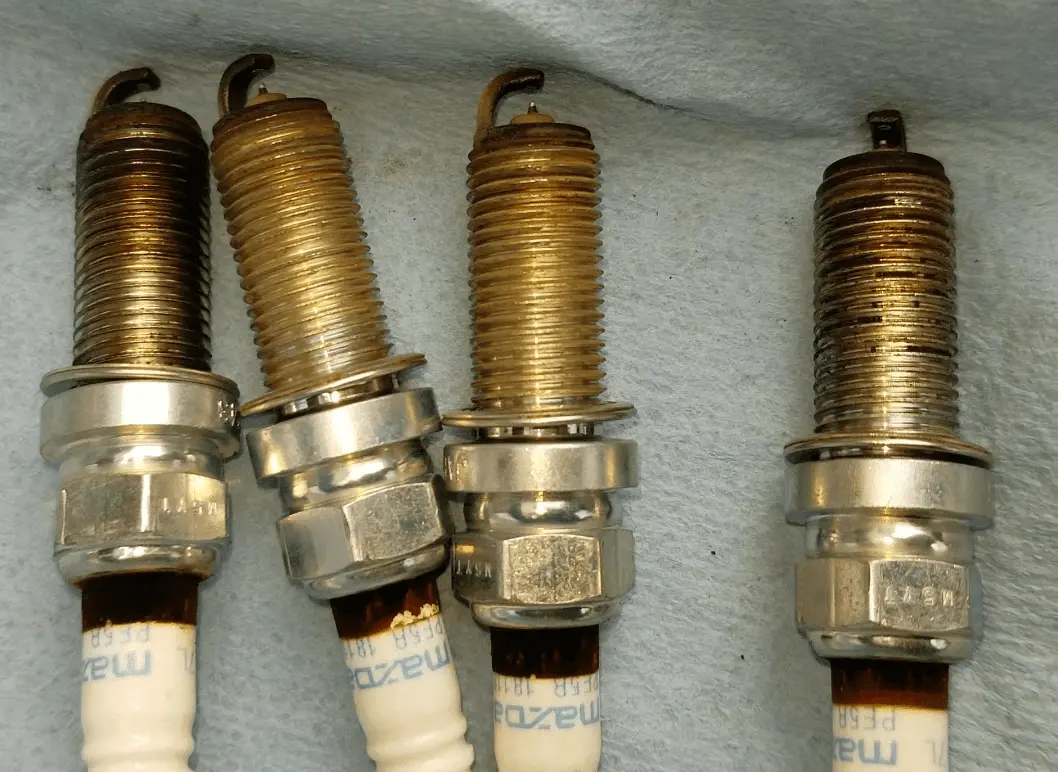

Update (11/28):

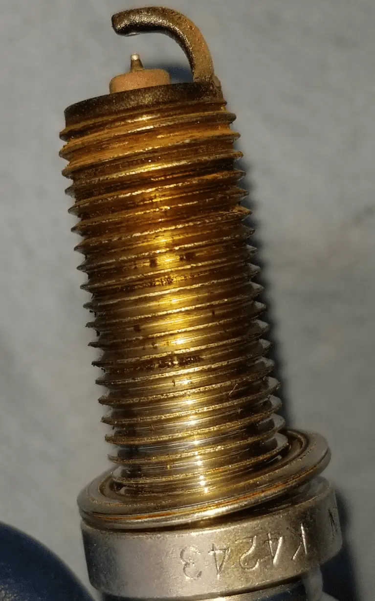

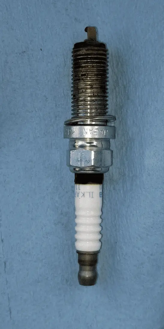

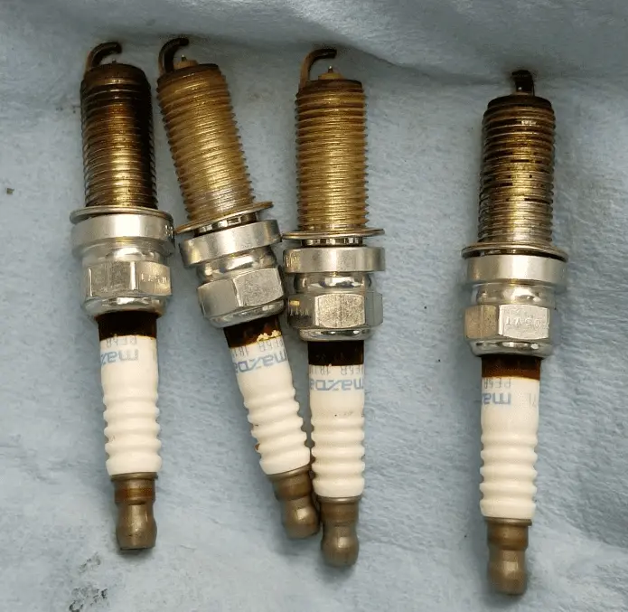

So I've decided to install new spark plugs before the recommended 75k interval that Mazda advised since I would like to see how my spark plugs are currently doing and also to test out a new type of plug. The below are some instructions, tools, specifications that I've used in addition to the attachments so I hope this helps anyone that is willing to perform this in the future.

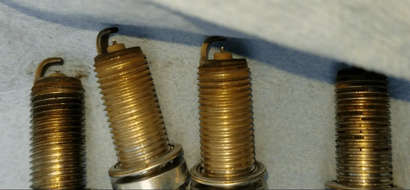

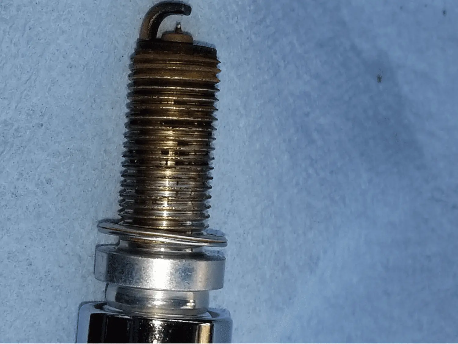

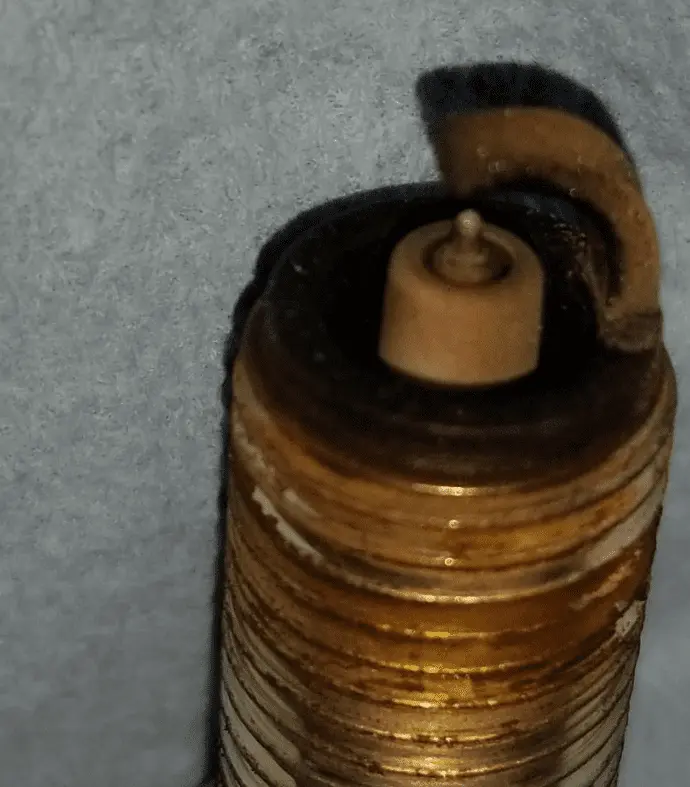

Observation:
  • After changing the (4) plugs and driving 5-10 miles, I noticed a significant improvement in acceleration and the throttle.
  • The engine roar definitely seems to be more pronounced than before.
  • Bank 3 and 4 plugs were more difficult to remove but 4 definitely required more torque for sure.
  • No comment on fuel economy/cold start yet but I did not notice a significant improvement for the initial engine start time.

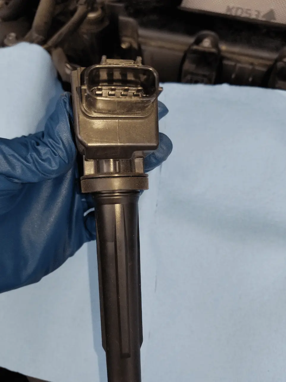

  • The connector on the coil on plug boot is very easy to disconnect. Just simply press down on the latch and slowly wiggle it left/right and pull backwards to disconnect.

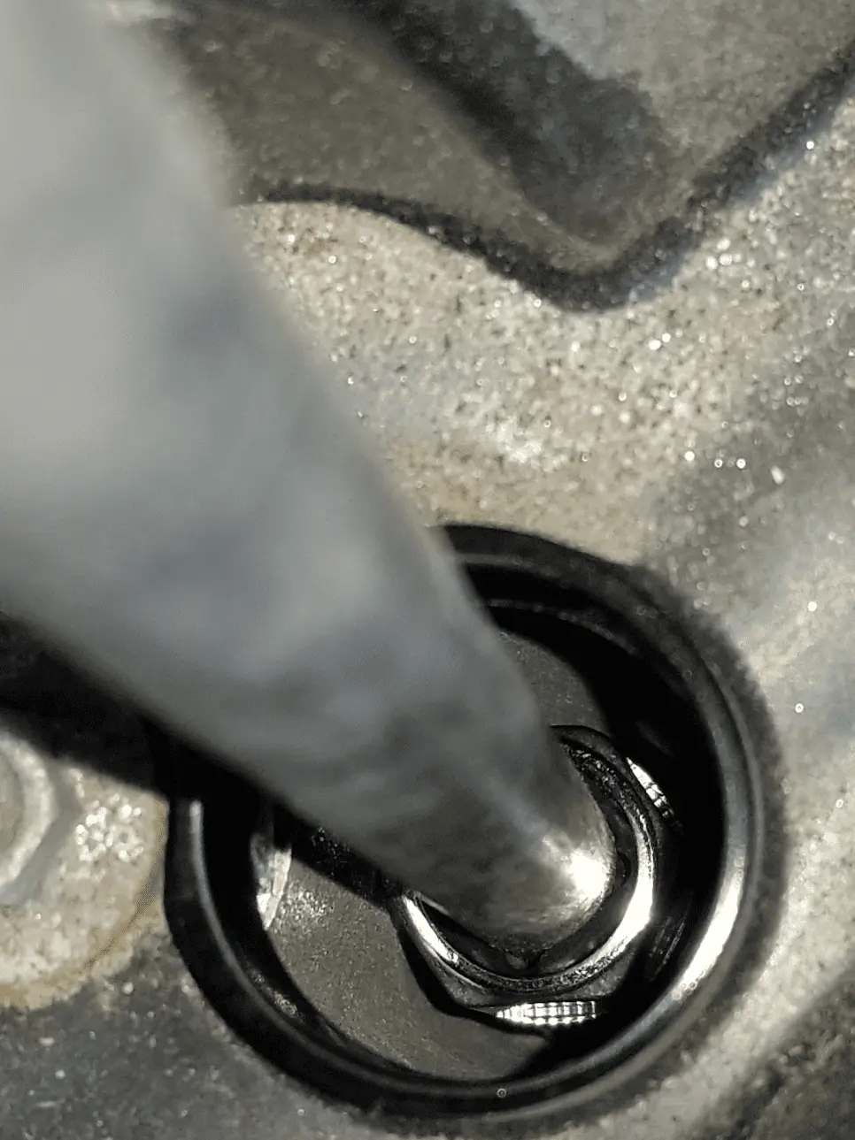

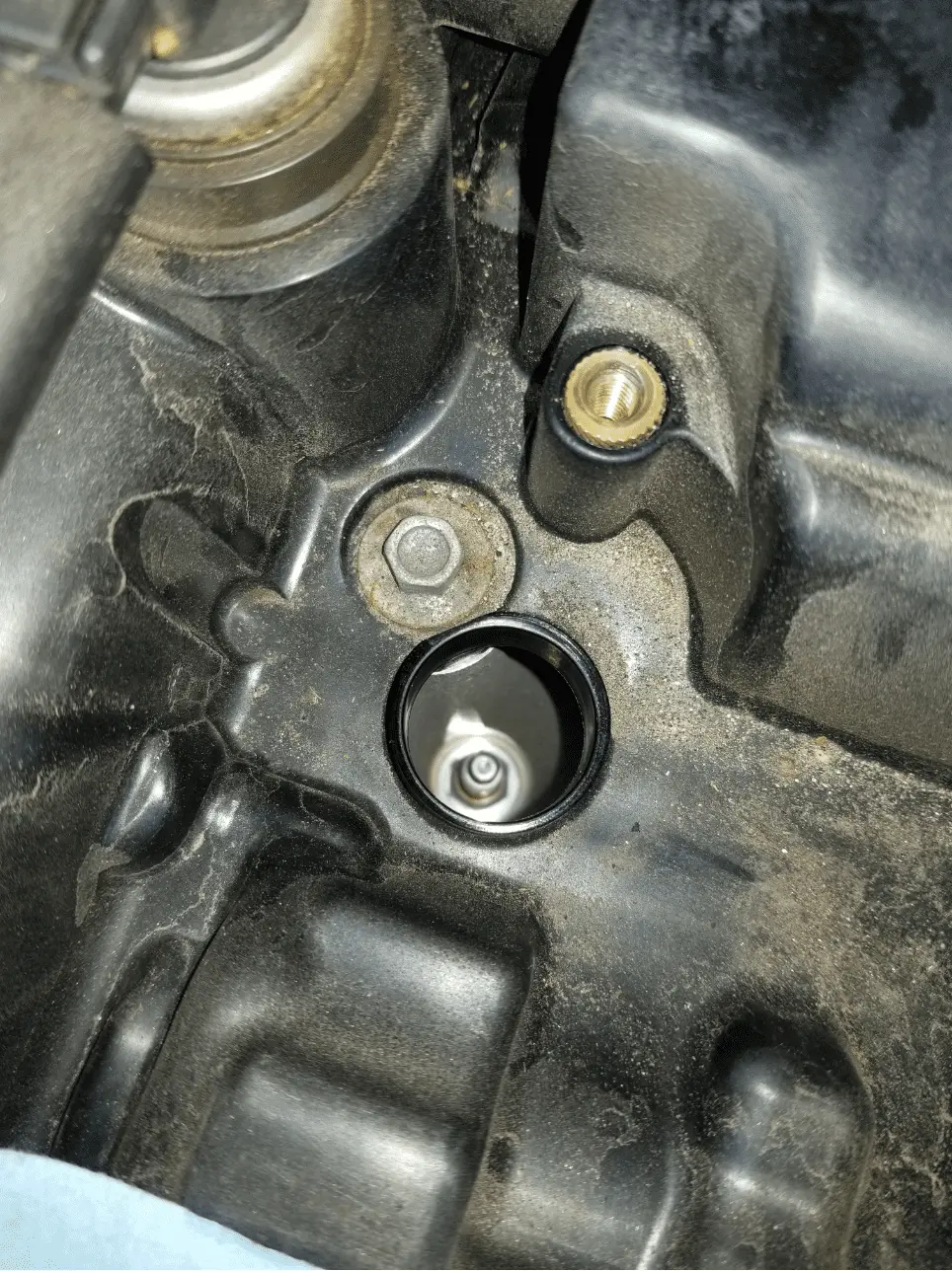

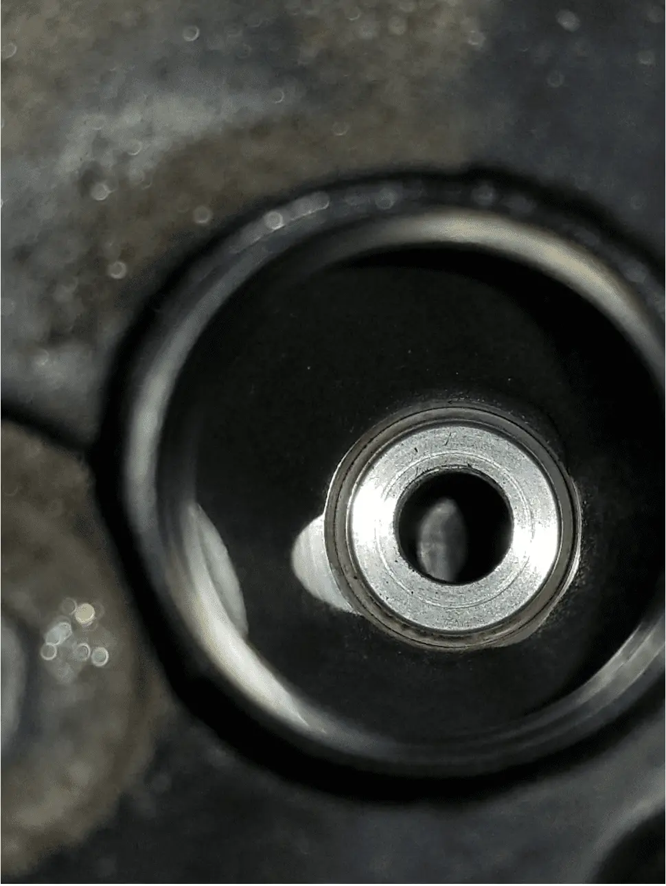

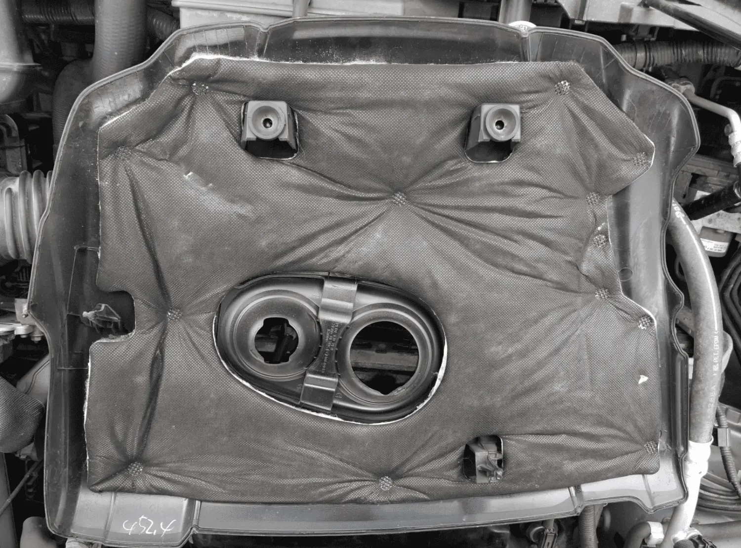

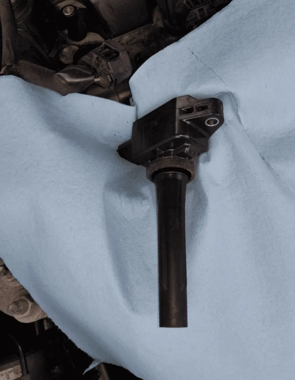

G. Steps (In Order): Please perform this only on a cool engine as you will burn yourself. If you're uncertain, let the car sit for at least a few hours or overnight.
  1. Disconnect negative battery terminal (negative (-) symbol/black color) using 10 mm socket.
  2. Remove the engine cover by pulling upwards so the (4) grommets will release.
  3. Clean off any debris
  4. Remove (4) 8 mm bolts holding the ignition coils in place
  5. Gently pry the ignition coils upwards in a back and forth rocking motion and put the ignition coils aside in chronological order as they were removed.
  6. Use a 3/8 mm breaker bar with the 9/16 (14 mm) socket to break loose the (4) spark plugs.
  7. Use a 3/8 mm ratchet to remove the (4) spark plugs.
  8. Install the new spark plugs and torque the spark plugs to spec (see D).
  9. Lubricate the inside of the coil on plug boot/spark plug porcelain with dielectric grease
  10. Install the ignition coils back and install the bolts back torque to spec (See D).
  11. Before putting the engine cover back on, connect the negative battery terminal back on and turn the car on to see if there's any issues.
Pictures Below:

Nice writeup Dig. I do detect one flaw in your conclusion about the performance of your new plugs: you disconnected the battery! Perhaps I'm wrong and you used a tender to maintain power in the vehicle, but if you didn't then the vehicle has reverted to "learning mode" and hence a direct comparison of performance before and after the plug exchange cannot be made. Did you maintain power in the vehicle?
Thanks! You make a valid point about that. I didn't think too much about the learning process and I did not have any backup power sources. The battery was disconnected because I was afraid of shorting something during the replacement process.

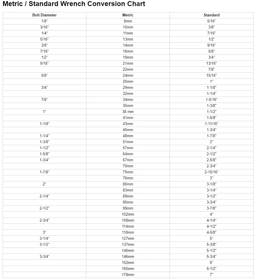

Those NGK or Denso spark plugs are metric size. Officially we should use 14 mm thin-wall spark plug socket for them. 9/16” is 14.2875 mm and the 9/16” socket is a bit larger than 14 mm socket. In addition, the torque value is very low for spark plugs nowadays, 12 point socket won’t do any more harm than a 6-point socket although all of my spark plug sockets are 6-point. Finally, swivel function on spark plug socket is almost never needed on 4-cylinder engines.
I understand that they're metric sized but I just happen to like 6-point sockets so I purchased the 9/16 one instead :D. When I say they fit like a glove though, I mean it as there is absolutely no play/wiggle when I tested it indoors. Both a 9/16 and a 14 mm would work either way and yes, if you want to be exact, it's 14 mm.
I mentioned the swivel socket since the 9/16 one that I purchased ran out. I mean you guys are free to purchase whatever works for you, I'm just providing some examples hehe

I bought a set of Ruthenium plugs for my NC1 based on the durability claims, but haven't installed them, yet. Still waiting on other parts.
Mazda would not be the first and might be the last to use spark plugs as a combustion chamber sensor. Since coil on plug systems came into use that has been possible. Why else would the coil have 4 connectors when it need a 2 to fire? For that reason, I'd be a little slow to change types.
Since Digs' OEM plug electrodes are rounded, it is not surprising new plugs felt better. They should be sparking more reliably/consistently.
