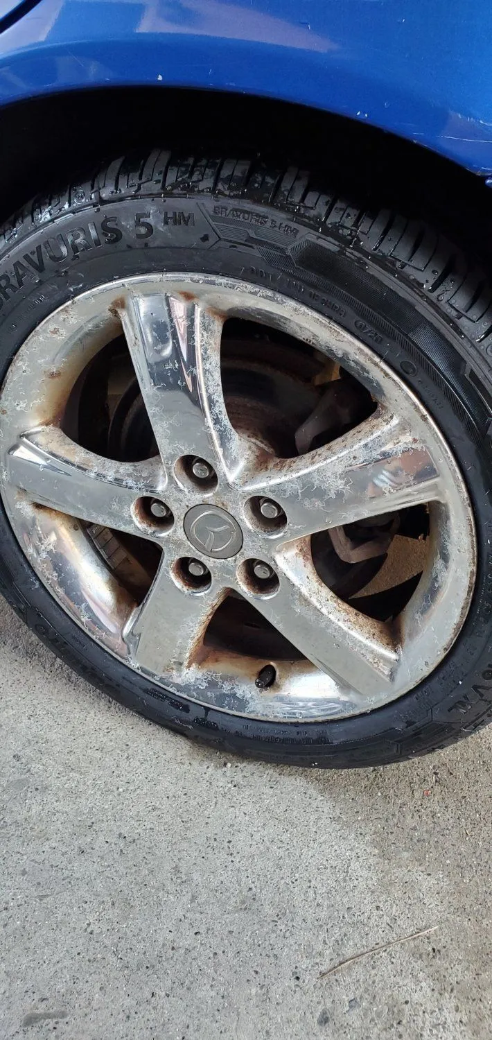

Lastly- I'm curious to see what can be done to repair/refresh these rims. Not sure if that's possible but wanted to check in with you guys. All 4 wheels are like this.
Thank you for your help everyone!

New tires are always a great thing :)
Dealerships can be hit or miss, AT and MT oils are very different beasts so I wouldn't use the AT fluid unless you get 100% confirmation it'll work
ChrisFix has a great video about repairing and repainting wheels!
