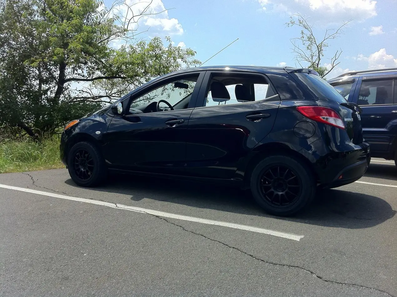

New wheels: Team Dynamics Pro Race 1.2 w/Yokohama Advan AD08 205-50-15
Joker2
2011 Mazda 2 Sport 5 MT
Here we go.
Ask away!
Thanks Brian from Goodwin Racing and the Tire Rack Team as well as my Secret E-Bay seller for the TPMS sensors, they worked out great.
you car is lowered right? I ask because I have a black 2 and I have the same wheels with my RE-11's on them and it looks really 4X4 ish. I would post the pics, but I can't get to facebook in China to get the link.
Looks good though. What offset are they? I bought mine 3 years ago and I can't remember the offset.
Wait found the picture from my intro thread.
Funny how we have the same wheels on the same color.

I am guessing that it was the angle that the picture was taken which is why your car doesn't look as tall as my car.
First I was not interested in rubbing any fender liners or fenders. I also wanted to properly rotate the tires. Standard offset is 45, and mine is now 40 which means the wheel extends 5 mm out more than the stock ones and about 20 mm inboard and you can see that the tire is closer to the strut-body up-front. I talked to Brian at Goodwin Racing http://www.good-win-racing.com/ and he recommended that I stay away from 30 mm offset unless I want to roll my fenders. You may get that to work with 195-50-15 but the 205s are just a bit wider and we are working with small clearances here.
