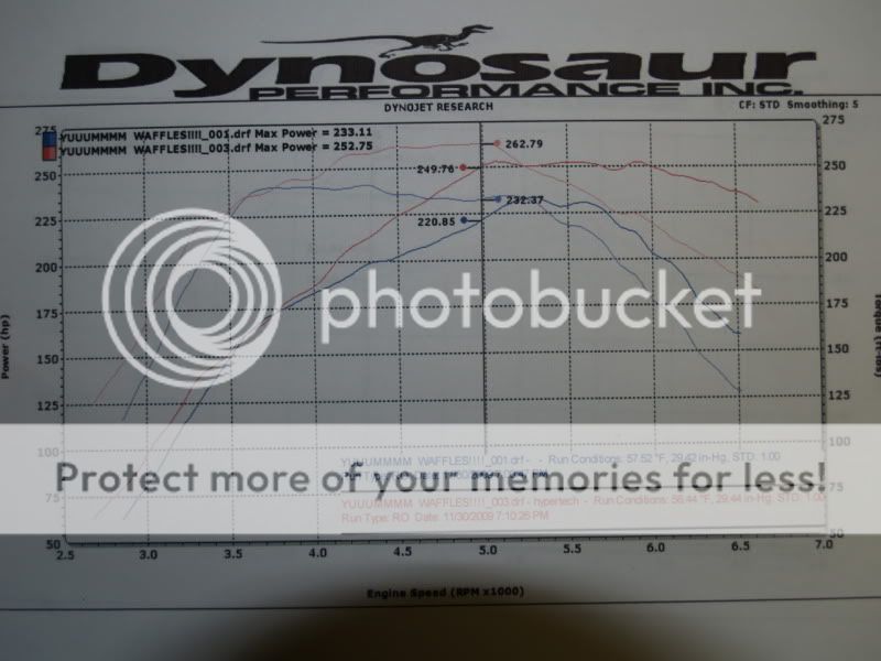

I received an email awhile ago to beta-test this but I didn't call. Today I received an email saying that it's now shipping, and it clams "+68 HP and +38 TQ." I'd love to see the dyno...but I don't think I would believe it.
Called Hypertech for a bit of info and got a "this is proprietary info" before I could get a word out! Shawn then loosened up a bit and said he would past my request along to the "Chief Engineer" after Shawn stated they didn't usually change the max boost levels to which I stated that their dynograph sure showed a pretty good jump in HP for not touching the boost. That was 3 hours ago and have not heard back from Hypertech.

I beta tested it for them.
their whp/tq ratings were done at 6500 rpms. But, it does fix alot of issues the speed3/6 have. Gets rid of the 0-60 mph throttle restrictions, Boost cut goes up, boost goes up to 17-19 psi, you can raise your rev limit, you can raise your top speed. Also you can read and clear your DTC's. My AFR's are now about 10.5 ish and it screams in the lower gears. Totally worth the money IMO.
