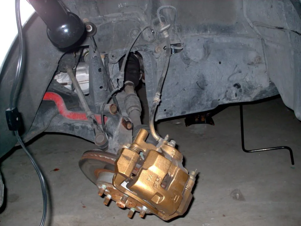

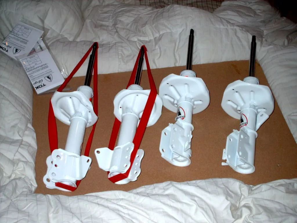

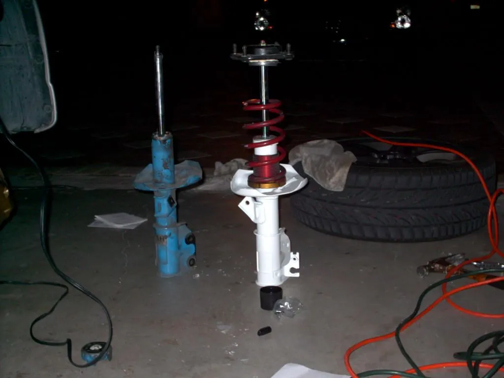

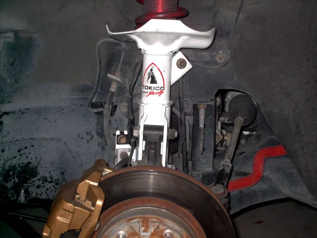

pics...
customary kung fu battle before installation
old strut / new strut
no strut
installed strut!

Looks good...but it hurts me to see those beautiful struts with the coilovers on them set to the lowest drop. You'll basically have no suspension travel once the car is off of the jack stands, and the struts will not last too long from bottoming out all the time. Did you re-install the stock bump-stops?

yeah i'm actually contimplating raising them back up... it's just that all the people i hang with are honda boys... and man the car looks SOO good with the drop... by the way the fronts are down all the way, the rears are about 1.5 inches up, which actially only = a 2.5 inch drop and with such hard spring rates i haven't even come close to bottoming out... the car hugs sooo well... but alas i believe they will be raised up soon. maybe even tomorrow. any suggestions on optimal drop point for low center of grav plus sus. travel? i love my slammed MSP :-(
