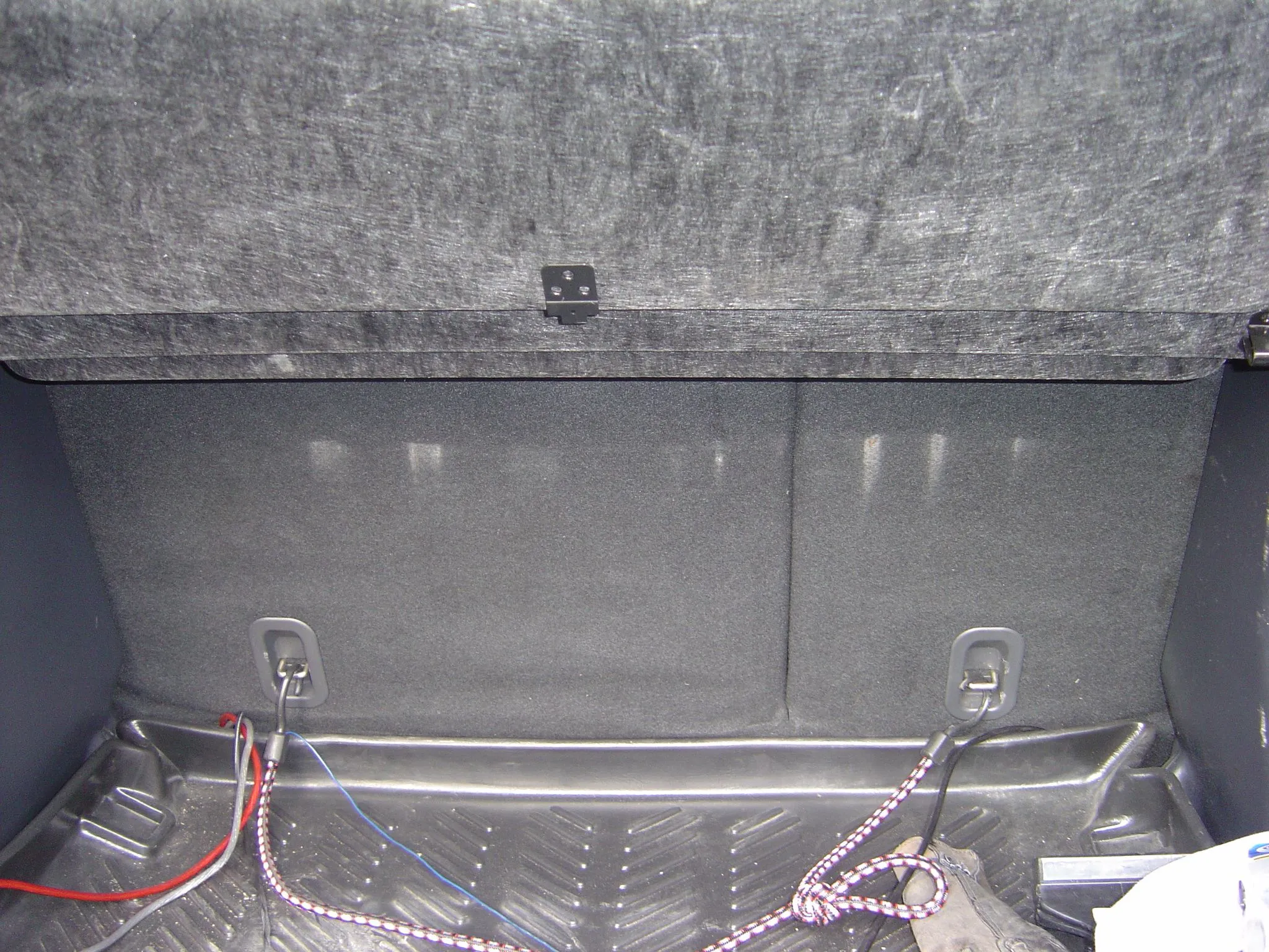

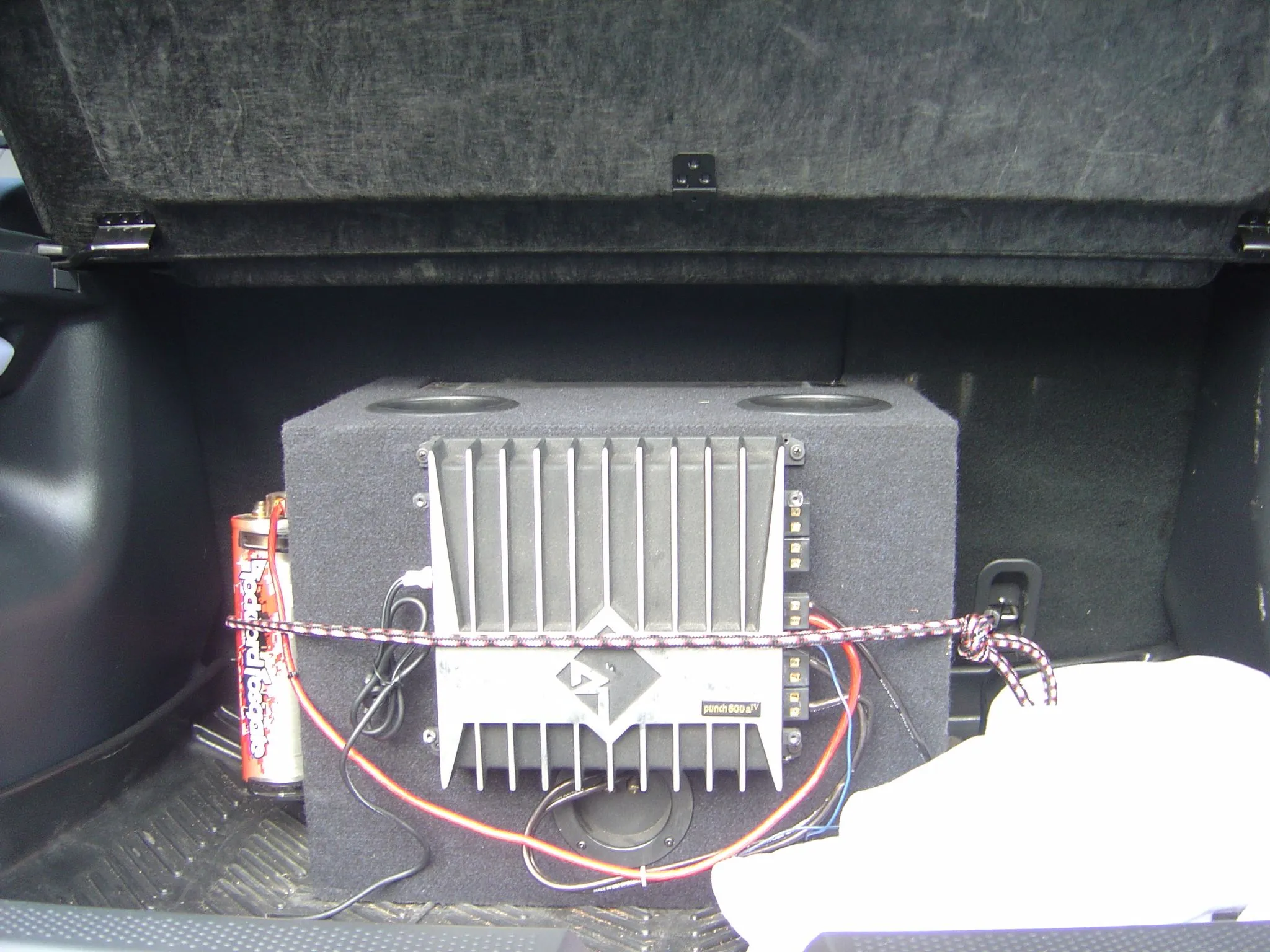

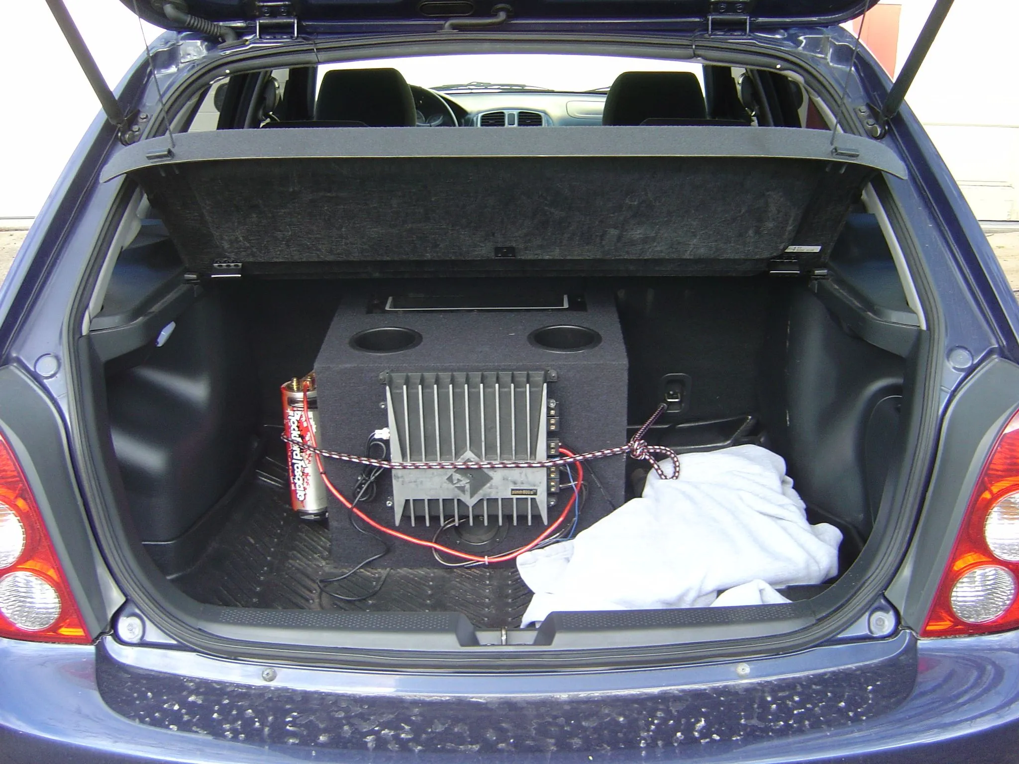

Well here some of the removal of the old box and amp.

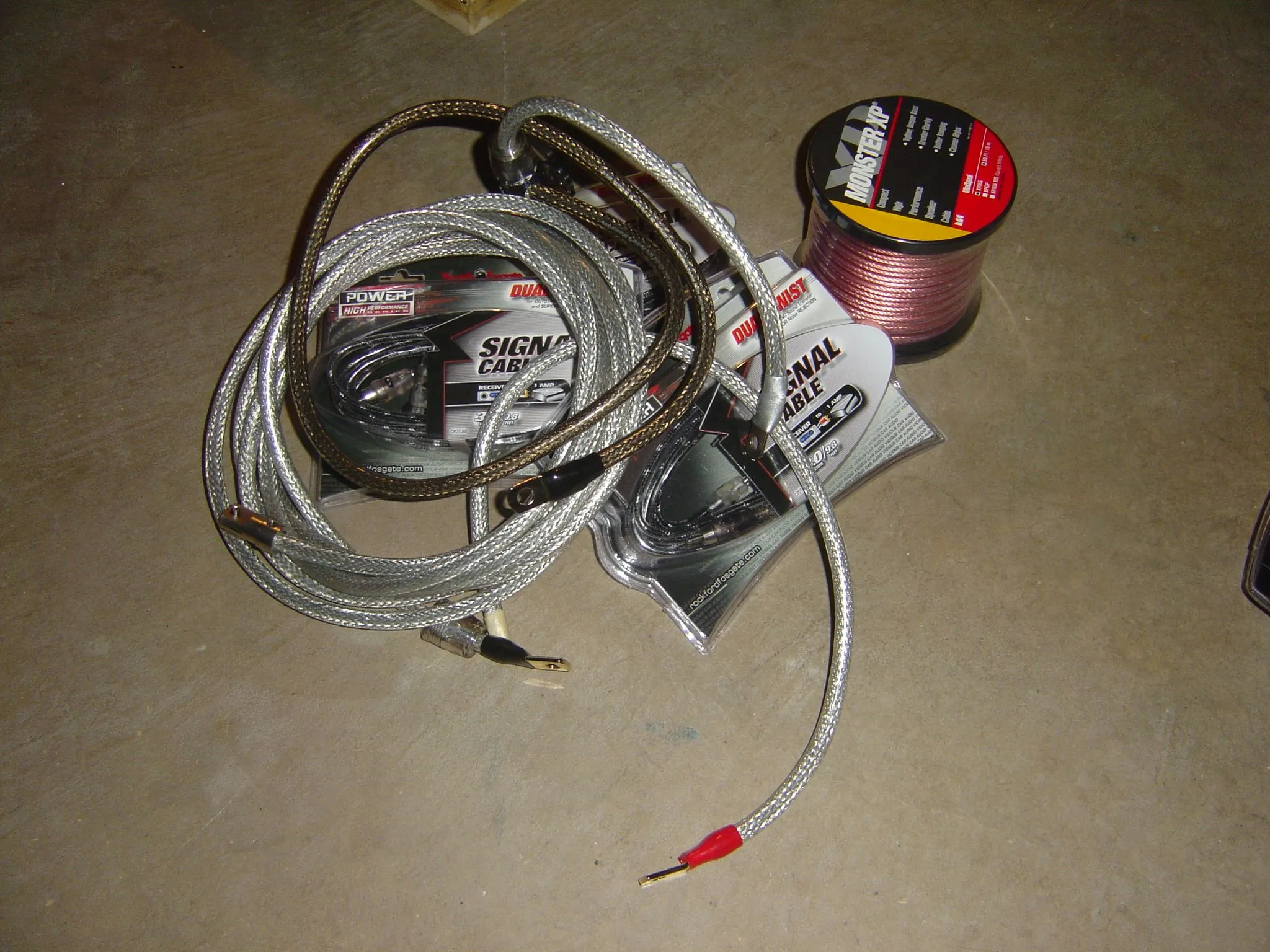

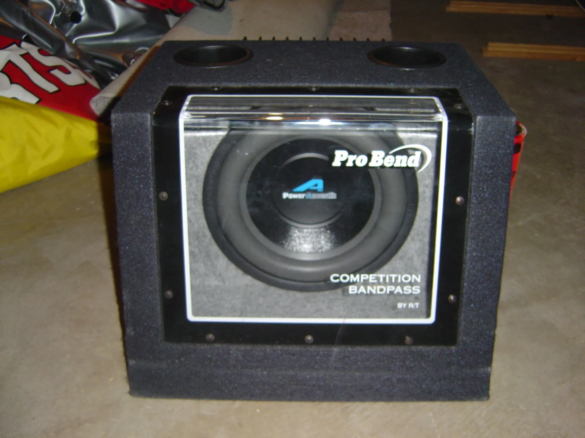

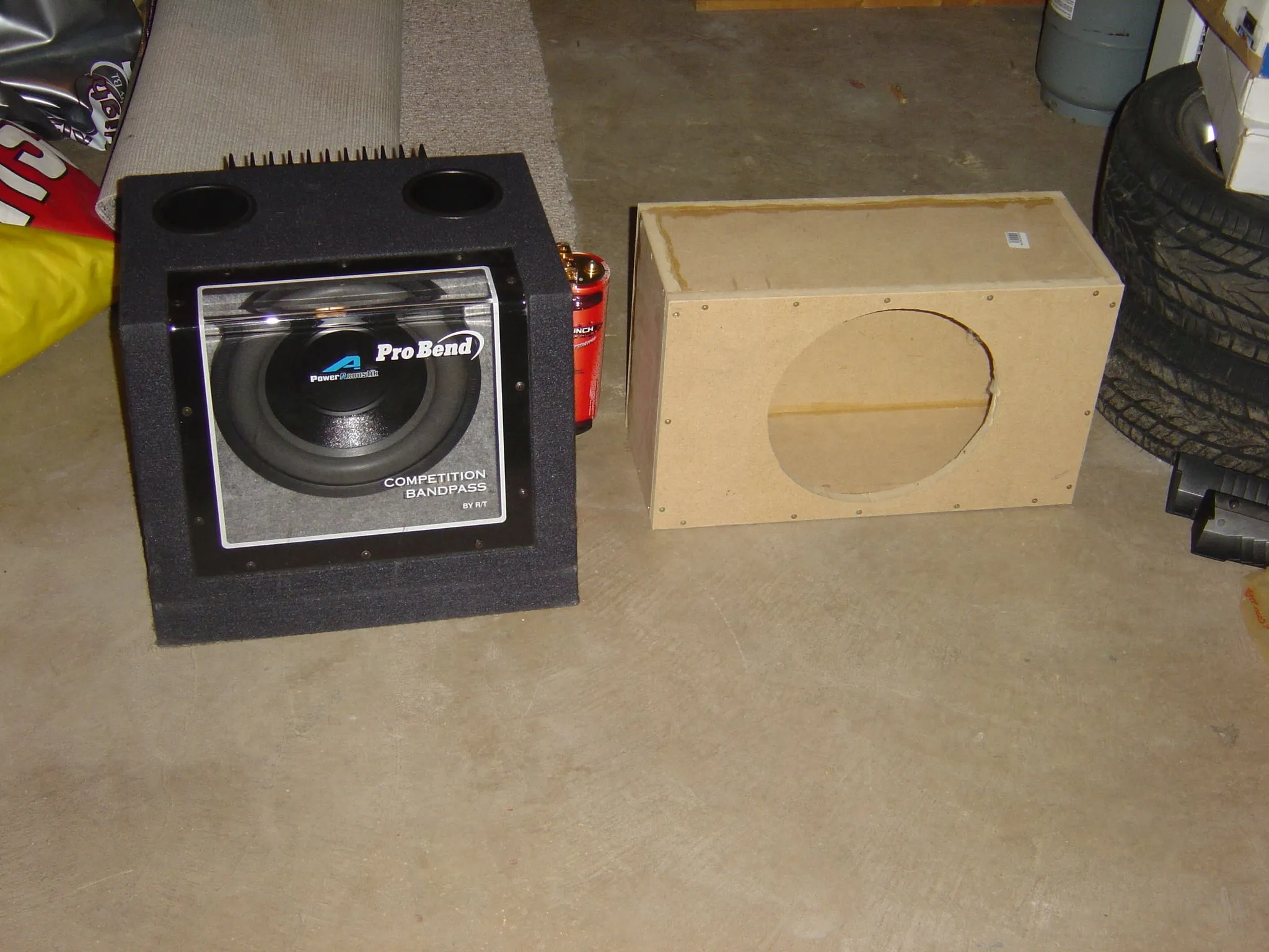

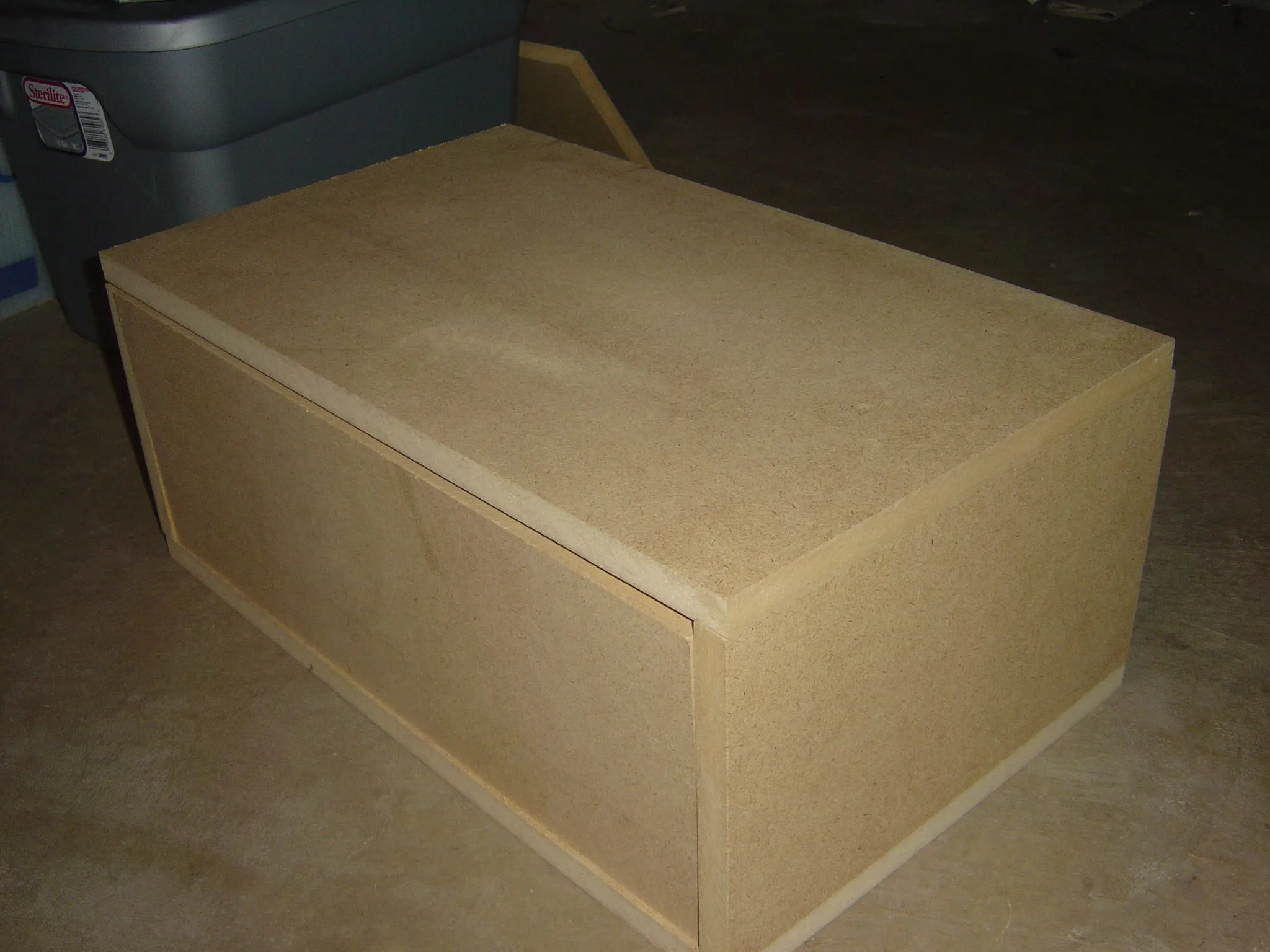

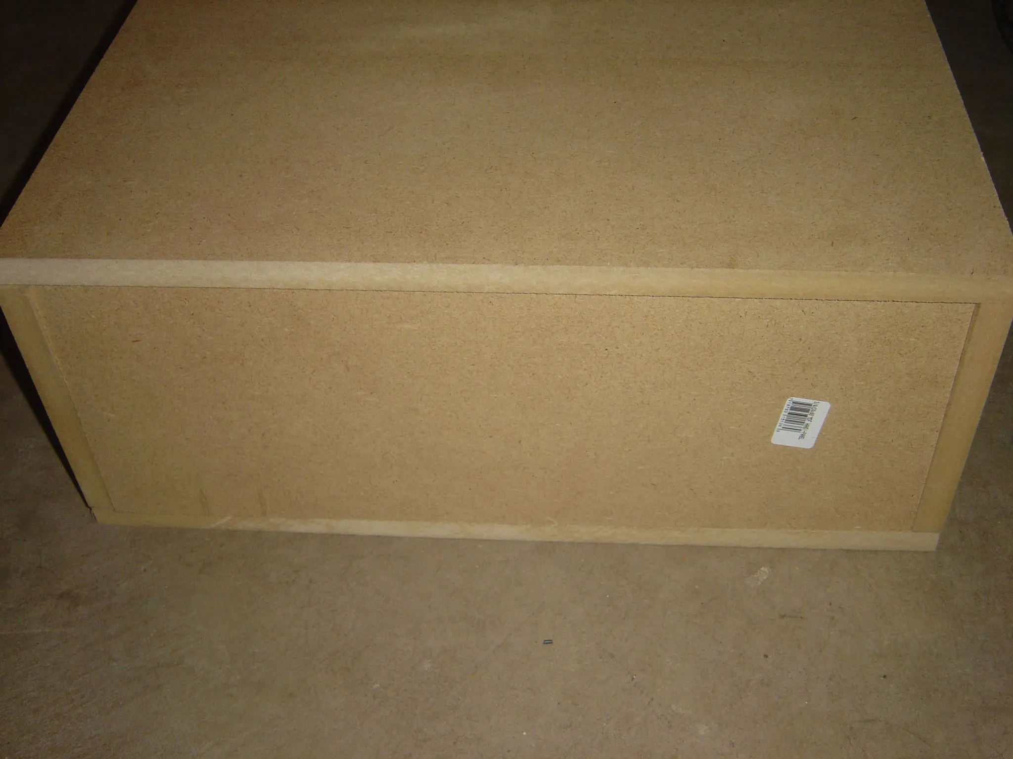

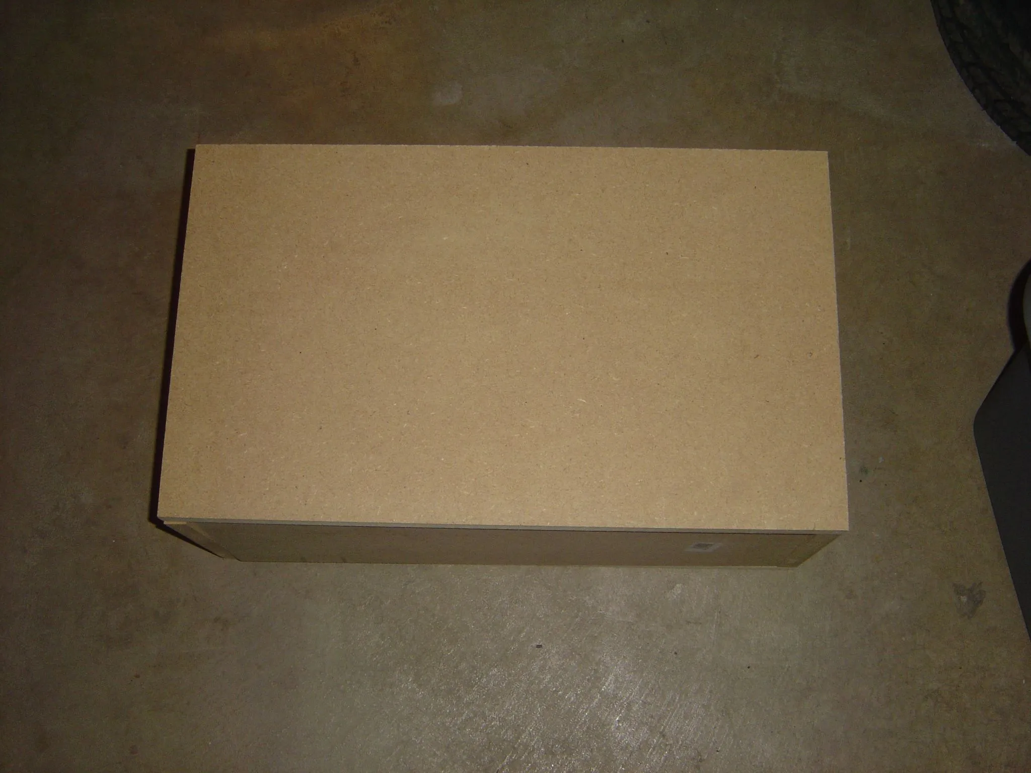

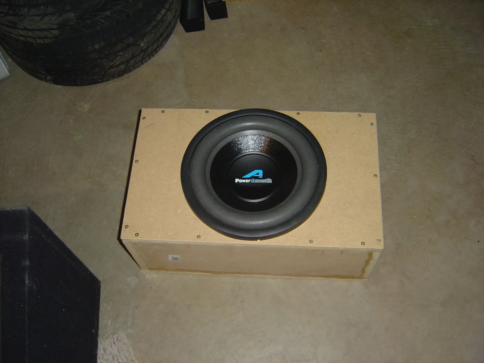

Pictures 1, 2, 3 of the old and new box.

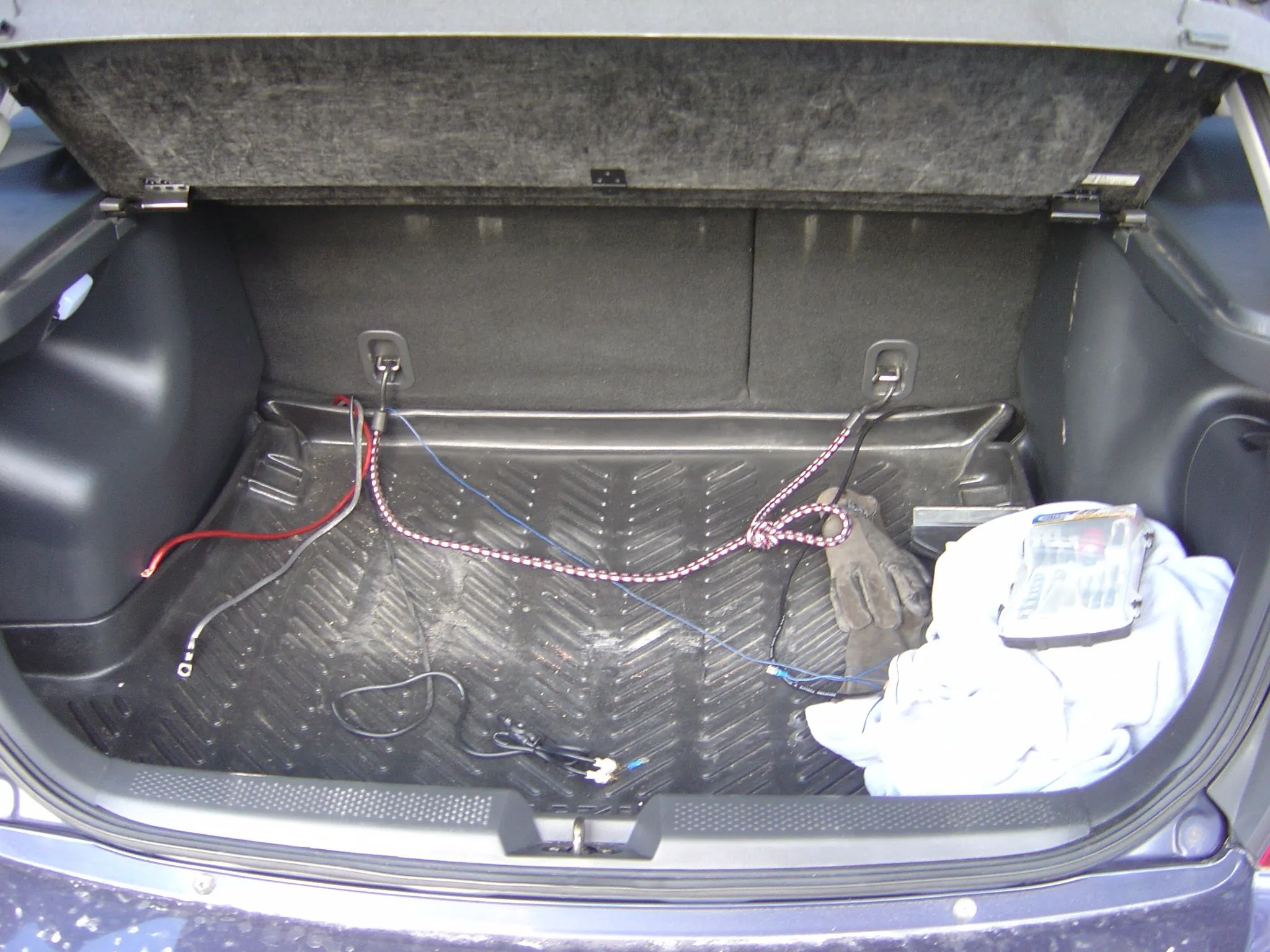

Pictures 4 of the new wiring to go in the car (new RCA cables, new 4 gage wire, new ground wiring, and new speaker wiring)

I am going sealed, because of space. NOt because of sound quality. I rather build a ported box and release the potential of the sub. But 2.2 cu ft of space in my truck was NOT an option.
i like the sound of sealed better. i know a ported box is louder, but sealed is a much tighter, cleaner sound. cant wait to hear it at the rally (assuming it wil be completed by then). hopefully ill have my project complete by then. first though, i need the weather to comply. laying fiberglass is hard to do in 30 degree weather (yupnope)
A properly tuned ported box will sound just as good as a sealed box, but much louder. The key part of a ported box is making sure it is TUNED correctly. Most poeple buy the prefab boxes and never cut the port tubes to the correct length for their box. That is why they sound like crap.
Sealed boxes are very forgiving and take next to nothing for space too.
Yeah, looking forward to see your enclosure too. I'll pray also for warmer weather to get this done in time too.
i was speaking in terms of a typical ported box as most people know dick about tuning a ported box, they just buy it and shove it in their car. sealed definitely has the best plug and play cpability, but youre right, a PROPERLY tuned ported box will POUND and sound great. the problem is, i have yet to hear one :(
No the box will not be bungeed this time. I plan on my using the actual hold down points in the corners of the hatch. Not sure how I am going to do that, but I will figure it out.
you could use a couple 'L' brackets and bolt it into the floor piece that covers the spare tire (dunno)
