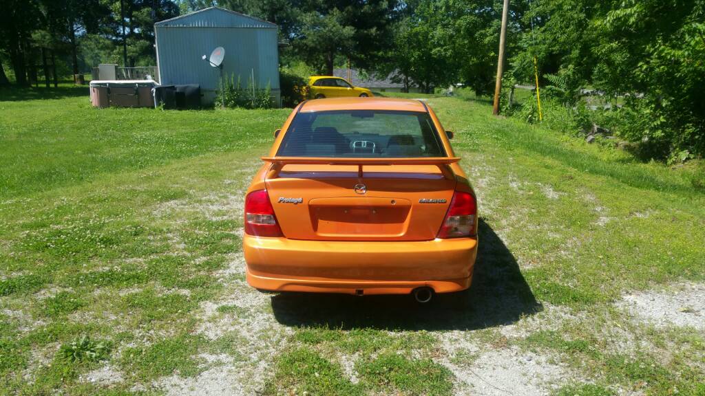

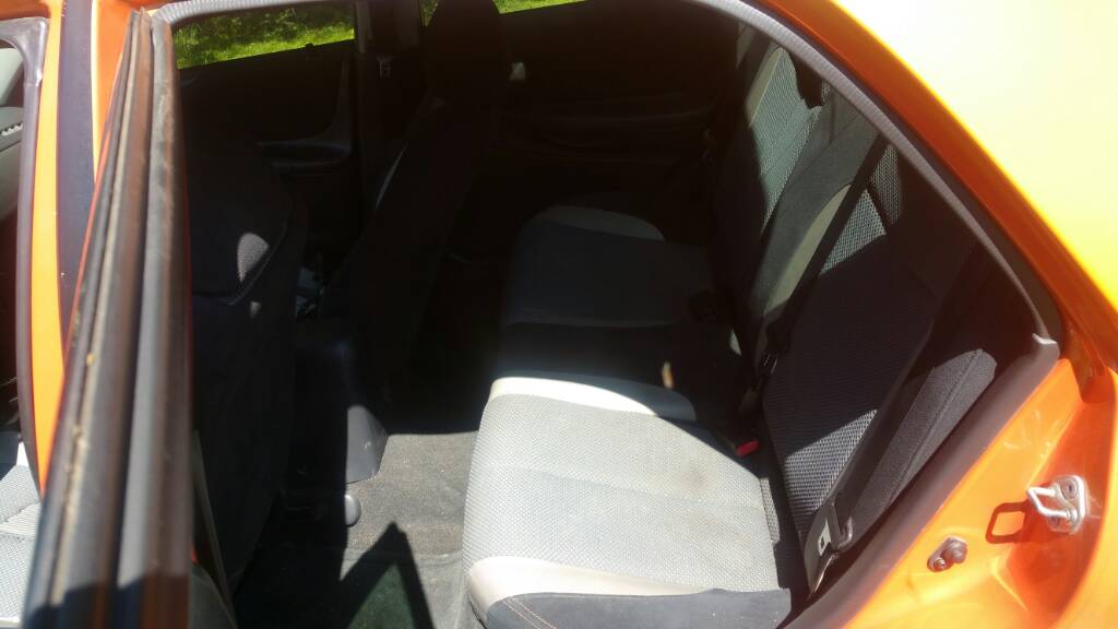

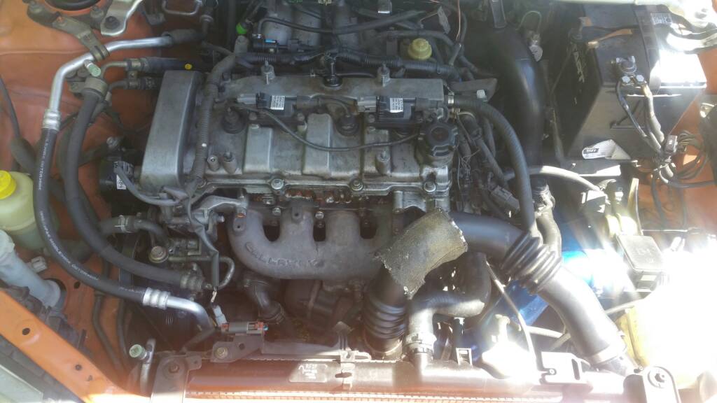

Got to take a few pics of it before i moved it into the garage, for the teardown. I also took a bunch of video of how the engine runs and such. Ill post links in a lil while.
