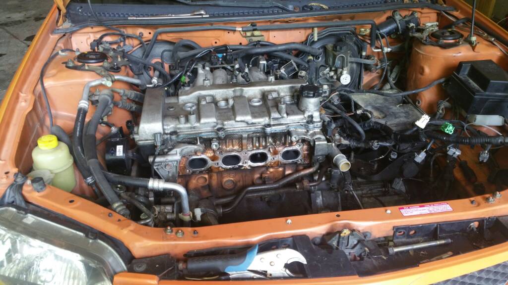

Started the teardown process today,somehow stripped one of the strut bar nuts and cant get it off...arggg

Just for confirmation, this engine will work in my MSP right?
2001 626 motor
Sent from my SM-N910T3 using Tapatalk
Ty, i figured so, but didnt wanto accidentally buy a fp engine, or something.....im Polish....it coukd happen lol
Sent from my SM-N9300 using Tapatalk
626 all had the 2.0 FS, you will need to swap the Crank pulley and cam gears, and possibly the crank and cam sensors as well.

Thanks hornsfan, i was wondering what needed to be swapped over...i guess it would be easier just to find a protege motor huh?
Natey, yea i was a lil concerned, but everything else drivetrain wise looks good so far. Even the trans shifts nice and smooth. I will keep an eye out though. I also noticed the moron just put water for coolant. Its actually sad that he blew 3rd cylinder rings, because the engine block itself is in awesome condition.

You can use the 626 engine, it's basically the same thing. Swapping over the pulleys and sensors is easy. It's up to you, you can find low mileage JDM motors for pretty cheap. Those are tricky though because you don't want a high compression FSZE.

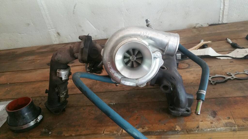

Ok, so the way things are going, it looks like for now, im going to take the motor out of my p5, and put it into the MSP. The p5 is getting dangerous to drive, and i have to keep working to achieve my debt free goal. So what do i need to do? Just make sure the windage tray is swapped over along with all of the turbo components? Anything else?
That's basically it. Swap the MBSP, oil feed, banjo bolt and water lines for the oil cooler, oil cooler stud, thermostat housing/hard water lines, and the turbo manifold/downpipe of course.
Well, on the motor thats in the MSP now, could i just replace the bearings if the crankshaft isnt scored?
If the crank journals and the rod journals as well as the journals and caps on the block are all smooth and not scored then you can probably get away with installing new bearings. I recently did that with my motor and it works fine. If they are scored you will have to get them machined down and get over sized bearings.
Thank you for the semi good news, now ill get up tomorrow and tear it down to there and give a good look see...just oil pan and windage tray?

Ok so started again on engine removal, just doing a lil bit at a time. Unfortunately my p5 has major brake system issues, and now need to replace caliper, hub, and rotor. Using my gfs cobalt to work for now
