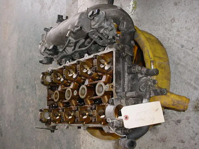

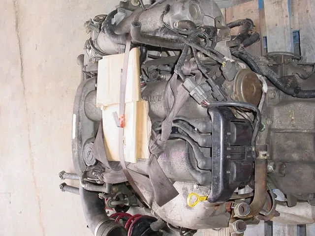

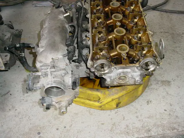

Here are the pictures of what I have..The Head alone is the 1995 STOCK motors head, The one together is the new Motor I got from the Japanese importer..He said that this will bolt it and be direct. Let me know..what i need to do to get this bad boy in here..

Unfortunatly I cant reuse the Other head, It has multiple Bent Valves and the Combustion Chamber has been Damaged...What to do now, What do I need to convert this 1.6 into my 1.8 Chassis car
They sent you a B6ZE (1.6L). If you wanted to, it'll bolt right in to the car with very few problems. However, you'd end up with 116 BHP vs the 135 of the 1.8L.
Many folks replace the 1.6L with the 1.8 and only have to change a couple of things. The J-spec 1.6L is identical to the US engine, so there's nothing special about the one you received.
Sorry to be the bearer of bad news :(.
To swap this engine in, you'll need to find some way of using the throttle body from your old 1.8. You'll need to make an adaptor plate or find a way to make the TPS sensor work with the 1.6L TB. Perhaps you could modify Flyin' Miata's 1.6 to 1.8 TB adaptor plate to work for you http://www.flyinmiata.com/index.php?deptid=4535&parentid=0&stocknumber=05-40000. Additionally, the CAS and coils from the 1.8 will have to be used as well. Aside from that, it should be just like installing another 1.8L. You shouldn't have to change the harness or ECU at all.
yeah. the motor they sent is a 1.6l.
