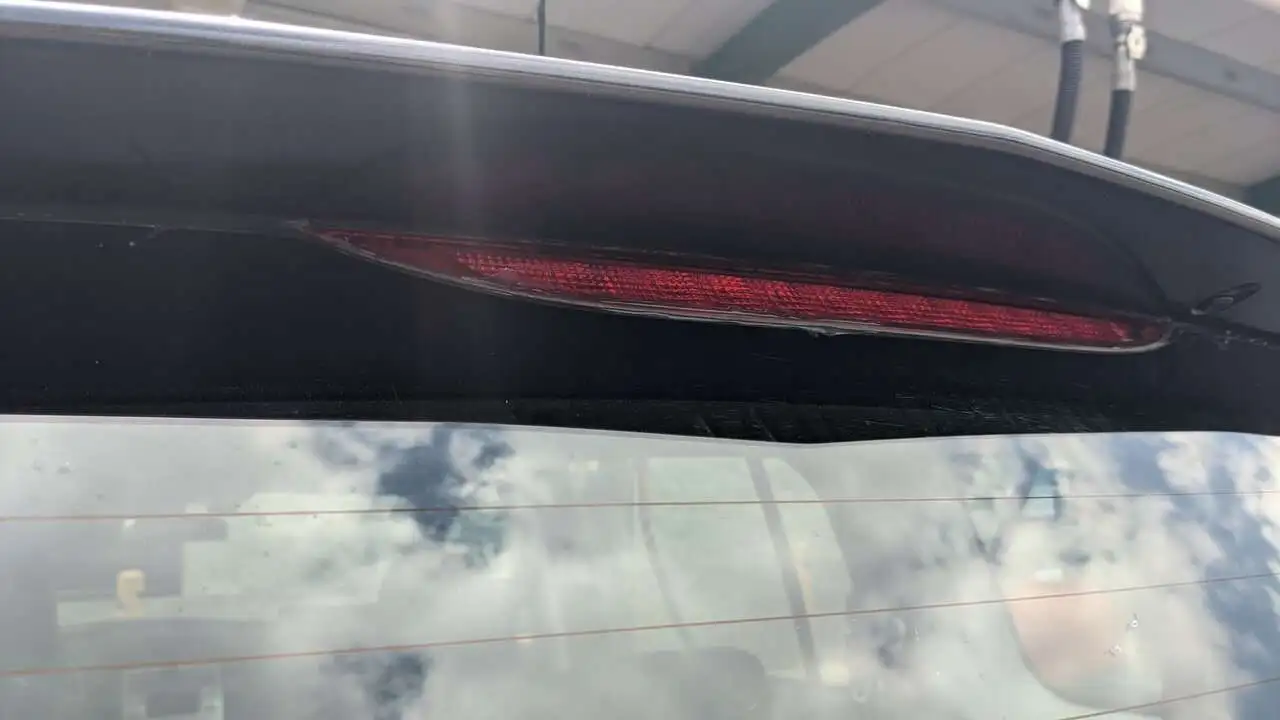

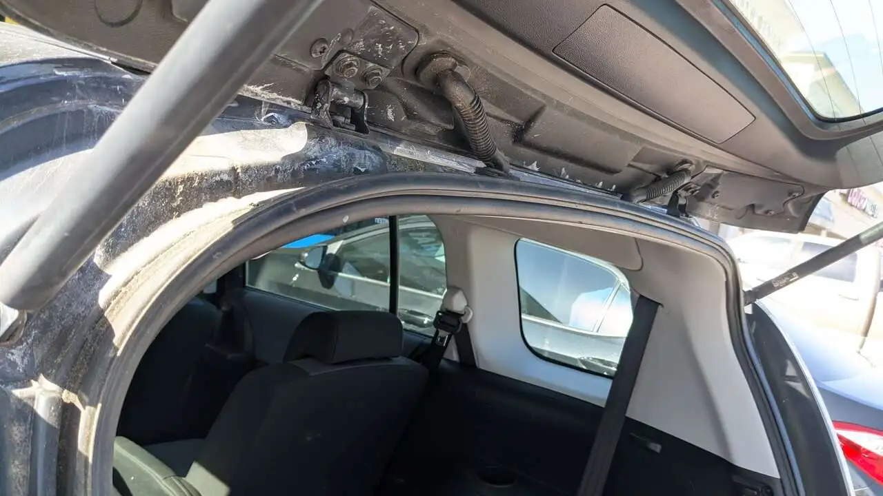

I was getting a car wash today and opened the rear hatch to get my towels and stuff out and noticed the back of the lift and carpet was damp and could see water/soapy solution on the carpet too. I tried looking around with the lift open and checking to see where it could be coming from.
It looks like the previous owner had an issue too since I could see he had tried to use silicone to fill the gap of the window with the third brake light under the spoiler.
I checked some other forums and saw some mention the rear wiper rubber insert. I looked and I am missing the rubber grommet. So I'm gonna see if I can get something from the parts/hardware store that can fit in it/cover it.

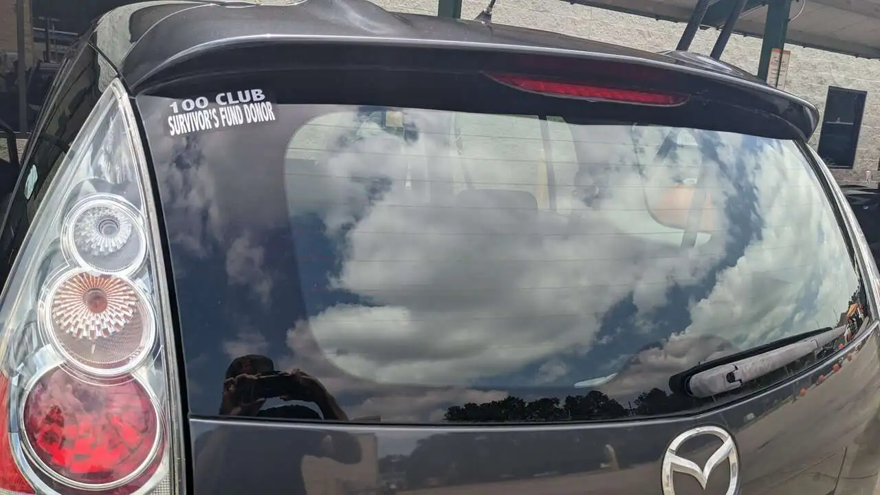

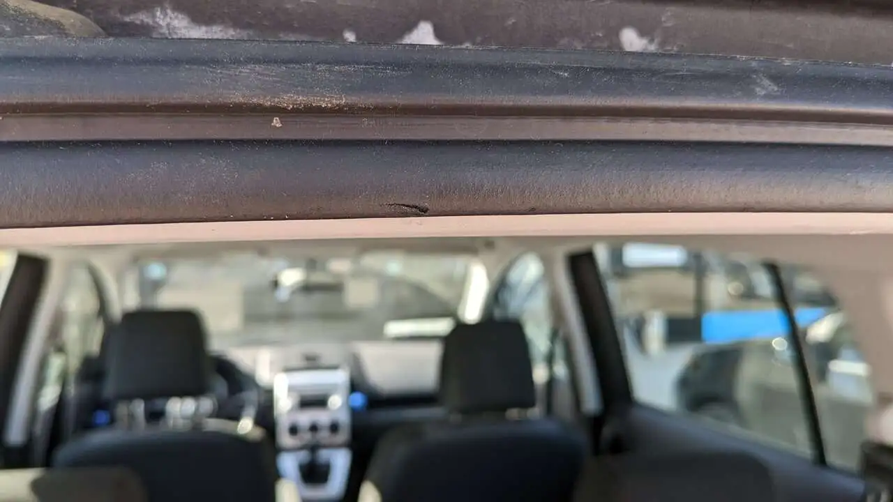

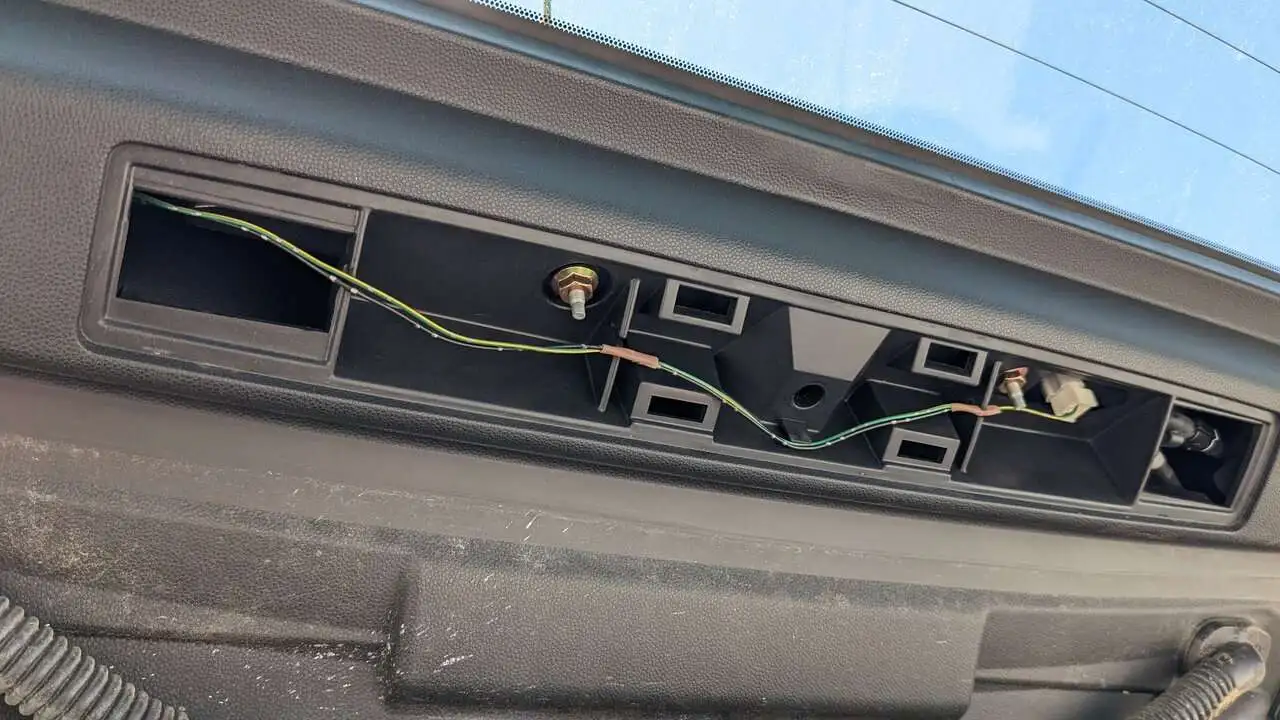

The rubber seal looks to be in good condition. Looked over the seal and it had some small knicks just from wear, but they were very small. When the inside of the hatch was wet it was mainly on the lower half of the windshield and down the back. I checked the third brake light panel and its completely bone dry with no signs of moisture ever being in there.
I will try and take off the main rear panel to see if I can pinpoint it. But I'm sure it's mainly from the rear wiper. I ordered a rear wiper delete since I couldn't find anything that would work at hardware store, and the actual rubber seal is going for $25-35.
