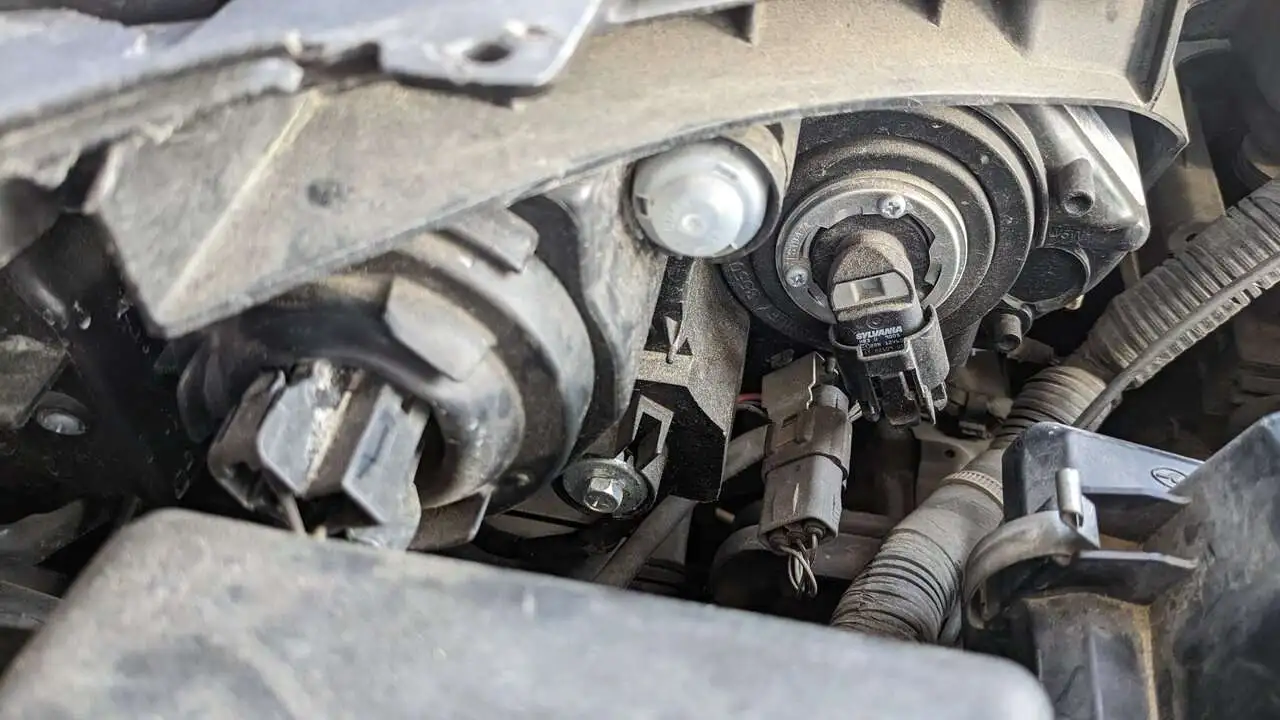

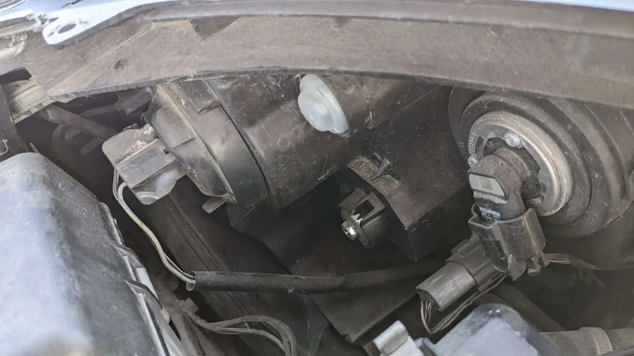

Good to know, I will do some research and see if I find anything. I will post some picture tomorrow of the headlights currently on the car to see if yall can offer any feedback on them as well.
Okay, those are regular headlights, not HID.
I will bet you dollars to donuts that whomever installed the bulbs failed to correctly snap the holder in place. For someone who isn't used to them, it can be tricky.
Correctly fasten the bulbs, I bet that solves all of your issues!
I will take a deeper look when I get home. The rubber housing was off a little bit and I snapped it back on. Do you have any reference photos or diagrams by chance? Never dealt with HIDs before, so not entirely sure the origin the lights should be fastened.
Again, those aren't HID burners. Those are regular old H7 halogen bulbs.
Look at this website. Replace the Headlight Bulb on a Mazda 3

As to what theblooms said the 1st gen Mazda 5 (and Mazda 3, and probably lots of other Mazda models) had a really terrible low beam lamp retention system. I refer to it as Satan’s headlamp retention clip. The common errors which occur are:
- not having the tab on the H7 lamp base lined up with the notch on the projector which can make the lamp stick into the projector at an angle
- not getting the retention clip all the way seated……. The trick is to hold the lamp stable with the tab in the notch, get the end of the clip seated over the adapter/spacer on the lamp, then quickly push the locking end in (towards the front of the car), and up. If you try to do it slowly or carefully it’s damn near impossible. Gotta go in like you mean it.
So double check the lamp position because if the lamp was pointed wonky in the housing then you want to fix that, and not just aim the projector upwards.
Back to your adjustment question, obviously you can adjust the lights up. There are two adjustment bolts you can turn, one of them being the big goldish one in your pictures. If you didn’t do it this way just note you can stick a Phillips screwdriver into that plastic slot and turn the toothy washer vs. getting a socket or wrench onto the head of the bolt.
