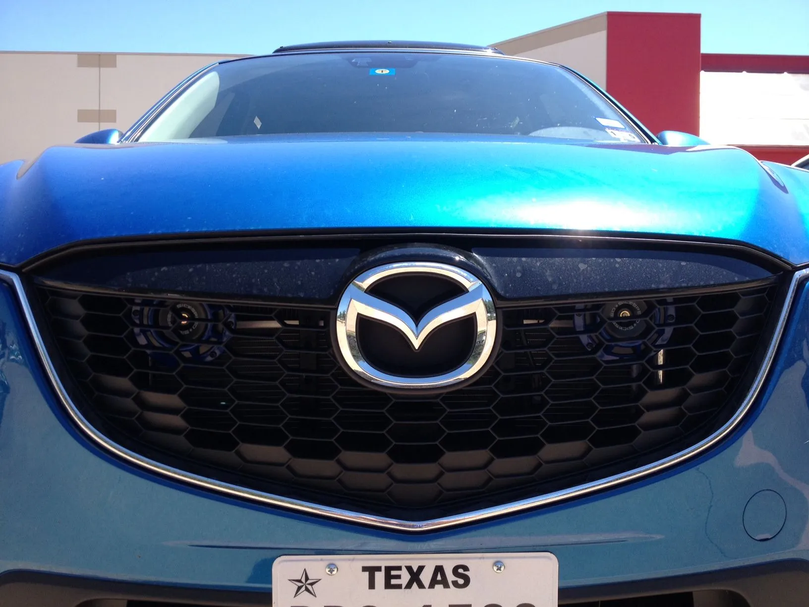

Thanks for this info - I followed your procedure and installed two Sickspeed 118 dB horns in my 2014 GT. Used plastic clips to replace the rivets.

What colour horns did you buy ? ( picture ? )
Gr. Karl
Bought blue horns from amazon.com about $30. I am trying to attach a picture below (apologies if it doesn't get there)
sickspeed horn
