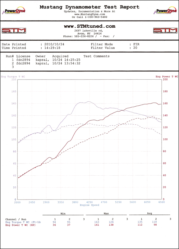

man, I have seen a few of the youtube videos of RICER and they are pretty impressive. I can only wait to see what you can do with this platform. There are a few successful members that have passed the 300hp mark. They can tell you the obstacles they encountered to reach that point...stock internals, LSD and our gearset are holding this car back a lot, that and the fact that our ECU is not tunable like the Evos are. It's either piggyback or standalone with these cars. Motor mounts suck, put those on the to do list. Stay under 10 psi unless you are confident with your tuning on this particular car. I have heard the stock T25 is not really efficient past 14 psi. Stock exhaust manifold tends to crack and the bolts tend to fall apart causing an irritating exhaust leak. Once you address all of the problems with the car, you should be ok. There is a thread with everyone's builds in it. I would take a look at that to get an idea of what it takes to build this car. You can also check out the dragtimes thread to see everyone's times in the 1/4. In your journey working on this car, you WILL encounter most of the problems that pretty much this entire forum as encountered. So, I know you will be able to find your problems or ideas here. Keep us posted, welcome to the forums, and we are looking forward to what you think about this car and its potential.
