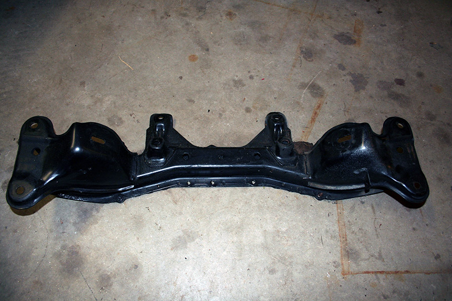

One thing I noticed today is this.
12a/13b swap mount for an RX3
RX3 crossmember
S chassis (240sx) crossmember
Notice the similarities? It seems like with that bracket, mounts would be very simple.
Also, the front cover to shifter is about 44 1/2" and the 240sx crossmember to shifter opening is about 45".
