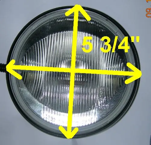

Stock size
Our stock size is 5 3/4"
Included is a picture

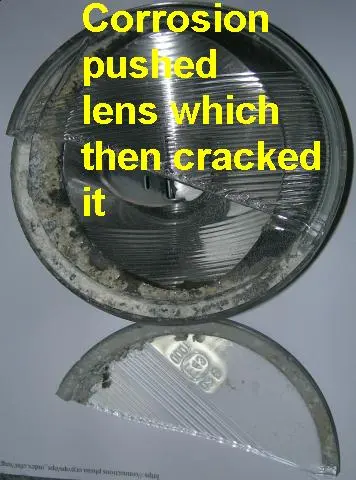

Included is a picture to show how the housing corroded which then cracked the lens.

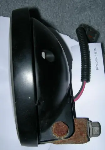

Here is how the stock fog mounts

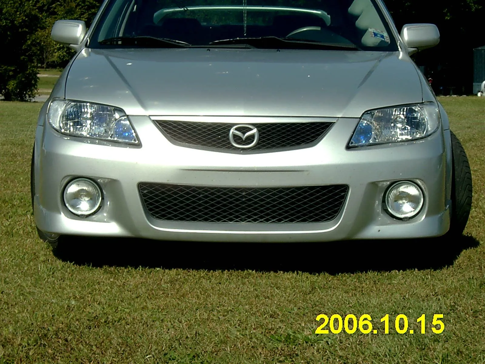

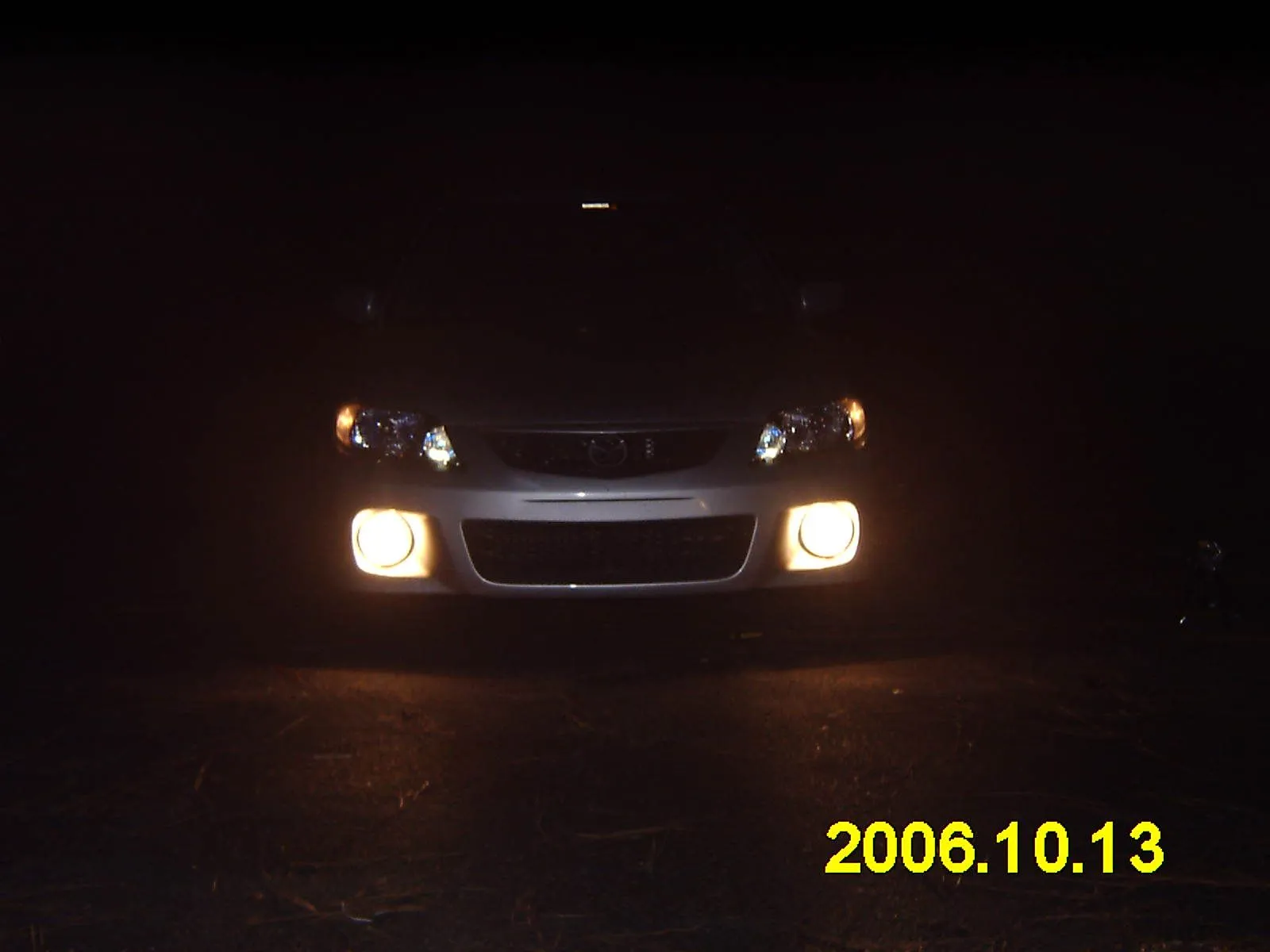

I bought some yellow CATZ spot fogs from this seller on ebay for $85 for the pair. It is an amazing setup. Very bright, great mounting brackets, and comes with all the wires and switches you could ever need. Here is the link:
https://www.ebay.com (commissions earned)
and here is a picture of mine installed:

I was looking for new FOGS for P5 because DEALER wants $195 for one fog light, that does not include wiring or black housing.
Thats why we recommend using RockBlocker on any of your lights especaily with the fogs being glass.
