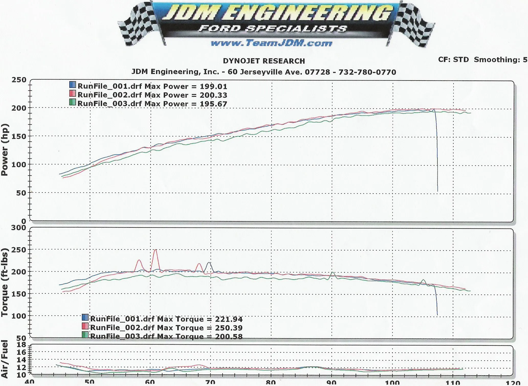

Finally got back to the dyno after all the problems i had at the other place back a couple months ago. I went to a dyno day with a whole crew of fords, they were nice enough to let me get in on the discount, and i have now joined their club.
Mods are HIBoost FMIC w/hardpipes, Injen SRI, greddy type s(vented), apex 2.5 catless dp, DSM AFC running stock super map, Greddy Profec set at 10 PSI, colder plugs.
They didn't know s*** about my car and didn't know how to hook up the rpm meter, but they ended up figuring it out. The 250 tq is a mistake. I ended up making 200hp and 200tq on the 2nd run. I am pretty happy with it. Now i'm hoping dsm can make me a custom map and i can get a little better a/f ratio.
Here's the sheet, let me know what you think

Nice numbers. Where in nj did this take place? Also I bet the ford guys where kinda surprised by the numbers.
Thats the best a/f line I have ever seen on a MSP. Why do you want to change it?
nice stuff, I would leave it the way it is your not going to get much more by slightly altering those a/f s

Yea the a/f's are good, i was unsure if they needed to be changed at all.

wow, great numbers. your a/f ratio is great! wish my N/A would run that ratio and i probably would gain some more power.

Yes, it's 12:1, 11:1, etc. His graph shows his AFRs between 11:1 and 12:1 for the most part.
His a/f ratios are very nice, although some will argue that they are on the lean side up top for these engines. Of course he has exhaust and an FMIC to keep the temps down, and the colder plugs help avoid pre-detonation. With 93 octane he should be golden.

now thats a beautiful a/f graph!!!! to be honest thats basically exactly what we prototyped these units to mimick...I wouldnt adjust a thing on that graph! I'm glad to see everything finally sorted out...I was having trouble sleeping after the first time you went!
I am running that setup now... I hope my AFRs look that good! I wish I had that uploaded during my dyno.... I had a bad map and leaned out causing misfire. This stock one should make things better, though I am too cheap to go back out and get it dynoed again.
