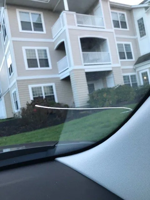

why do you think this? The crack is on passenger side, started near the edge
From my experience with safelite. A stone hit my car, I had a bullseye and a small crack. I took it to their shop to have it fixed. They would not let me watch. The tech came back and said it cracked worse from him trying to fix it, and I need a new windshield. I think it is a scam because they get more money doing a windshield repair. This was many years ago, maybe they will fix it successfully.
This is on the side. It’s a tough spot. Even slightest pressure there can extend. I did repair mine on my own (1.5 inch on the side because I catched it early) actually stopped it from spreading out further..for now.. hard to see its there but its there. Eventually after the next one I would have to change whole glass.
Not sure if yours is easily repairable. Most likely not by safelite but by some guru who does that every day. Small business owner :) and yes for new glass any new mazda needs camera alignment. It’s part of the safety systems. You can and should ask for oem if possible and if you decide to change.
You can always try repair but plan for change.
That looks exactly like the crack on my 2020 though mine was a couple of inches longer. Exact same location. Safelite replaced the windshield yesterday. I requested OEM glass and the insurer complied, had to wait several weeks for Safelite to get the glass from Mazda.
Put some RainX windshield repair on it soon if you want to save it. The crack will spread quickly if you disturb it.
