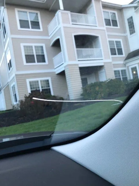

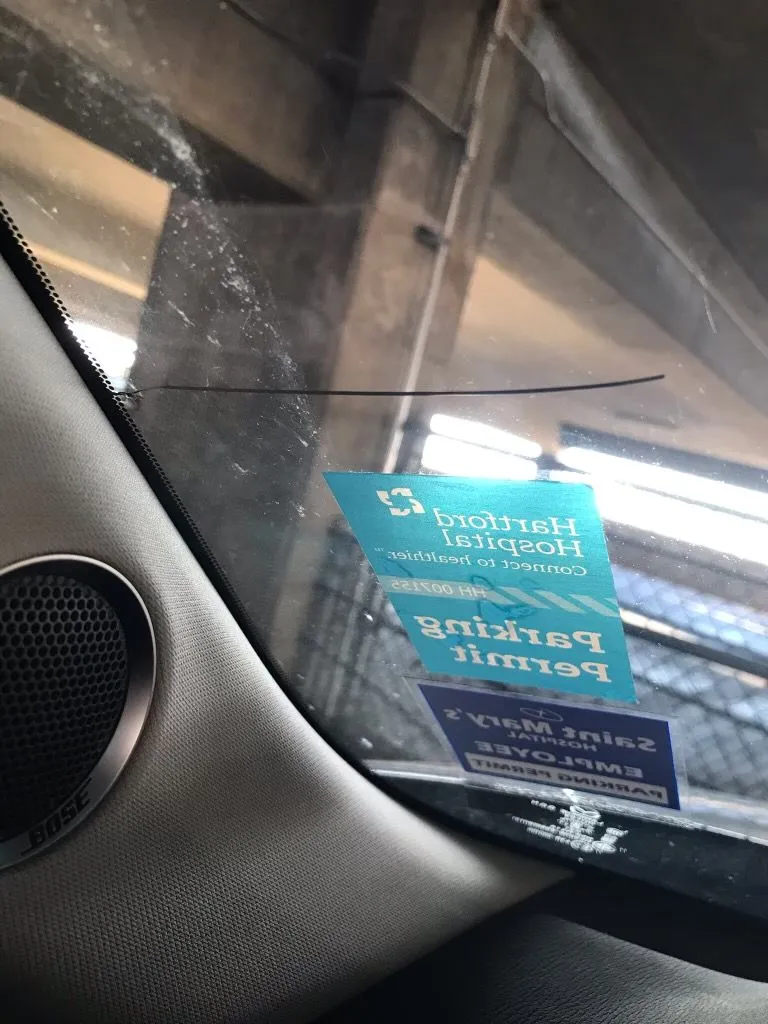

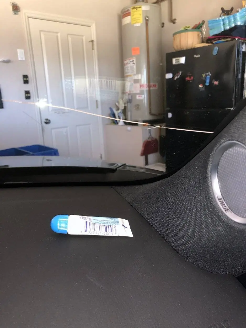

update: windshield being replaced Saturday..BUT on the way to work this morning the exact same thing happened on the driver's side, a crack on the edge. She said she wasn't behind any trucks and no road work going on. Seems odd that it could happen 2 times in 2 weeks and both cracks starting on the edges.
Wow that’s really unfortunate! Take a close-up picture of the crack and post here. Contact Safelite (?) immediately and express the same concern. Hopefully they have some sort of free replacement warranty for newly installed windshield if there’s no obvious sign of rock-hitting.
One of the cracks on my windshield appeared suddenly and also near the edge. I wasn't following anyone but I did find a tiny speck that indicated where the crack started.
That crack, on the passenger side, stopped after I applied some clear RainX resin.
no, the original cracked windshield has not been replaced yet, on order..OEM. This crack is on driver's side edge. So strange, looks to be same location, opposite side.
First Pic is new crack, 2nd pic is crack that happened about 2 weeks ago. What are the odds of 2 rocks hitting the very edge of the windshield on both sides causing about 6" cracks?
OK, good for you then. Statistically your windshield is immune to the rock hit for the next 5 years maybe? ;)
So it's not a road she can avoid. Guys is there a plastic stick on material that can go on the windshield that prevents stone damage? I think she is going to get more stone hits on that highway, it must be a pretty bad highway.

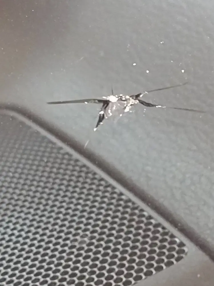

Two days ago on I95 I got hit with a small stone in the same area. Immediate 1” star cracked both directions to 4” in about 2 seconds. Crack has been slowly expanding and is now about 8”. Have an appt with Safe lite tomorrow to replace the windshield. Estimated 2-3 hours to replace the windshield and perform all the Mazda sensor adjustments needed.
