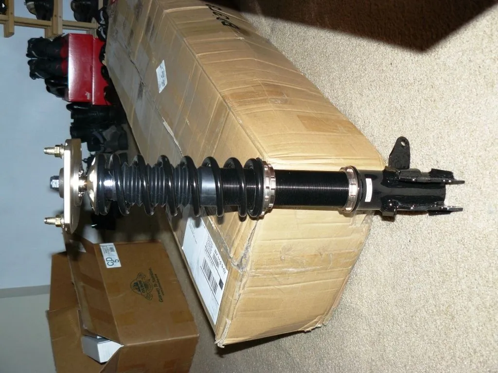

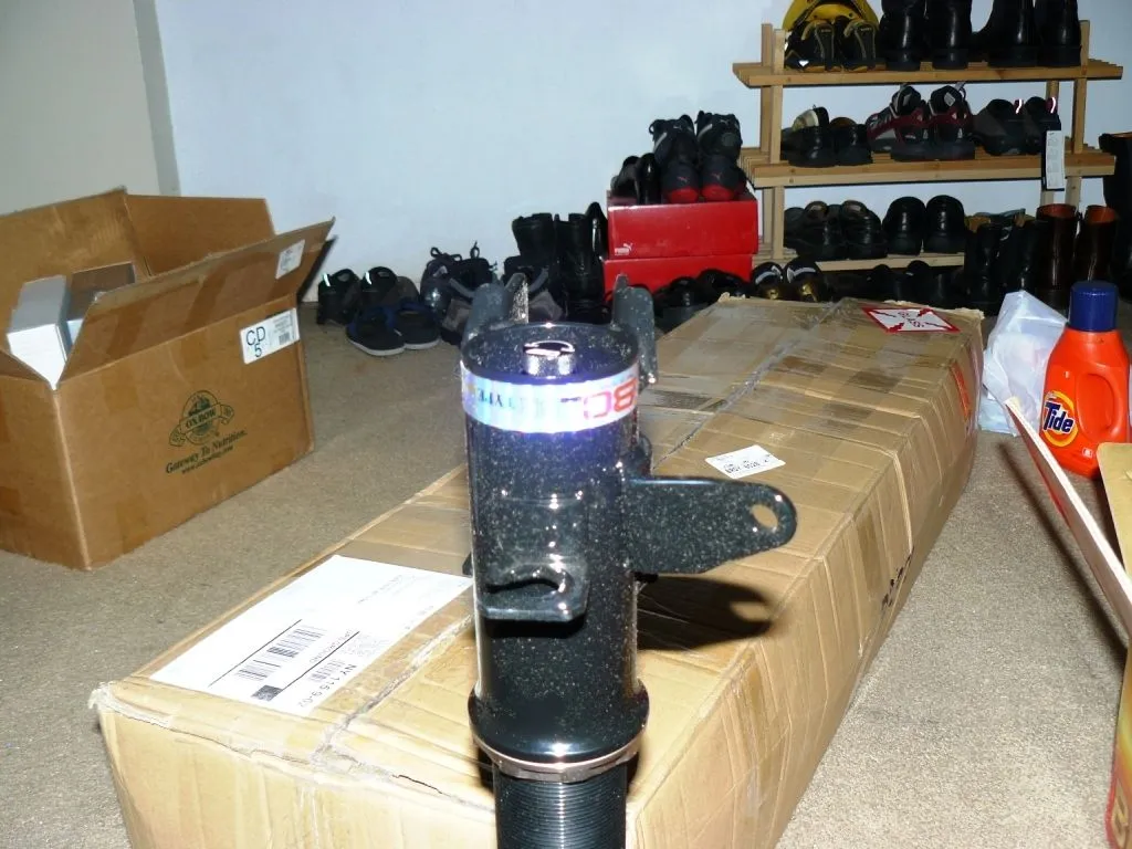

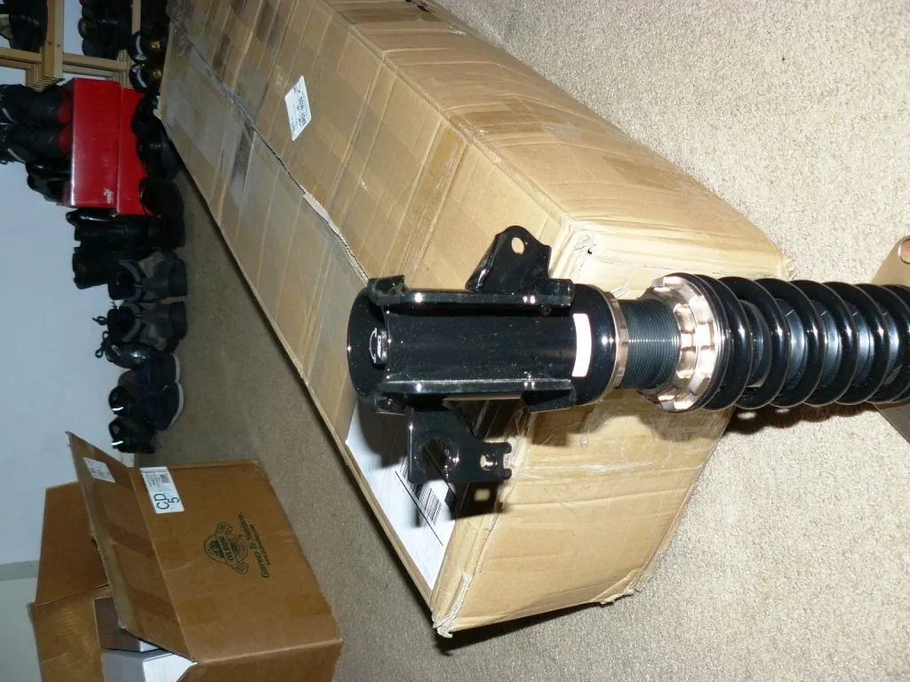

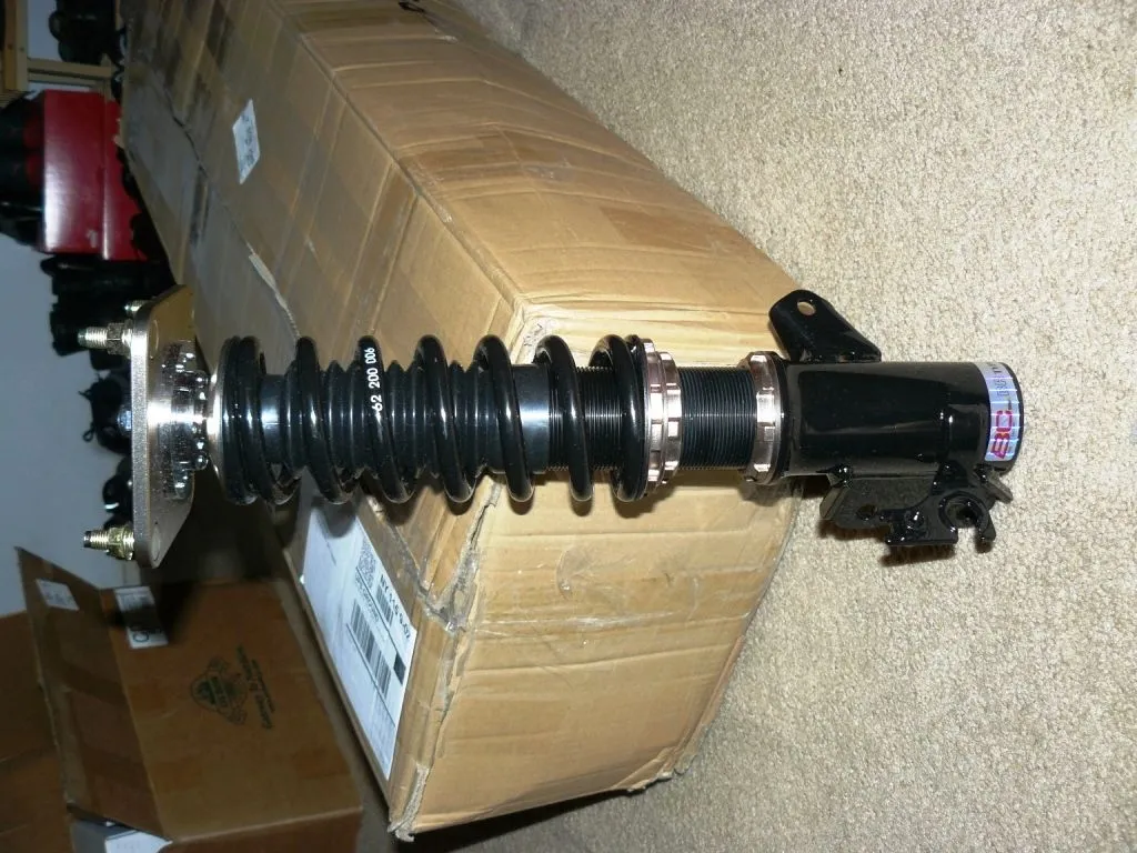

Some pics of the inverted BC racing coilovers

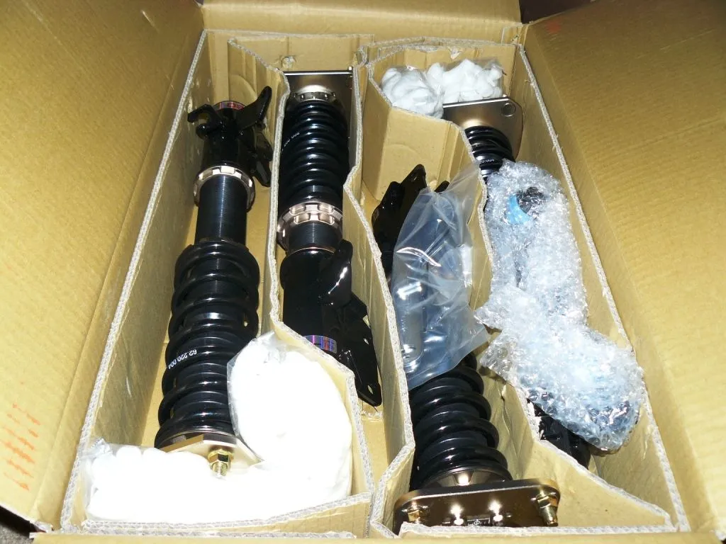

More Pics

I'd like to see what one of them looks like disassembled w/ that dust cover off...
hmmm... inverted... nice but need to get something to cover the adjusment knob being that its totally exposed to the elements as mentioned earlier. I thought it was going to be a problem adjusting the rear because of the stupid seat belt bracket but it not cuz i didn't even put it back on :)

those look just like mine (spring on top). I'd say they aren't inverted. Who did you buy them from, who said you were getting the RAM setup?
edit: just saw the adjuster on the bottom. how are these inverted if the spring is still on top. isn't that where the strut piston is? or am I just seeing these wrong?
those looks nice but they do look the same. I'm sure you can fab up something to cap off the adjusting knob...a 5 gallon arrowhead cap, a balloon, anything. lol

is it possible that the term "inverted" may be just for the adjusting knob being inverted for easy access and everything is the same?
