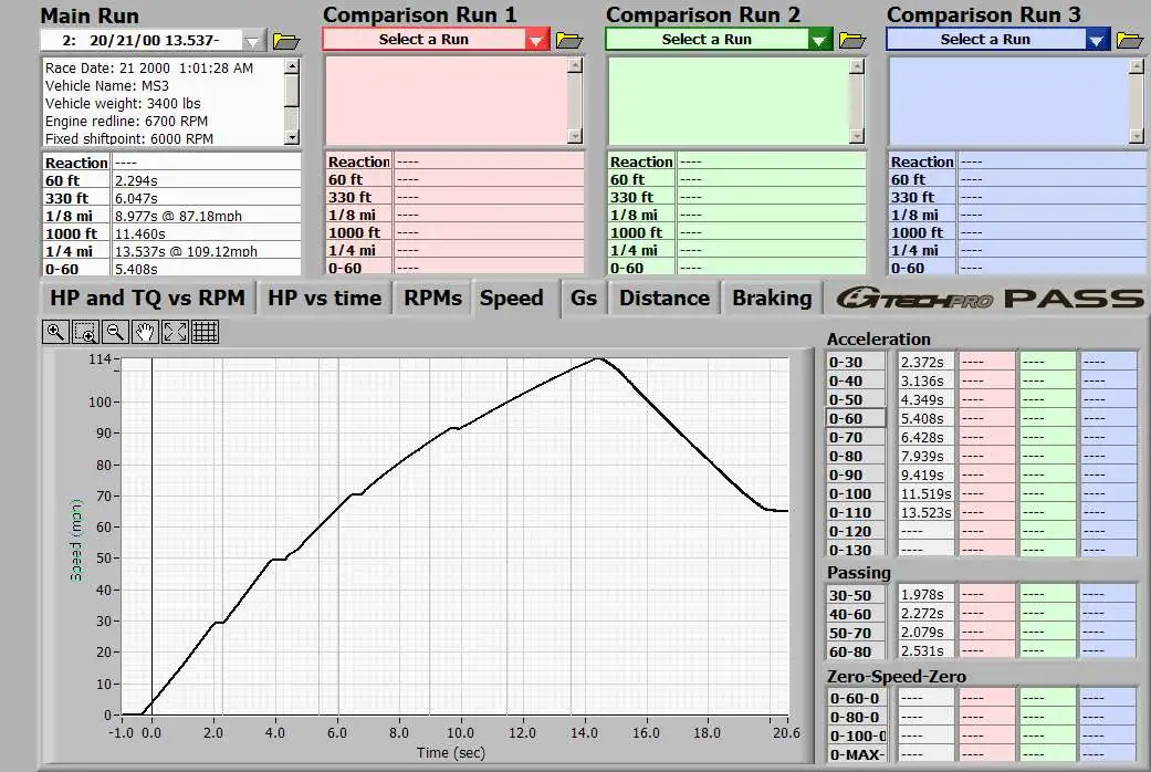

What, if anything, does this chart say about top end strength with a CAI? I say hitting 100 mph in 11.5 seconds is pretty strong. 60-100 mph was only 6.1 seconds. True, I have a catless DP/RP too, but the point is that the intake, under full boost and once in gears that will let the engine produce full power, is pretty damn good, IMHO. Please excuse crappy launch!
Note: My accelerometer will not hold date and time when unplugged. The run was made yesterday morning.
