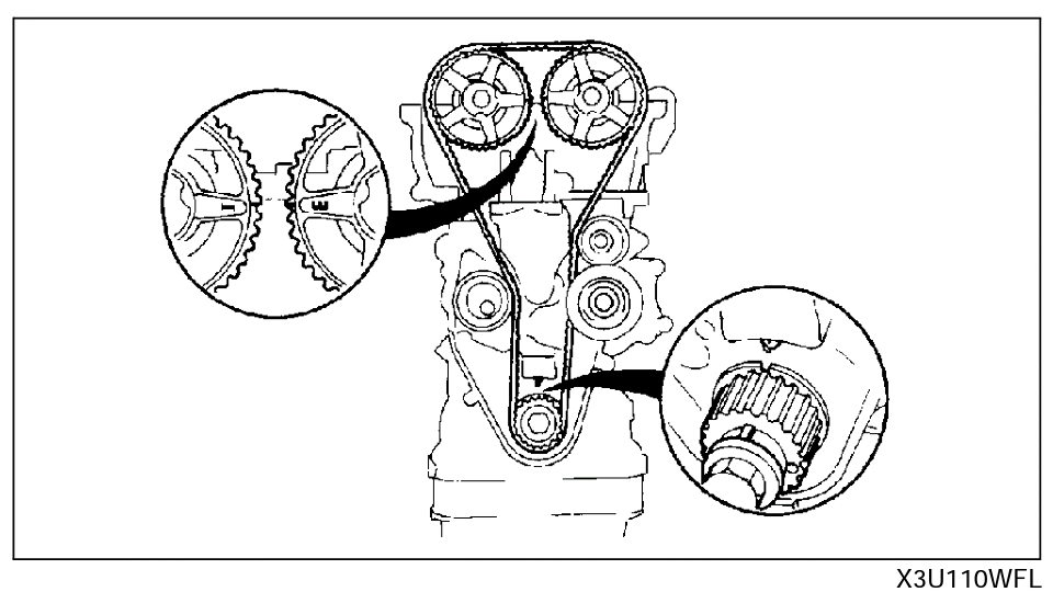

Don't forget to rotate your engine over a couple of times after the belt is installed to check your timing again.
I had my belt on and off a dozen times before I finally got it right.
