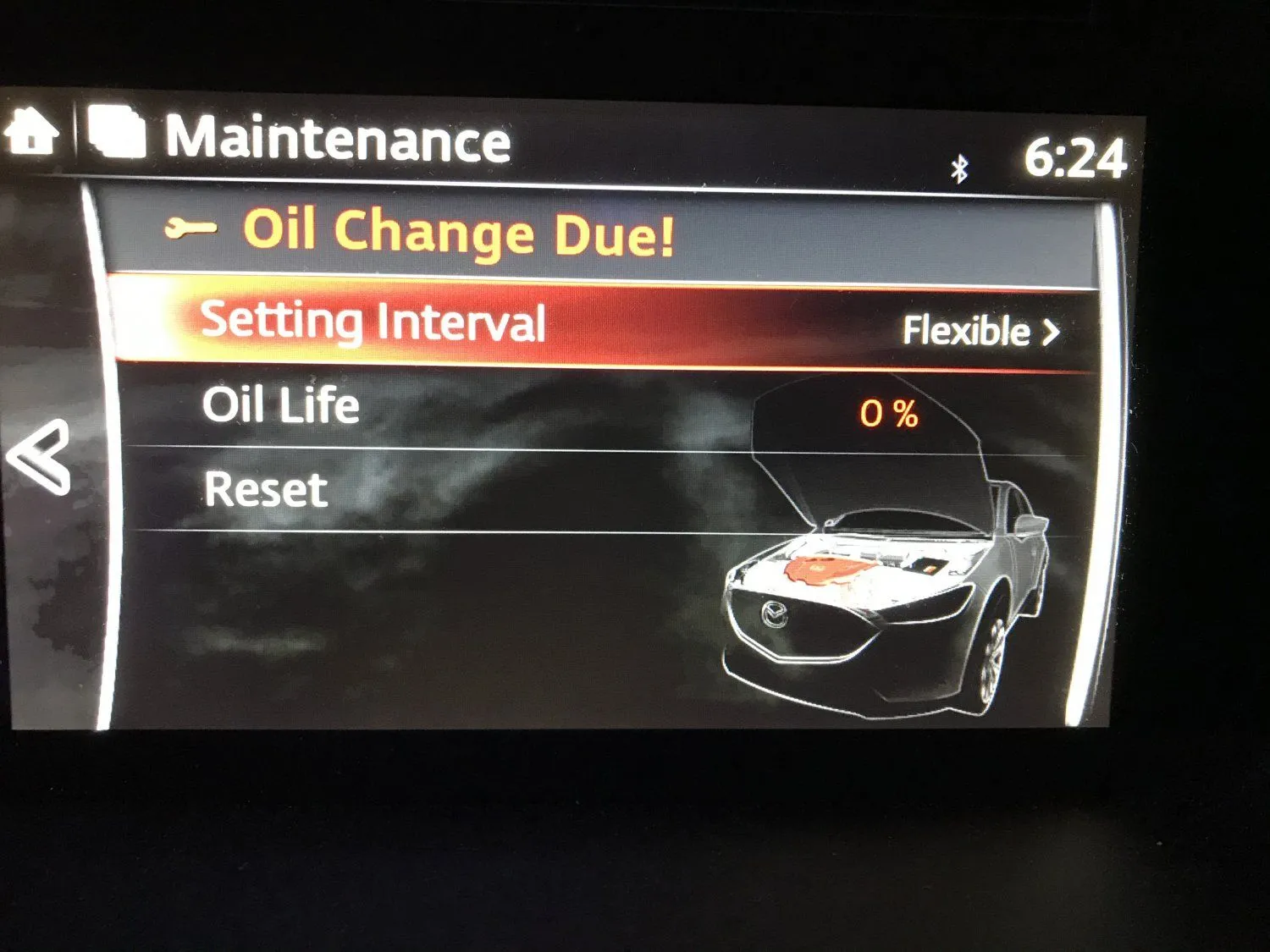

Here’s Flexible oil change schedule on my 2016 CX-5 showing 0% oil life remaining due to 12 months time interval with only 2,728 actual miles driven:

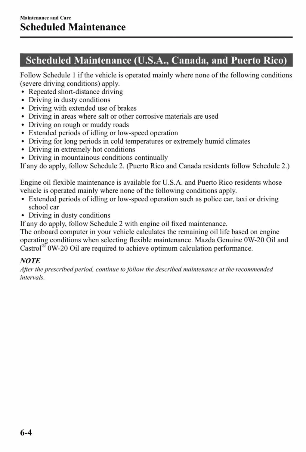

Here are paragraphs regarding Flexible maintenance in 2016 and 2018 Mazda CX-5 owner’s manuals. Only 2016’s has mentioned using Mazda genuine oil but only to achieve optimum calculation performance.
2016:
“The onboard computer in your vehicle calculates the remaining oil life based on engine operating conditions when selecting flexible maintenance. Mazda Genuine 0W-20 Oil and Castrol® 0W-20 Oil are required to achieve optimum calculation performance.”
2018:
“The vehicle calculates the remaining oil life based on engine operating conditions. The vehicle lets you know when an oil change is due by illuminating the wrench indicator light in the instrument cluster. Change the oil as soon as possible within the next 1000 km (600 mile) or 15 days. Refer page 6-10 for the details.”
And I’m using Mazda genuine 0W-20 moly oil and Flexible oil change schedule, and I’m in the US. ;)

Thanks for posting the section. I just changed my oil 3 weeks ago. When I set the oil change to "Flexible" it gave me the notice about using Genuine Mazda Oil or somesuch in the infotainment at the setting. I just set it to fixed 7500. There isn't much point to the flexible if it won't go beyond the 7500, I don't think it would ever go under with my driving either. I've turned off the other notifications.
