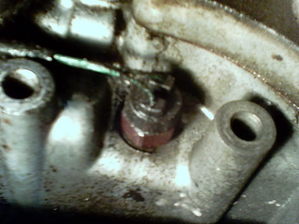

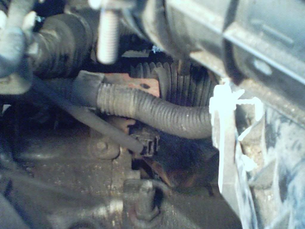

I did run completely new wires but only to the connector at the sensor since it was brand new but... never know... Getting under the car today to rerun wire all the way. Already replaced the clutch switch too with a new one... I know it has its own fault code but figured might as well.
Bypassed all connectors... ran perfect around the block then two hours later its not starting and not throwing a cel wtf??
K so after bypassing all connections and still having the same issues... the last thing to check was also the first thing that was done... putting in a new neutral safety switch. Switch was damaged due to the tip of the threaded part of the sensor was apparently protruding too far tip got boogered up and the plunger wouldn't come all the way out...maybe was supposed to have a washer?? Any way I had an old one with broken wires that I re-soldered and stuck in there but it was still obstructing me from sliding into gear... cut out a washer and all is good now. Tranny rebuild coming soon but I'm hoping something is not off with my shift linkage that caused this?
