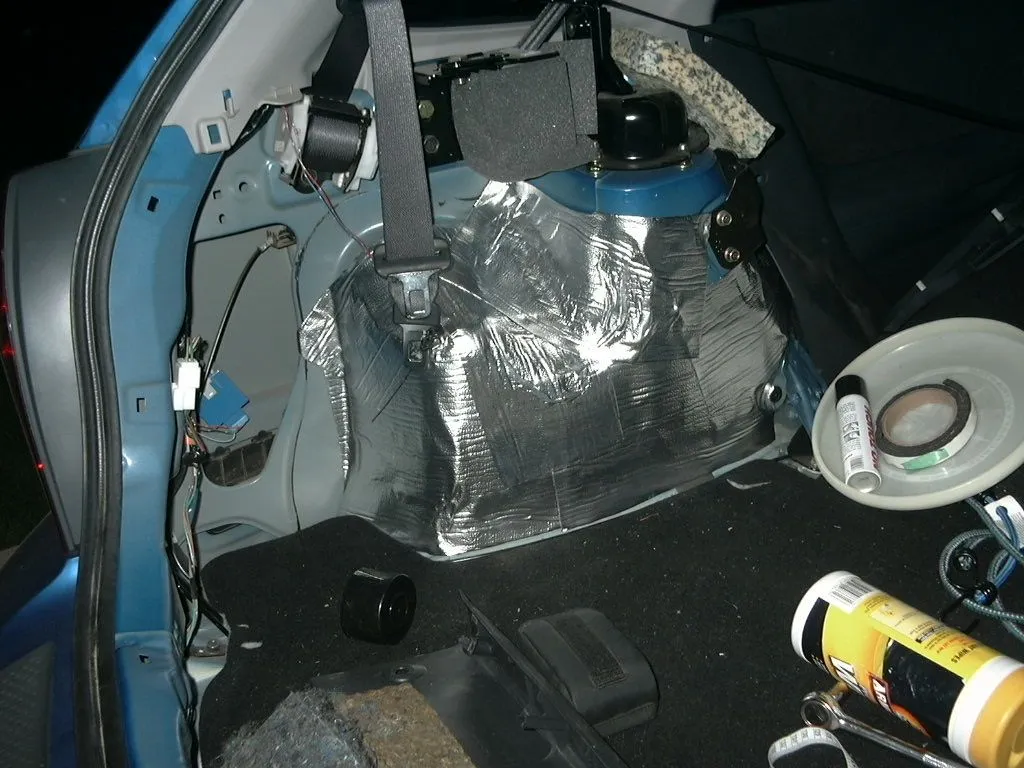

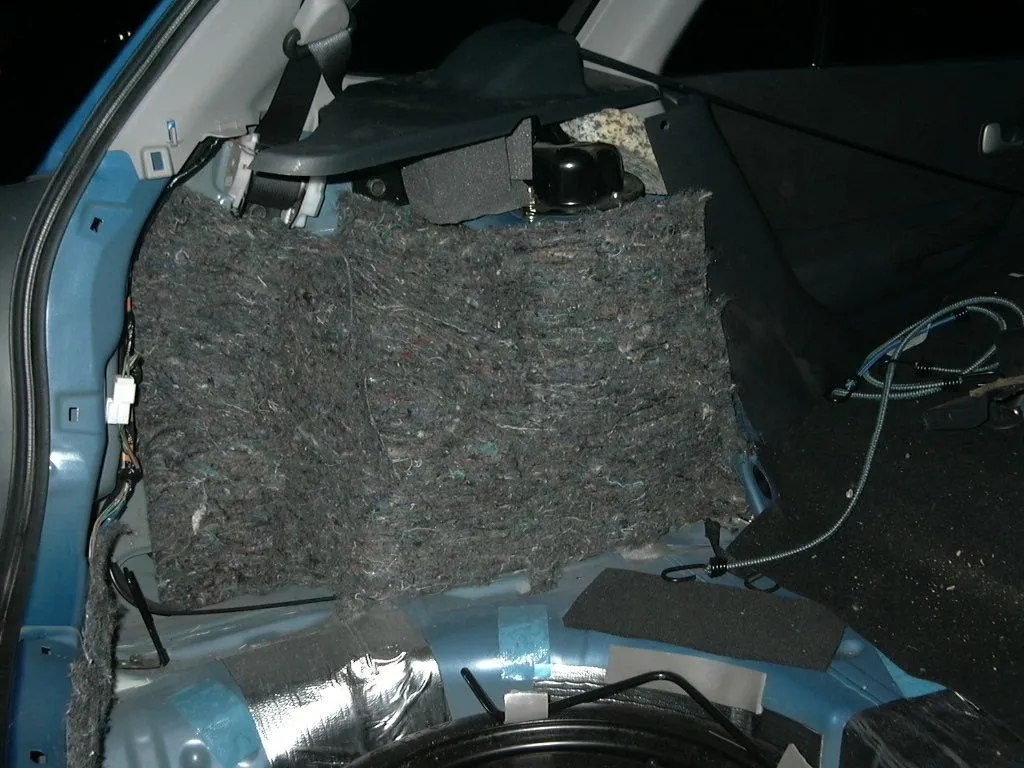

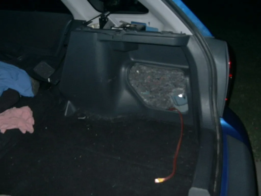

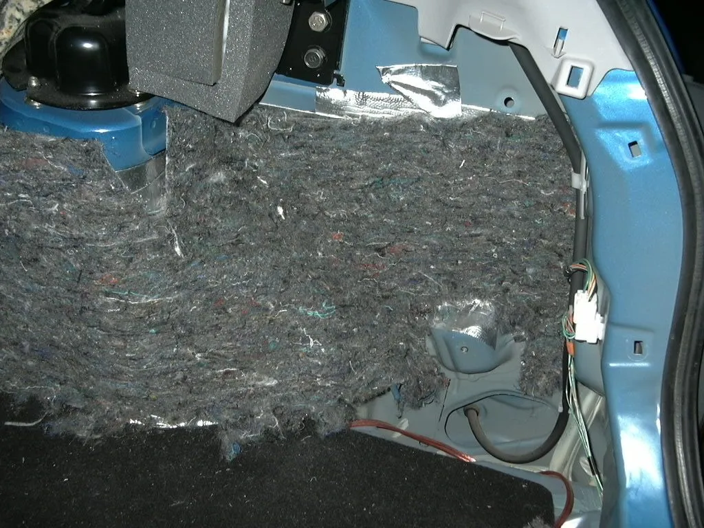

Here's a couple pics I grabbed while lining my rear wheelwells. Notsure if it helps anyone, but I just realized I never posted any of this stuff.

that looks good -- still hard to believe that something that thin can make such a difference -- im thinking of doing mine ----- but im lazy and dont want to strip the car again **pain in the azz -- lol

See thing is I can't say if it's the padding or the mat 'cause I did both at once, I'd imagine they both contribute in their own way. And for wheelwells I wouldn't rule out vibration and resonance as the main problem. I'd have added 2 layers of it, but my panels barely fit back in place with just the one, infact it took a couple days for it to "compress" the padding enough to where the floor fit back in right. Also that stuff that I've got in the back is thinner than normal, I'd say about 3/4 the thickness of most stuff I've seen. I'm not exactly sure what the deal there is, but that's what they had.

Just wondering after reading this, approximately how thick is the carpet padding? Also, in the link I thought there was mention of putting down 2 layers of the carpet padding. Is that correct? I really want to do the whole car to get rid of that tinny sound when you close the doors and quiet everything down to hear the stereo better.

tinny sound closing the doors, etc has alot mroe to do with panels vibrating, which would be better cured with dynamat-type stuff. I did 2 layers of it under my carpet upfront. which dramatically reduced in-cabin roadnoise. thickness It's pretty standard for most carpet padding I'd say about 1/2-3/4" range. someone stated it somewhere I can't recall where, though. But again, the padding filters out sound. Mat-type deadener reduces vibration, Actually, my doorsills are still off since i'm doing my kicks, IF I've got time soon, I'll go pull up the corner of my carpet and get a pic of what my floor looks like.
