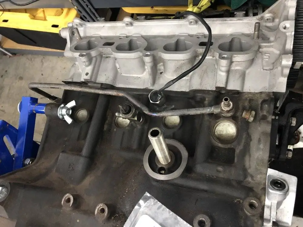

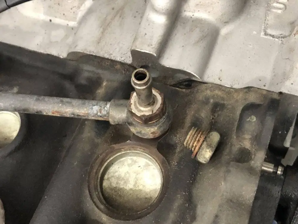

It just so happens I'm swapping those components to another engine now for my turbo p5. Here's a reference picture, didn't mount the oil cooler yet but you get the idea. The bolt for the coolant line going into the oil cooler is 17mm (second pic).
I'd also recommend thread sealant when swapping the oil feed line T and coolant line barb. It's the white Teflon stuff but not Teflon tape, use the liquid stuffs
