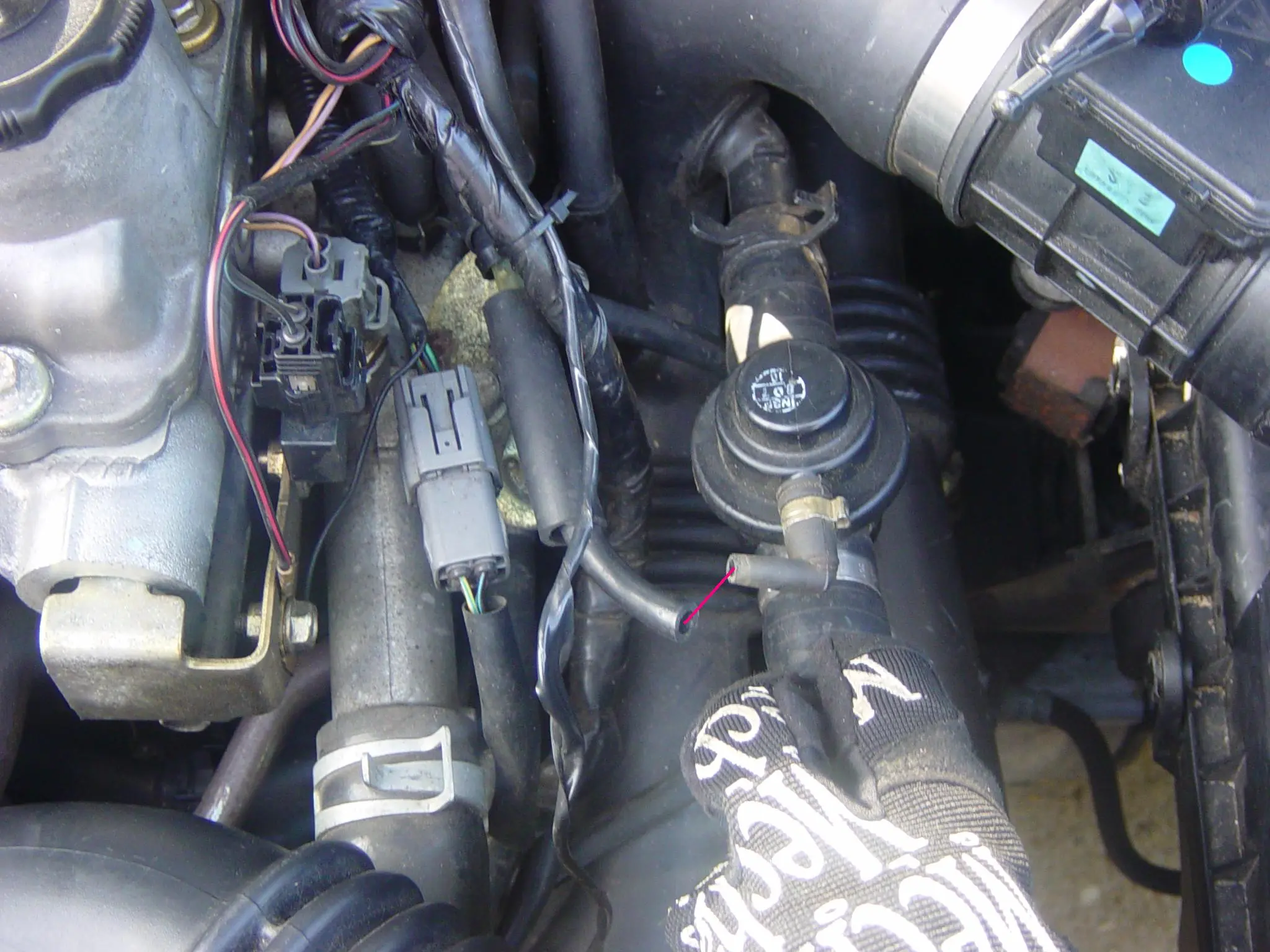

1st:How bad is that?Any pics of what it use to look like?

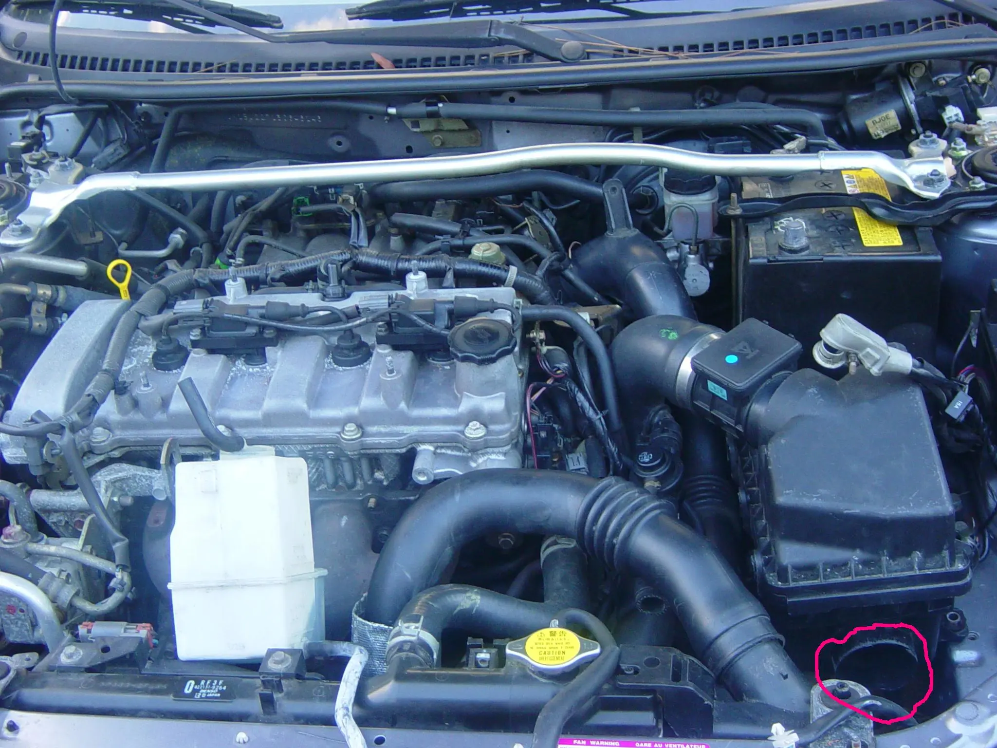

2nd: Does this hose connect to this one?

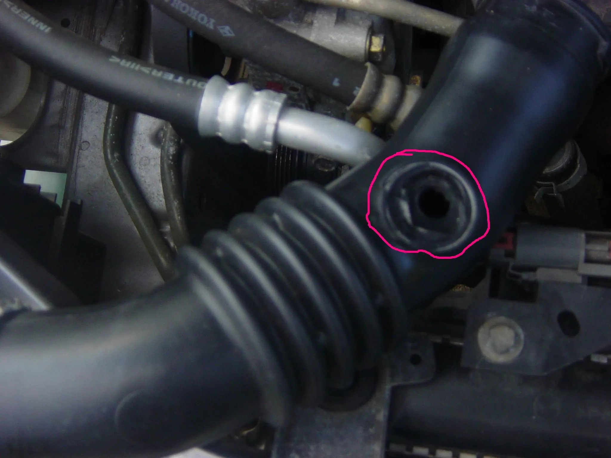

3rd:What goes here?

1st picture: you're missing a nipple! looks like yours is broken off somehow. you can use some super glue or epoxy and glue it back on if you have it. that is the return for the bpv.
2nd picture: yes, i believe that is the vacuum line for the bpv.
3rd picture: there should be an elbow that goes there. don't worry if it's not there, people have lost it before, with no adverse affects.
1: yes bad, boost leak. hole in pipe.
2: yes goes there, that host should go to wastegate and bypass valve, then to intake mani
3: callaway elbow.
