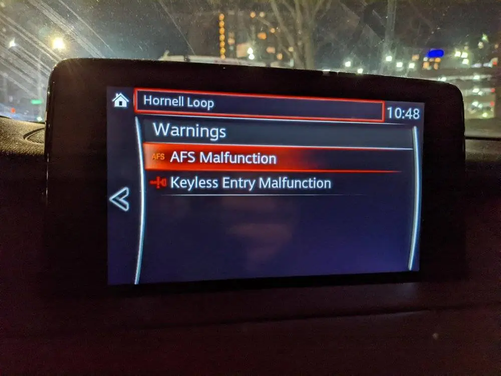

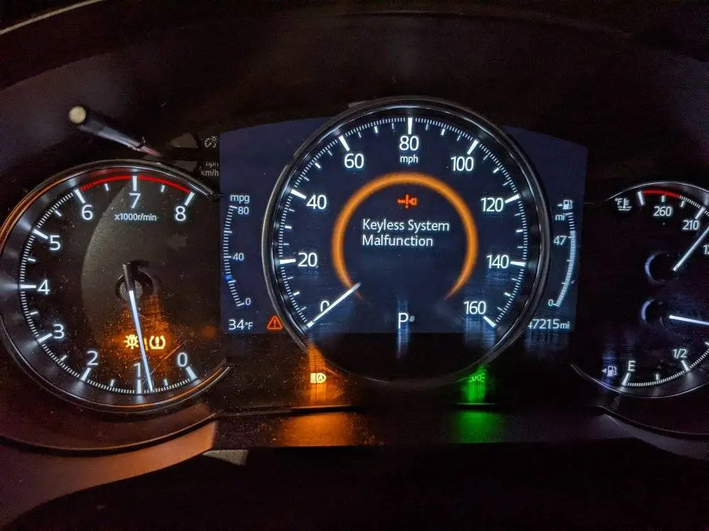

Just an update. I reconnected the negative terminal after 4 hours and no luck. Car still won't respond to keyfob so I had to lock/unlock with the physical key. Got in the car after the dash screen showed it reboot few times and showed the same Keyless System Malfunction as I step on the brake or press the ignition button.
I was able to start the car and drove it quite a bit. Like an hour mostly highway about 15-20 miles or so. EVAP monitor still not ready. Attached couple photos of the dash with the lights and the infotainment message.
So far everything is working except anything that has to do with the keyfob or remote. Headlight works but no longer adaptive. TPMS light is on but all tire pressure is normal around 36psi.
Since the car is still technically drivable I guess it's not the end of the world yet. With the soonest dealership appointment being 2 weeks out I'm going to try few more things in the mean time. Please let me know if you have any idea.
