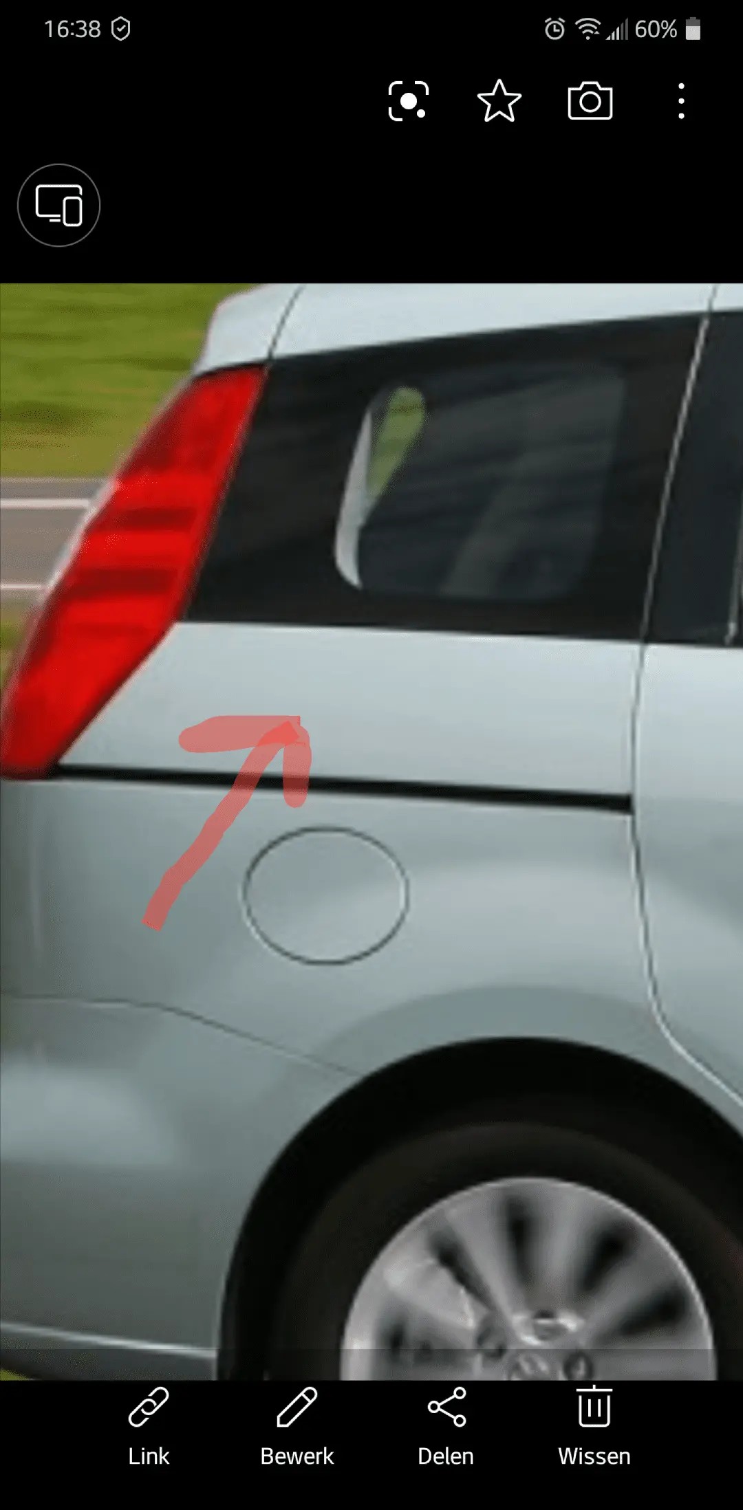

R Rjw Apr 7, 2020 #1 Hi everybody, just joined! From Holland, after driving mazda6 now driving a mazda5. Can anybody tell me how to take this part off? Mazda5 (2005). Thank you. Greetings Rob Attachments Capture+_2020-03-26-16-39-38.webp 64.4 KB · Views: 270

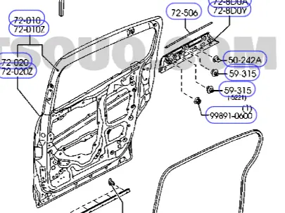

N negusm : 2010 Mazda 5 Sport Apr 7, 2020 #2 I don't know...but I did look up the body panels exploded view on PARTSOUQ and it does look like a removeable panel. There looks to be 4 nuts that hold it on from inside the car. You will need to disassemble the interior to get at it.
R Rjw Apr 8, 2020 #6 Somebody damaged it with a bike (without leaving a note off course).I found a demolition car where I can take this part off already in the same colour.
C CX_FIVER Apr 8, 2020 #7 Make certain you check if there is an adhesive which keeps water from entering. Have no info but just something to watch. Good luck.
