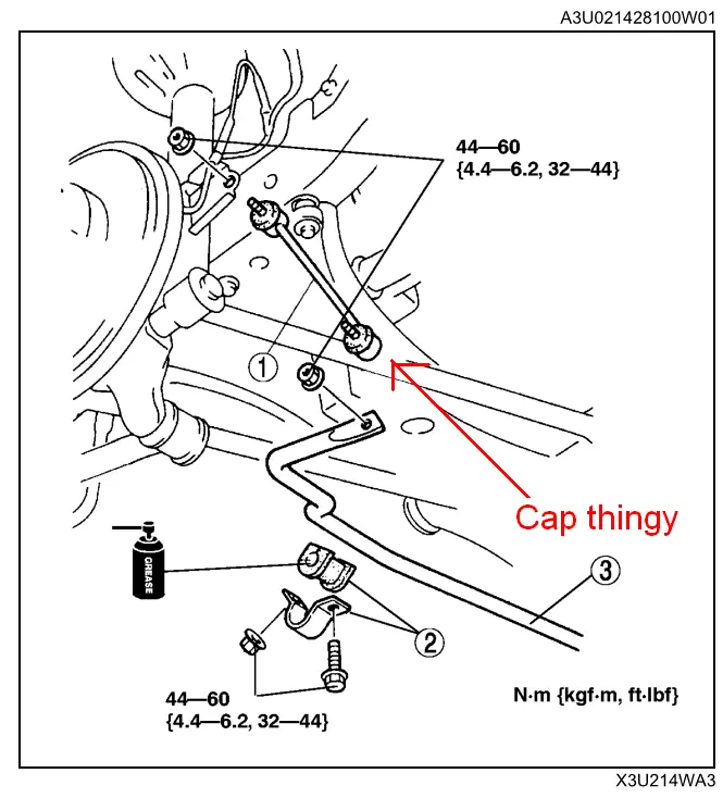

I meant I destroyed the endlink by hammering the link part off of the bolt part. See attached picture. Pry, hammer, or cut the cap thingy off to reveal the ball inside. Vice grip the ball and turn the nut.
The bolt also has a allen (hex) key hole in it. You're supposed to hold the bolt in place with an allen key and turn the nut with a wrench. But that stupid design = easily stripped allen key hole. May be worth a try before you completely destroy the endlink.

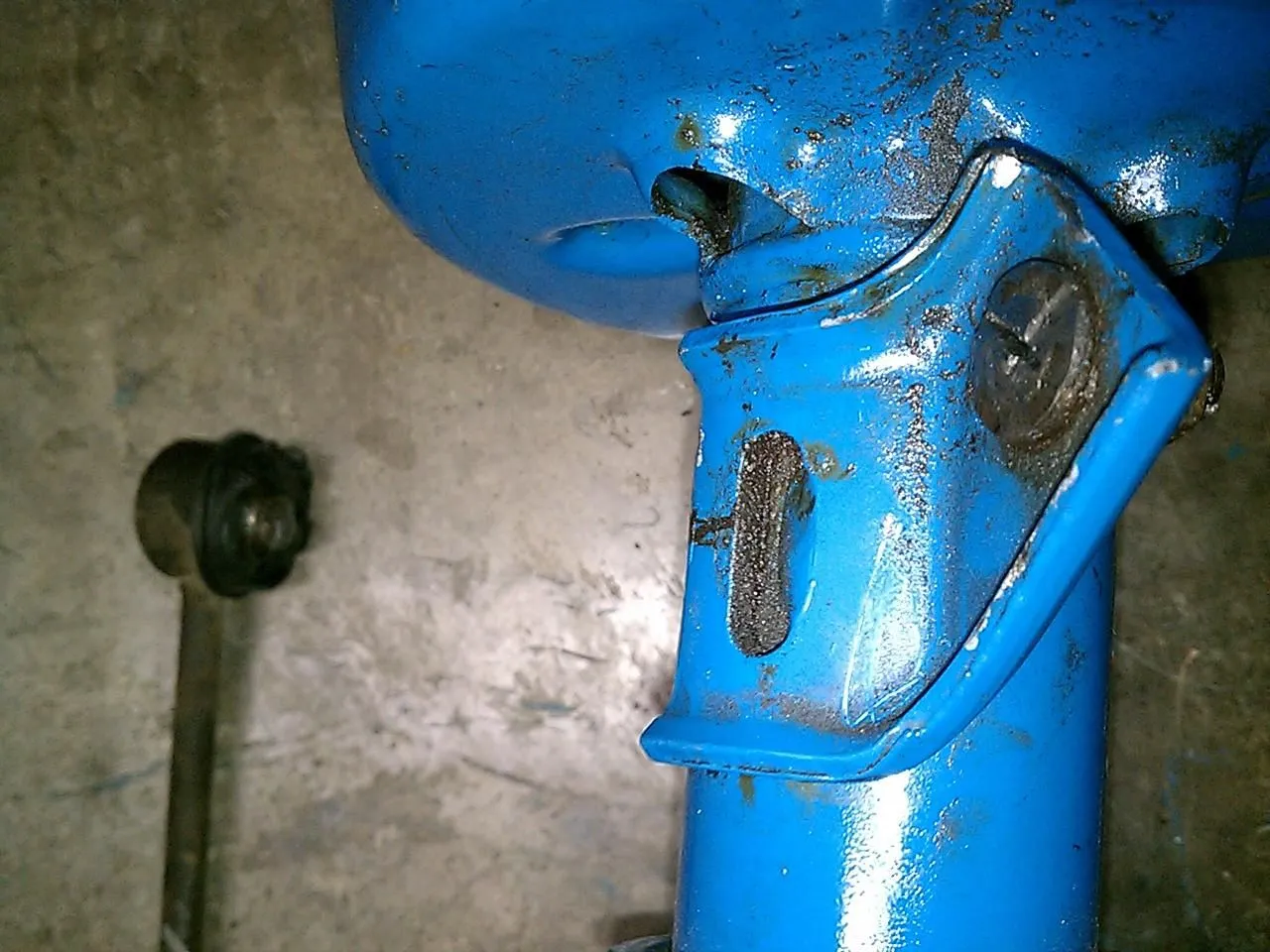

I was having the same problem so I cut the endlink with a dremel which I thought would free it from the strut. I guess I cut it in the wrong spot or something because it's still stuck.
When I turn the nut everything turns with it. I tried hammering the nut out and nothing happens. I tried dremeling a slot in the bolt for a screwdriver but that didn't help either.
Any advise?
Any advise?
Maybe try drilling it out? Or else try cutting it off from the other side (get your dremel right up next to the tab surface).
