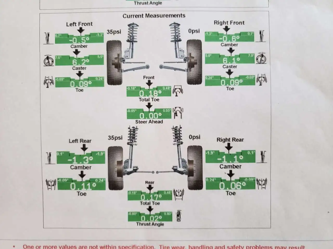

I just picked up my 2023 CX5 Turbo and I am having a very similar experience as described by @faust222
We have less than 750 miles and it's been around 2 months since we got our 2023 CX5 Turbo and on first day driving it home, it felt different, but we were too excited to notice anything strange. It's primarily my wife's car so I didn't drive enough to notice anything. As I drove it more and more recently it feels like it's not planted on the road. I know some mentioned wind, it's exactly what it feels like, but then I think it can't be this bad. I have been driving BMW X5 and Q7, in fact I went from a top-heavy car like 2004 Jeep Liberty to 2012 X5 and these are all pretty tall vehicles. My most recent X5 has air suspension, so I thought maybe I am too used to the X5, where I almost never felt the motion that I am experiencing in CX5. Then, we bought another Mazda, CX30. I really appreciate it's agility and compactness, and it has nothing like what CX5 is experiencing, maybe because it's a shorter vehicle.
So, we took it back to dealer, they said alignment was slightly off (toe?) and initially during test drive tech also thought it might be alignment. We just picked it up, and it's still there. Driving down the highway around 65-70, or local 35-45mph you can feel it. Not as much locally but it's there. It's also more apparent when you let it coast. It's not "pulling" to one side, but pulling to left, then right then sometimes it feels like front and rear are not following the same line. I am sure I sound like an insane person but I would never expect a drive feel from a $38k vehicle, especially one that's been praised as "fun" and "great handling" zoom zoom vehicle.
PS: I don't know why OP went dark and never commented if he/she gotten the alignment done or just gave up and got that loaded 3?
Your wasting your time at the dealer. They will just put it in the green. Thats all they HAVE to do. Pay the $125 to a GOOD alingment shop. Been thru this with ford and mazda. You want thrust angle at zero, front total toe should be +0.20 ish. Did they provide you with a print out to show how crappy of an alingment they did? Details matter when it comes to drivability. Unfortunately now a days all we get are lazy and stupid. Average is the exception anymore. Post your printout if you have it.

No way anything is worn out. My guess is a sloppy alingment which at this point they won't admit because they say its good. Ask them for the print out showing "actual" specs. Warranty wont cover fine tuning within the "green" window and thats what needs to happen. I was told by both ford and mazda they wont get paid for that, only landing it in the green

I don't think dealer checked tire or anything else, other than maybe putting it on the machine. My dashcam shows car sitting in shop for 2+ hours other than 5 minutes of test drive (before) and driving into the alignment machine (eagle eye? hawk eye?) then it cuts off, maybe they disconnected the dashcam.
This makes me wonder actually. At first they were really pushing me not to get anything done, claiming road crown, claiming lane marker, etc.. I hate hearing this because I told them I've been driving more than half my life 25+ years (without a condescending tone). I know what road crown is. I told it's very apparent at 60-65 and when you are just coasting on a straight road. It's present on slower speeds too but you can sense it better at that speed. His response "my tech can't break the law and go over the speed limit, you shouldn't drive that fast if it's giving you problems".. I held myself back and remained polite and reminded him this is not the only city in the world where I drive this car. It was really a frustrating experience.
I think agree, and not little time either, 3 hours + driving to and from 40 minutes of our day. It's very frustrating, and i had to convince them to check. He did a test drive, said yeah he felt it moves a little to side, but "nothing major" so while we are there they will just check alignment... I said OK..
Sadly, no printout. I will give them a call see if they can give me this. I have copy of the work order that says "toe adjusted" along with bunch of other technical words. You are right i should have gotten a report, in fact my other car they print this when I first drive into the shop (some fancy sensors pick up the tilt and tire wear).. They wasted 3 hours so they could claim to warranty.

1. Tires to 33 psi. 36-39 is too much
2. Get an alingment and show them my printout.
