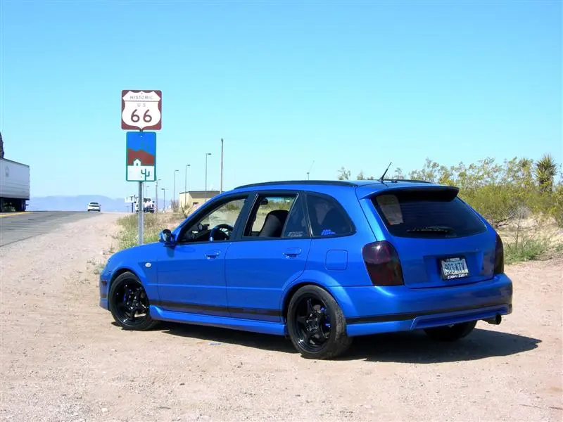

im running dunlop direzzas in size 215/45ZR16 on my stockers for a month now and they are incredibly great :D
