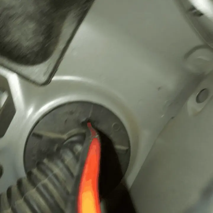

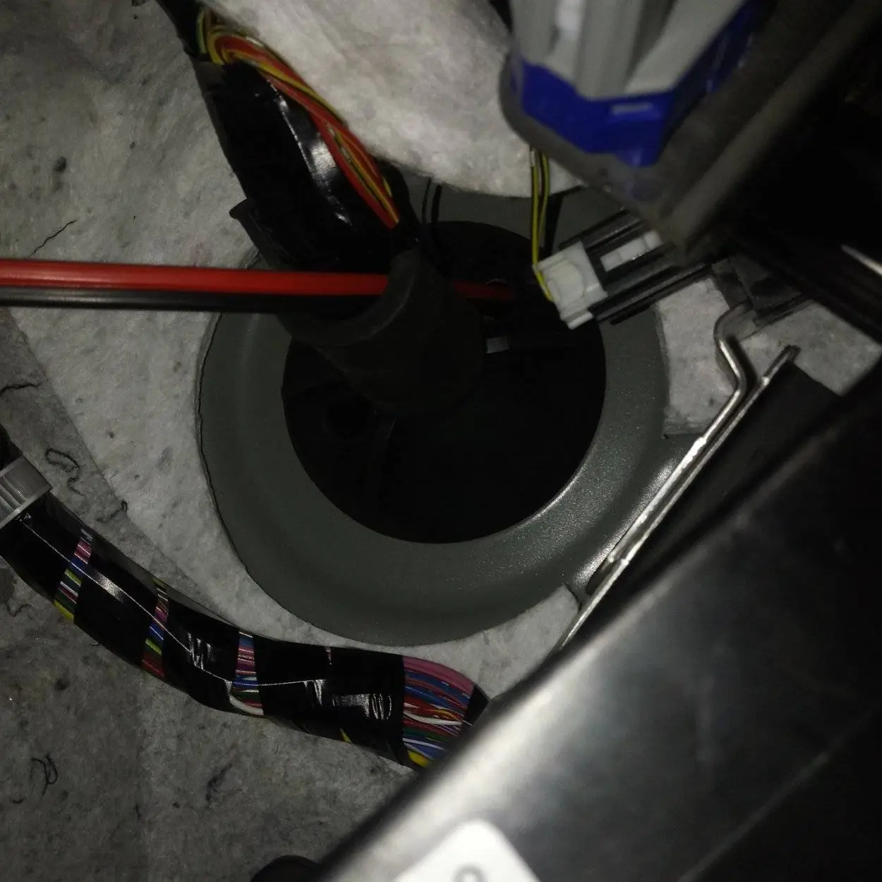

I removed the battery and ran a 16ga pair through the big gasket.
There is a molding ( nipple) protruding around the top side in the engine compartment. I clipped it off with some angle clippers.
I slit the tape holding the two halves of the rubber around the bundle on the inside, under the dash. Then I could see light from the engine compartment through the hole. I has to enlarge the opening, making an 'x' with an exacto knife.
Then I was able to pull the wires though using a stiff wire taped to the 16ga pair.
