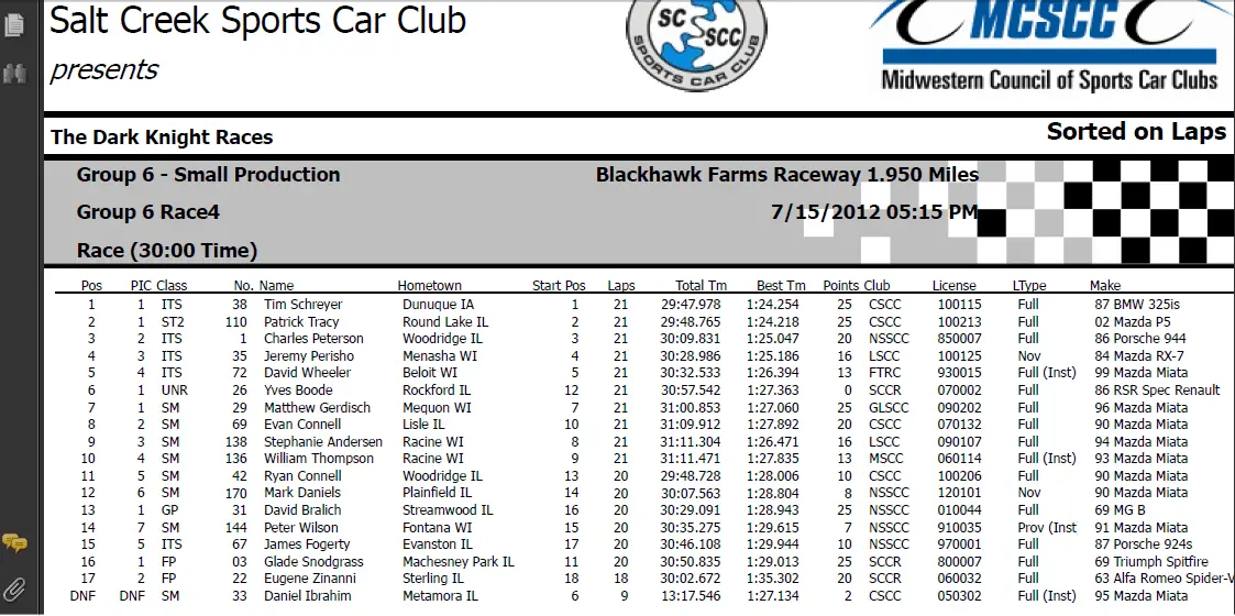

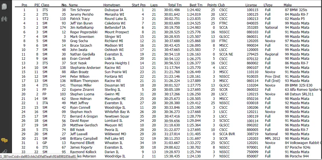

There are two of some races this year where I had the fastest laps. It should not take too much to stay out in front. I have no kids, this is my life. I cant FI, or KL swap. If I do I am put in a class with GT1 cars. THEN I will never have a chance.

Ahh OK then I will proceed to install the 10.4:1 pistons. Would it be wise to run a J&S, or stick to running what 100 or E85? Remember this is a track car only so MPG or overall gas cost is not a problem.
