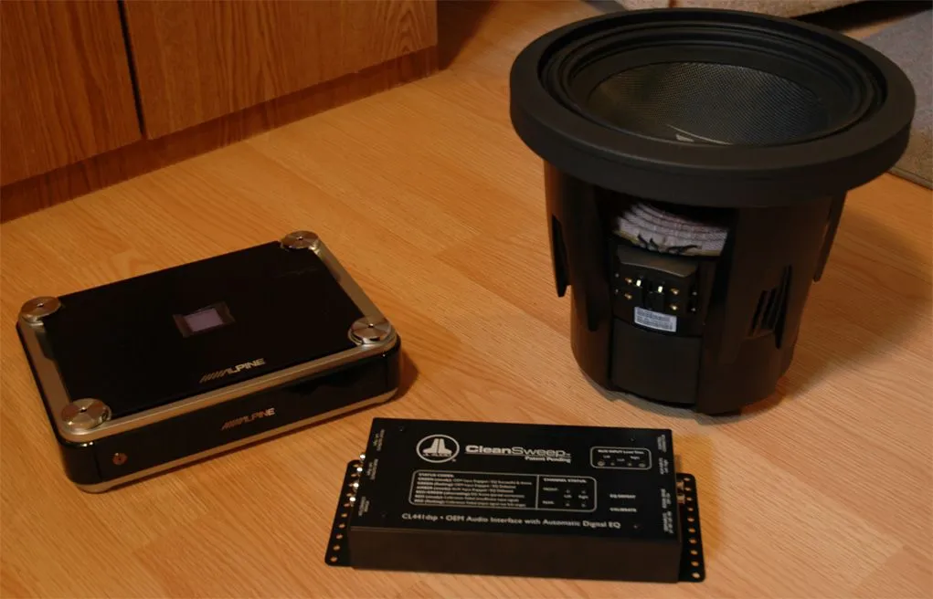

My new baby :)
Abaddon
2007 Mazdaspeed 3

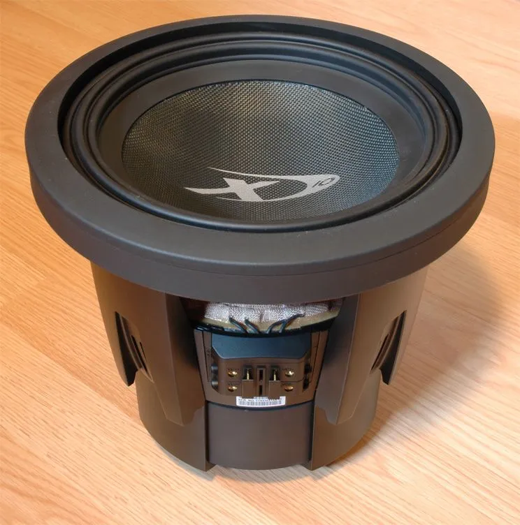

My new sub arrived today :)

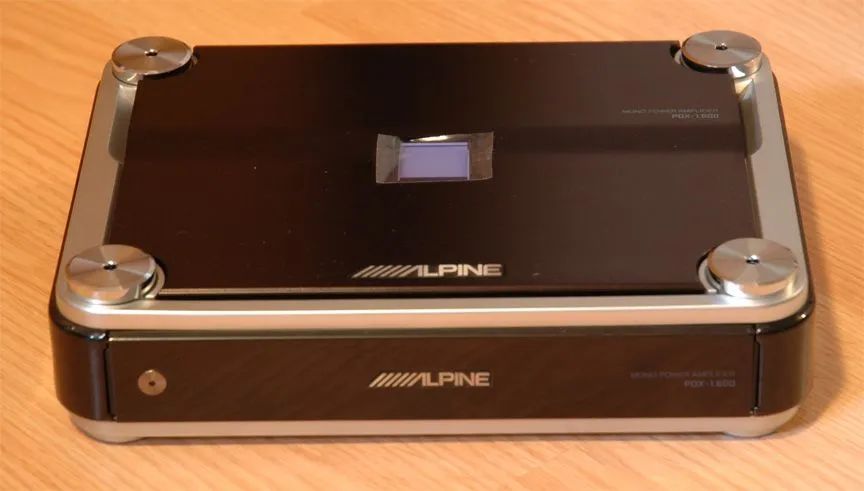

Alpine Type-X 10"
This thing looks awesome, IMHO. I cant wait to get it installed; but that wont happen for a while.

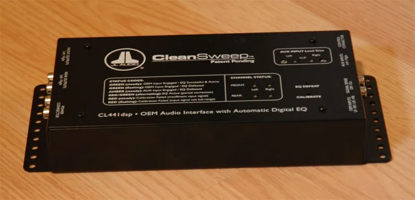

Also pictured is the Alpine PDX 1.600 Amp that will be driving the woofer, and the JL-Audio cleansweep signal processor that will be providing a nice clean signal for the amp.
Ive never really heard about the JL-Audio cleansweep, Can you give me some info about it? You going aftermarket HU or staying stock?
Stock Head-Unit; Thats what the Cleansweep is for.
In a nutshell, it is a line out converter on crack. It hooks into the speaker level outputs from the head unit (although, I have heard it is possible to tap into pre-amp level signals with the BOSE system) and then with a special calibration CD, equalizes the signal across the frequency response to get the system back to a flat curve (since our cars use MASSIVE roll offs below 150hz). Then, the clean signal gets fed via RCA's to your amp(s).
Another similar product is the Rockford Fosgate 3Sixty (versions .1 and .2). Although, if you have a bluetooth enabled palm device, the 3sixty offers more since you can manually set the equalizer to your own preferences so that you don't need an external EQ. I went with the cleansweep because I don't have access to a bluetooth enabled palm device, and I don't want to have to buy one.
Thanks for the info. Im guessing you think its worth the price? Where were you thinking about mounting it?
I'm not 100% sure yet...
If I have to tap off the lines behind the head-unit, then its going in the glovebox.
If I can tap off the lines off the amp under the drivers seat, then it is going there.
EDIT: In our cars, it is deffinitly worth the price. There is a major ammount of factory equilization to optimize the stock system. If you just add in a LOC you will be feeding this modified signal to your aftermarket amp and speakers, and you wont get the true benefit of speakers with a high dynamic range. Truly, all you would accomplish is making the stock system sound louder...

What I am planing on doing, is mounting the 1.600 amp directly to the sub box, and placing the 2.150 under the passenger seat. Then I will ground them both at the same location under the REAR seat.
Why mount them in two different locations? Arguably the front speakers and amp that I have chosen should produce quite the pleasant listening experience on their own. So I have chosen a place for the amp that most would consider permanent.
On the other hand, the sub box (sealed 0.74 ft^3 = Tiny) I may need to take out of the car from time to time. All I will need to do is remove the power and ground cables from the amp, and pull out the box (should take about 10 minutes or less) and then I'll have full hatch space when I need it.

Got the processor, Sub, and mono amp installed.
If I were to die today, I would die a very happy man.
I mounted an amplifier under the passenger seat, the vent down there proved to be no issue. I cut back some of the carpet and pushed it down into a groove in the floorboard. When you get the seat out, you'll see what I mean.
