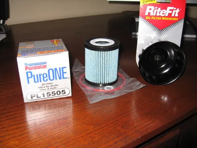

it's not only recommended by you, but required by mazda at the dealerships... there is a TSB released specfically stating you must use a cap type oil filter wrench to R&R the oil filter cover
02589 said:
I strongly suggest that everyone have one of those oil filter covers on standby as a spare part, whether they change their own oil or not. Obviously, no mechanic will tell you that he broke the thing, but I can envision them coming up to you and saying, "you're gonna need a new oil filter cover, this one has a crack in it." (or stripped threads, or a leak, or is broken) And even a Mazda dealer might not have one in stock when you need it.
is there an aftermarket filter you can buy, like K&N? or is it a special filter only from the dealership

Is there an aftermarket filter you can buy?
Ready for my oil change, First change today by Mazda at no charge 3,200 mi.
Next change by me @ 6,000 with switch to synthetic. Purolator lists the standard L15505 as well PureONE PL15505 which come with new cover o-ring and o-ring for the drain plug. As noted earlier you should have a cap wrench for the plastic canister cap. There seems to be a bit of confusion if the size is a 74 or 76mm. I will try the 74mm size this weekend to make sure I bought the right one.
