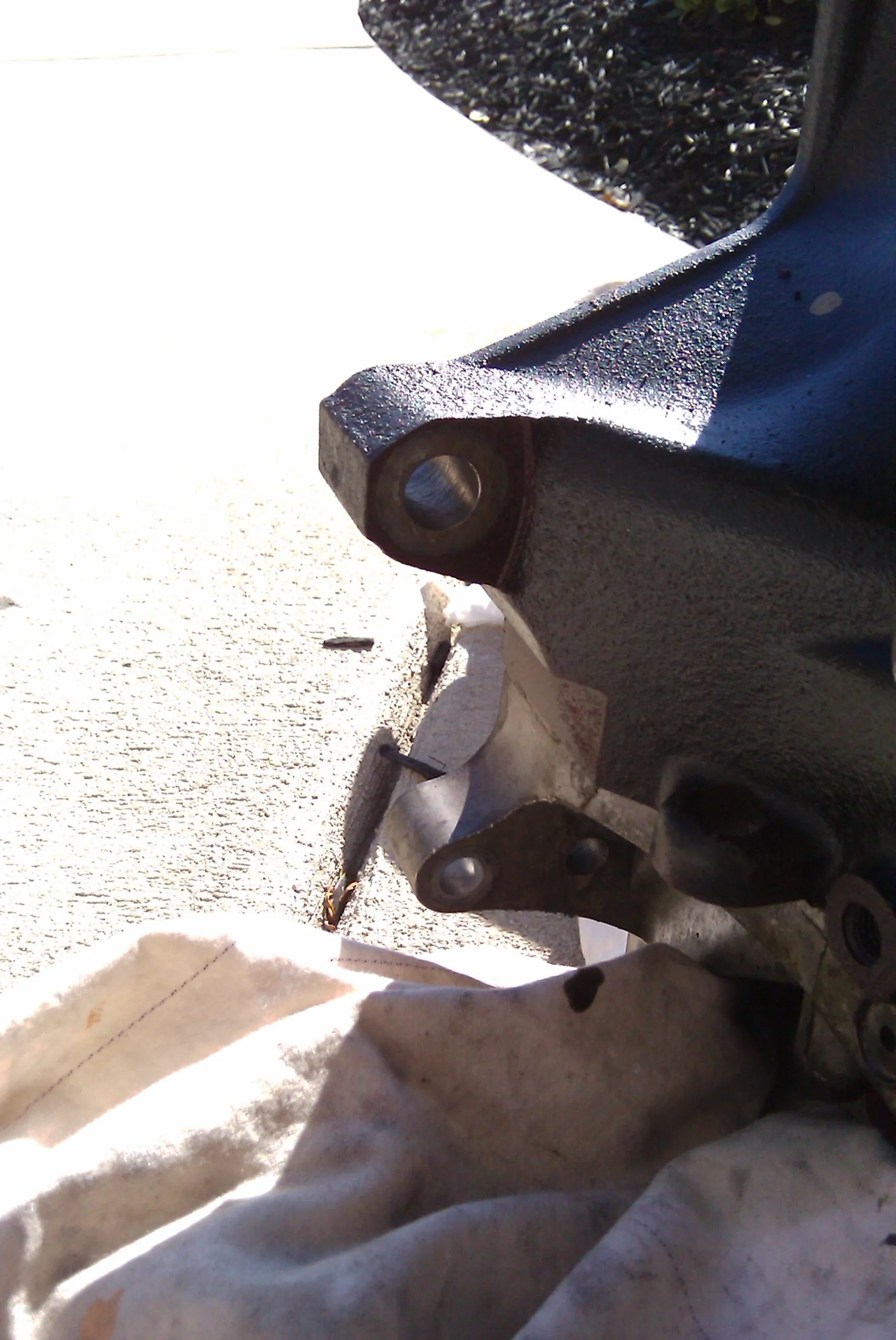

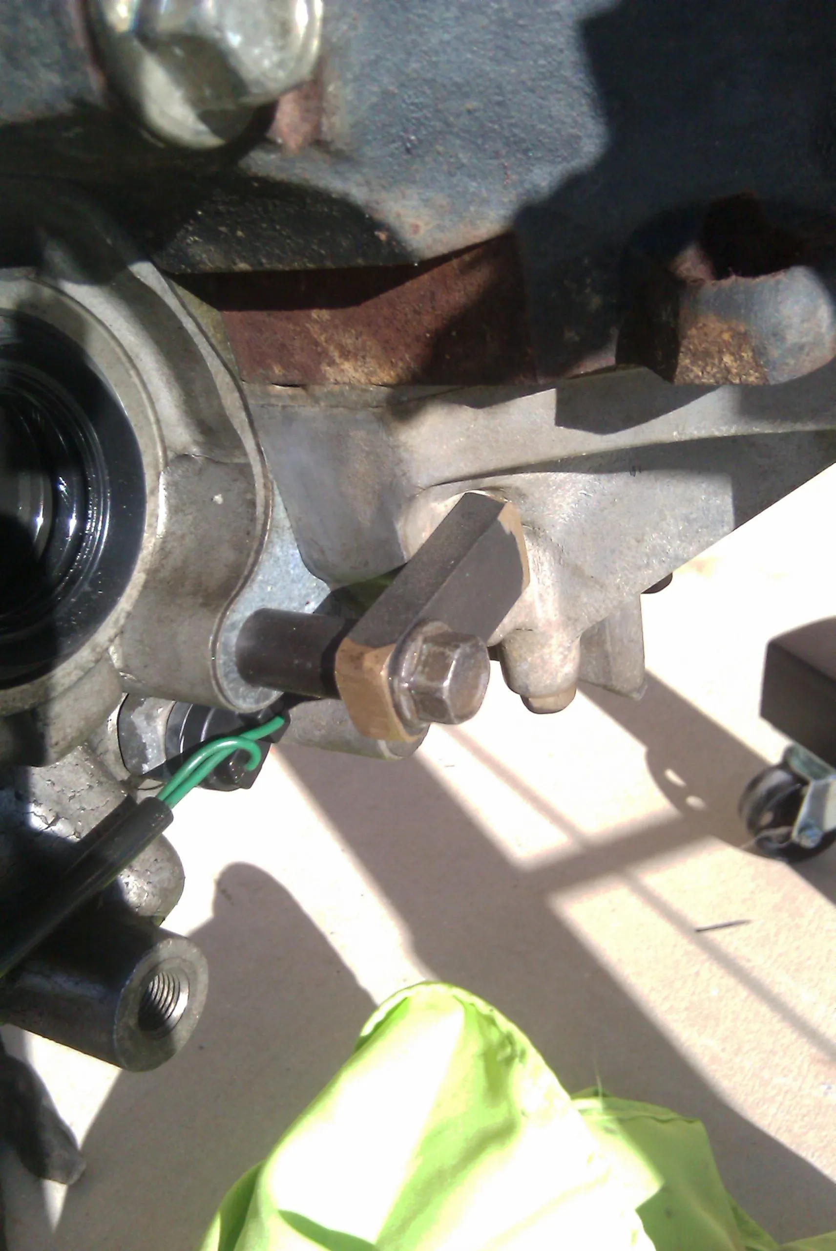

there IS a difference between an auto main bearing support and a manual support, did not know that. it's small and i made a bracket just in case. as you can see in the pics the manual support has an extra hole to line up with the threads on the tranny, where the auto support does not. and the bracket i made out of a steel spacer and an aluminum bar my dad had laying around. the bolt is only a 14mm but i figured it's better than not having it in there.
