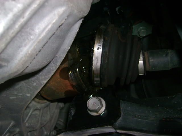

My ENGINE FELL OUT!!! Im NOT JOKING, This #UCKIN SUCKS!!!!!
For the record i didn't have any mods done to my car when my motor mount failed, BUt even i did the dealer wouldn't void the warranty for a motor mount with the installation of a CAI, if they did they would have a field day with my lawyer.
As for these other comments. It doesn't amtter if you do Verify the trq of the bolt, It can still sheer. Why ?? because the sheering action created by the little bit of missing rubber acts like bolt cutters.
My bolt didn't back out AT ALL. It was just sheered off. No amount of threadlock or trq is going to stop this, unless you first prep the 2 mating surfaces properly and then bolt them together. Nd easy mod IMO would be to make the current mounting points a bit wider and enlist in the use of dowel/guide pins. this would stop the sheering action and let the bolt do the ONLY job it was intended to do. HOLD THE MOTOR UP!

Heres a pic from my dealer, I believe its my axle..... Nice :(
Had my mechanic had the BPV my car would have been finished in a day. IT lloks real bad, but truely its not. i broke an axle also, mech had it changed in 3 hours after putting the motor back in its place after about 2 hours.

I don't know, I still don't quite buy that. If they all were subject to shearing like you said, the number of broken mounts would be astronomical. I agree with you regarding the bolt-cutter comment but I completely disagree that it doesn't matter if the torque was checked or not. Even if the mating surfaces were prepared and there were no rubber issues, a loose bolt will still allow those surfaces to move under load.

i think you misunderstood me, and frankly i don;t understand what you are saying or where you came up with your conclusion. (help)
If rubber over casting is on the mating surfaces and you trq the bolt, it will later trq check fine as long as the rubber is still there, once its gone then there is slop.
Now most that verified their own bolt for having proper trq probably didn;t do it right. also theres a alot of weight on that bolt (holding up the motor) so that creates extra drag thus raising the assumed trq being applied.
the proper way to check the bolt , would be to support the engine and pull the bolt out, clean it, thread lock it and re-install. then trq the bolt to the necessary specs and forget about it. But if you were going to that far, you might as well pull the upper motor mount and verify the rubber is GONE and then reinstall the mount.
I guarentee you could have a loose bolt on a car and it will click off 80 ftlbs of trq on a wrench and still not be tight. WHy because unless you support the motor to decrease the drag on the bolt your not getting proper trq.
Look at ARP stuff. they clearly state that if you use there moly lube you only need to go to 80 ft lbs for certain head bolts (example) if you use 30W motor oil, have to go to 130ft lbs to have the same CLAMPING FORCE. why is that? Due to the drag on the nut/bolt/whatever. How many poeple here verified trq on their MS3 by first supporting the motor........... i know i didn't.
Oh and so people know do not remove your motor mount bolt with out first PROPERLY supporting the engine and not just the subframe UNDER the engine. also i'm not responsible if you try this at home.
in the end mazda needs to have a better design IMO. to have 4 mounting points on the back of the trans, and to to have 4 mounting point on the body and only use ONE bolt to support it, just don't make sense. (cheers)
Agreed that's why the bolt should be checked again in a month to see if it's loose. If it's not, it should be checked again a month later, if it's still tight, check it yet again in a couple months. If it holds, there's nothing to worry about and no need to remove it.
I supported the tranny when I checked mine since it made sense to relieve some pressure but the truth is, there's ZERO proof that the bolt will read the correct ft/lbs WITHOUT supporting the tranny, none , zilch. That's just a theory people are throwing around here and on the other forum. Yes I agree it will exert some force on the bolt but no one has proven what that force would be.
And btw NO ONE that I know of who has checked their bolt (with a torque wrench) has had a problem. Most of the incidences were people who never checked it or had their dealer check it (which is same as never getting it checked in the first place).

Best advice is let the dealer handle this. If they note any marks on a broken engine mount, they have cause to think it was a repair issue and no dealership/mechanic/service center will warranty another person's work.

For the record i did put a trq wrench on mine .I did not support the engine. i set it @ 70ft lbs and made sure it clicked, which it did. Why didn't i got for more, well i didn;t feel like breaking free the thread lock and having to pull the bolt to do proper installation again.
Also it is a known fact, if you ever spent time in an inductry that requires trq's, that drag trq and other factors have a huge roll in how trq is measured/applied. i worked on helo's for 9 years and it has always been said and complied with, that when trqing a bolt/nut, whatever, that it should not be in a bind or load unless it has to be by design.
Didn't you read my comment from ARP. 2 different lubes used, 2 different trqs just to reach the same clamping force.
