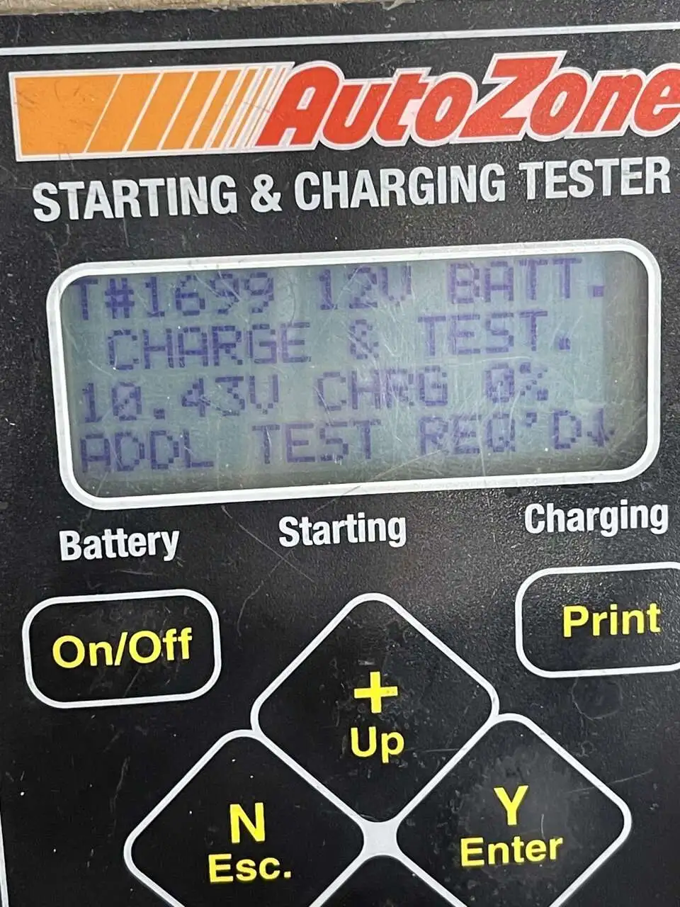

I went to AutoZone with the battery only. They checked the battery and according to them is dead. I asked to charge it anyway. After two hours charging, is not charging. This is the image showing that the battery is not charging at all View attachment 308564
6 cells in a 12V battery, each should be 2.1v in good state. That is 12.6v (=2.1x6).
Yours showed 10.43v. That could mean 1 cell is bad. Charging won't bring it back to good health. You need a new one.
Early failure indeed.
