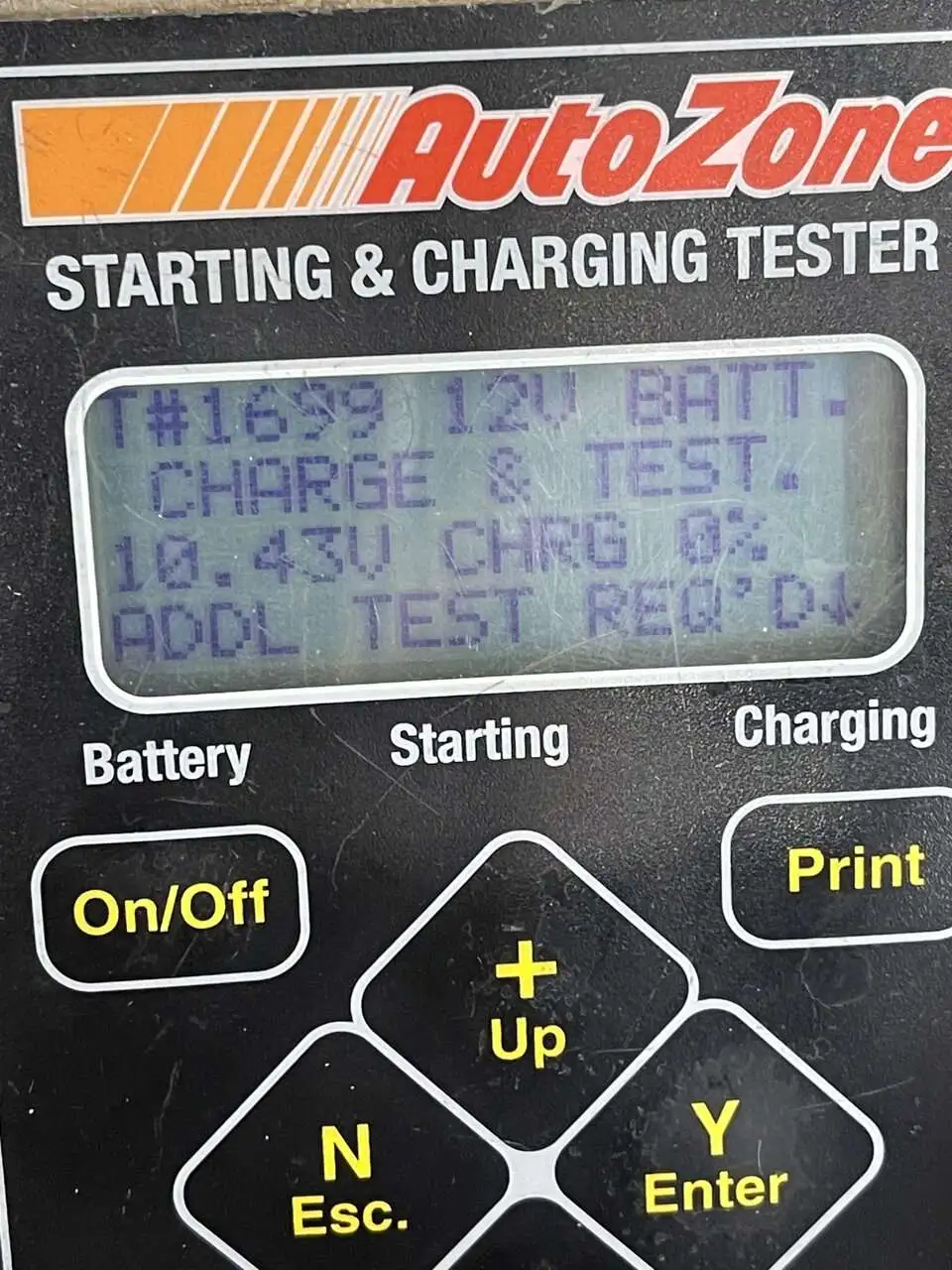

I went to AutoZone with the battery only. They checked the battery and according to them is dead. I asked to charge it anyway. After two hours charging, is not charging. This is the image showing that the battery is not charging at all
An "infant failure". Looks like you lost two cells. This early in the battery life, likely a mechanical failure of plate connections in the battery, which regular road vibration and high current draw during starting exacerbates.
