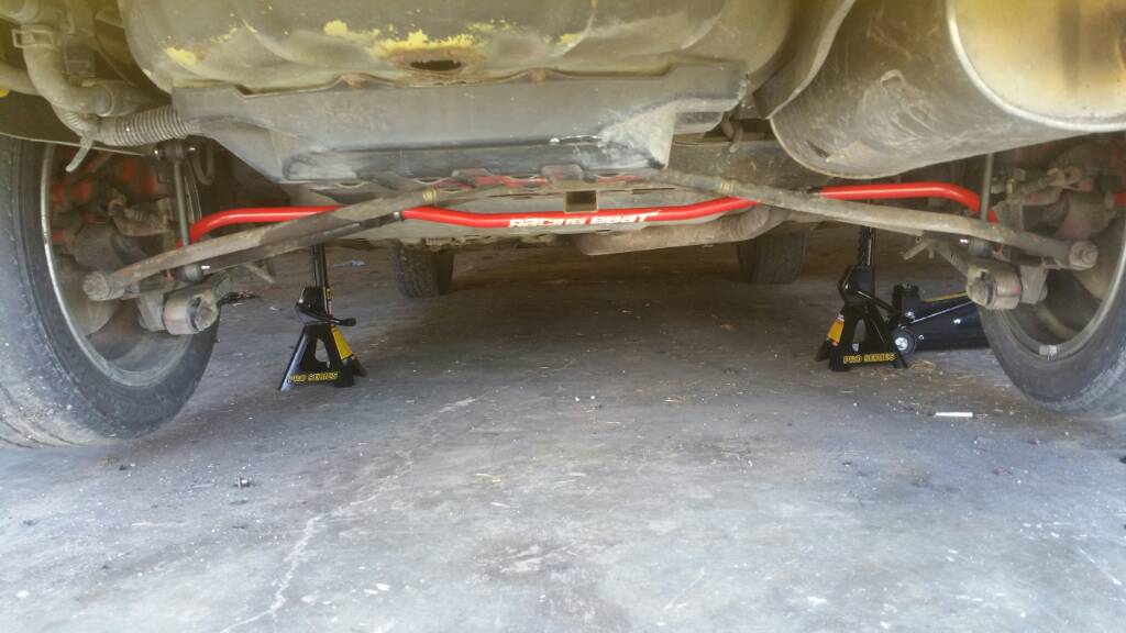

So, yea i think i need to wait till i get a impact and compressor to change out the sway bars. I cant get the bolts to budge on the horseshoe brackets.

Grinder with a cutoff wheel works best.. A saw can too easily cut into the sway bar.
Guess im going to get an angle grinder tomorrow lol....it seems like as soon as i get the old end links off, it shouldnt take me but 20 mins or so to put the sway bar on.

Ok so what causes the clunk? What is the clunk fix, and how can i aquire or make it? Also i tightened down my ebrake, and now it seems that my right rear squeeks after applying my brakes. Does that mean that its dragging?

The clunk fix moves the mounting points of the sway bar out farther towards the wheels. another thing to check - those zerk fittings on your endlinks. mine wouldnt fit with those fittings on. the top ones stuck out too far and hit the inside of the wheel well. i ended up putting some 90* fittings on and they fit but i still got occasional clunking on big bumps. i ended up having to massage the lip flat along the inside of the wheelwell across from the zerk fitting. note- i am running eibachs not sure if that makes any big difference though.
Does the sway bar rest on the lateral when the car is on the ground? If so, your sway bar links are too long.
